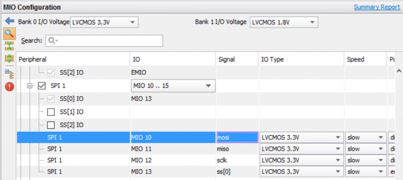

I've routed the MIO pins to SPI0: SS[0]-MIO13, MOSI-MIO10, MISO-MIO11,SCLK-MIO12.

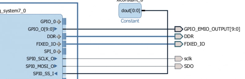

On the EMIO side, I've routed and constrained the following pins to the JB1 PMOD connector:
** SSI is tied to a constant block (of value 1) in Vivado as suggested in TRM **
SPI0_MOSI_O --> SDO
set_property PACKAGE_PIN Y8 [get_ports SDO]
Y8 is connected to BANK13_LVDS_8_N on the Picozed
SPI0_SCLK_O--> sclk
set_property PACKAGE_PIN W9 [get_ports sclk]
W9 is connected to BANK13_LVDS_9_N on the Picozed

B. The SPI on JPS1 has no signals coming out. I'm using an oscilloscope to trace the signals at the moment. There are no signals coming out of the Pin 2 and Pin 4 on the JPS1-PMOD connector. (ie..MOSI and SCLK pins).

    Yes. I routed SPI1 through the MIO pins 10-15. And SPI0 via EMIO. In Vivado MIO Configuration menu, it reads:
    SPI1 - MIO10 - mosi
    SPI1 - MIO11 - miso
    SPI1 - MIO12 - sclk
    SPI1 - MIO13 - ss[0]
    For the EMIO, I've applied the constraints as in my original post and routed 'SDO' and 'sclk' out just like Adam. SPI0_SS_I is tied to a constant '1' using the Constant IP. Running the same program Adam provided (ie _part82.c), my EMIO MOSI and SCLK pins have signal. And the output bits is correct using an oscilloscope to read the SDO and sclk pulses. But there's no output on the PSPMOD pins.

    SPI1 thoughts - Your MIO configuration seems to be set up correctly. Looking at https://forums.xilinx.com/t5/Xcell-Daily-Blog/Adam-Taylor-s-MicroZed-ish-Chronicles-Part-82-Simple/ba-p/620899 the first comment by kurtcopley at the bottom may help you get the SPI1 working.
