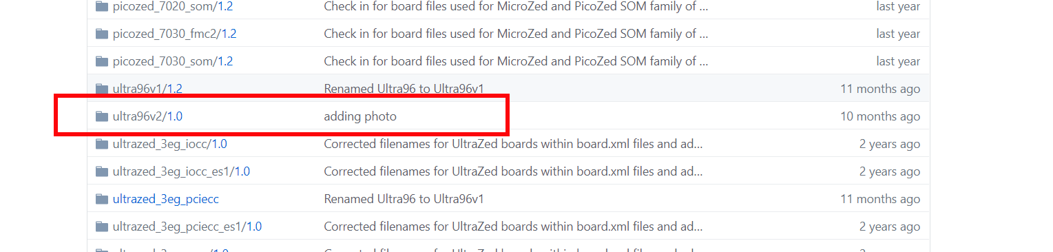

    Are those DDR configurations of the BDF for the V2 provided in github https://github.com/Avnet/bdf ?
    I used this configuration when I created my Vivado project, It contained the V2 BDF. I would assume they are the correct DDR configurations.

  • jafoste4
    jafoste4 over 7 years ago in reply to nico_n04
    Yes that is correct.
    -Josh
