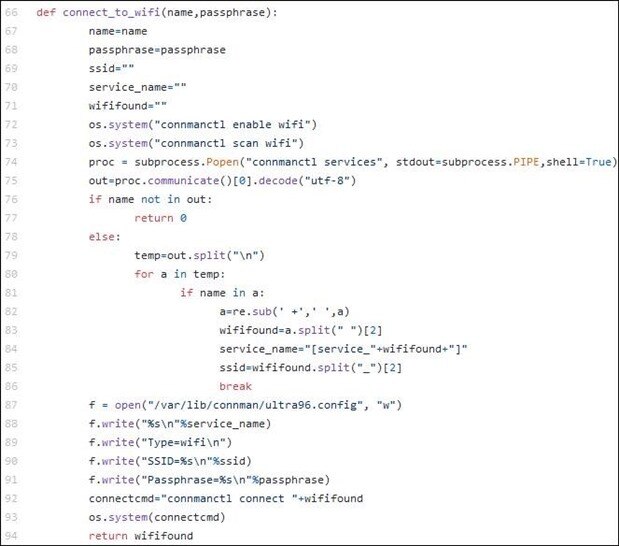

    I see the OP is dated back in October, 2019, and the PetaLinux OS image that was created then uses a different mechanism to configure and bring up the WiFi interface than the current PetaLinux OS.  In PetaLinux 2019.1 and prior the WiFi was configured via a /etc/wpa_supplicant.conf file.  Starting in PetaLinux 2019.2 Xilinx made the change to configure and bring up with WiFi using connmanctl.  You can see this process described in the webserver.py Python script:
    https://github.com/Xilinx/ultra96-startup-pages/blob/ultra96v2/webapp/webserver.py
    That script uses the webserver wifi_setup.html webpage to collect the SSID and passphrase information from the user for the WLAN. This is a small snippet of what that script does to bring up the WiFi:
    Rather than a /etc/wpa_supplicant.conf file, connmanctl uses a /var/lib/ultra96.config file to store the WLAN connection settings.
    You can either use a DP monitor, mouse and keyboard to navigate to this web page locally, or use a PC or smartphone to connect to the Ultra96-V2 WiFi AP SSID “Ultra96-V2_<MAC ID>” and navigate to http://192.168.2.1/wifi_setup.html and enter your WLAN SSID and passphrase.  Note - you will probably need to reboot once you enter your WLAN info via the webpage and press “Connect”.
    I hope this helps.
