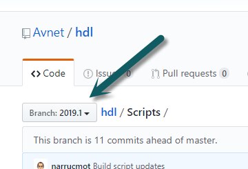

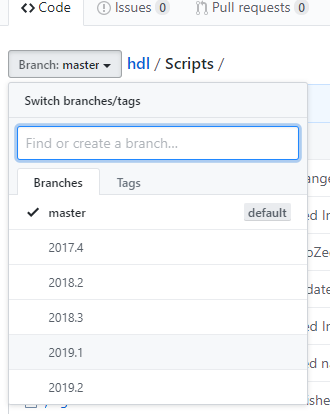

    Hi all,
    I think there is confusion about the blog.
    Bryan was referring to our recommended flow, which is mentioned in the blog and a host of other design documentation.  Compared to the article, and what you posted, there appears to be two issues you have.  First, you are missing a v2 in the name.
    make_ultra96v2_oob.tcl not make_ultra96_oob.tcl
    Second, you need to move to the proper branch.  In the case of the article, 2019.1.  Or whatever branch / tag you want to be on.
    you can see this line listed in the HDL checkout section of the article:  git checkout 2019.1
    There are a host of tags you could leverage - depending on the design / prebuilt image you are working with.
    Once I switched to the 2019.1 branch, you can see the build script is there:
    Here is a direct link to the Webpage if you would like to explore:
    https://github.com/Avnet/hdl/tree/2019.1/Scripts
