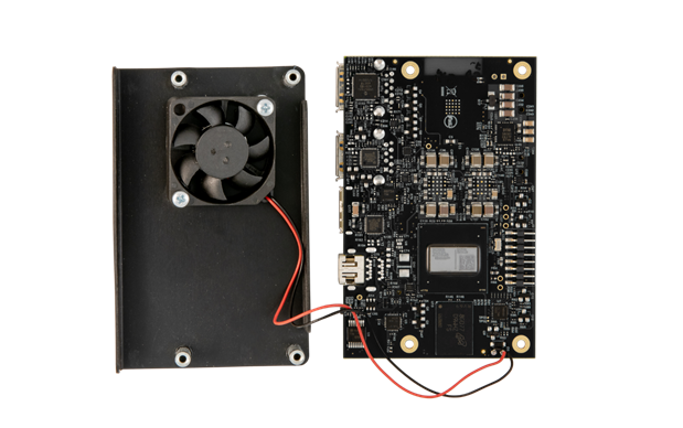

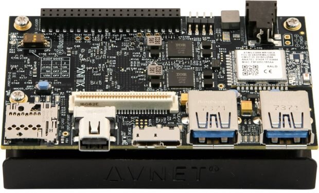

Yesterday, Avnet announced the Ultra96-V2 as a replacement for the Ultra96 which is going EOL.
https://news.avnet.com/press-release/avnet/avnet-introduces-ultra96-v2-development-board
While Ultra96-V2 has the same Xilinx Zynq UltraScale+ MPSoC device, same 96Boards CE form factor, and the same basic features, there are several key differences which I thought would be useful to explain.
  • Microchip Wi-Fi / BLE 5
    • Pre-certified in 75+ countries, including several where Ultra96 was not previously available like China, Taiwan, India, Australia, and New Zealand
    • For the complete list of pre-certified countries, see http://ww1.microchip.com/downloads/en/DeviceDoc/ATWILC3000-MR110CA%20Worldwide%20Regulatory%20Information.pdf
  • Updated Buttons
    • Easier to push
    • Relocated away from sensitive, unprotected ESD-prone connectors
  • Infineon power
    • Opens up future opportunities to automate sophisticated domain control for power savings as well as telemetry reporting
    • While we were modifying the power circuitry, we also added a 96Boards specification to protect the board against accidental, simultaneous plug-in of power on both the baseboard and mezzanine
  • Micron memory upgraded to the latest -053 speed-grade (single-die) since the previous one was not recommended for new design
    • This caused the board definition to change. You can find the new one at https://github.com/Avnet/bdf/tree/master/ultra96v2/1.0
    • For a detailed description of these changes, please view LPDDR4 Memory differences between Ultra96-V1 and Ultra96-V2
  • IDT clock chip
    • Consolidated 3 timing devices on Ultra96
  • Dialog On/Off controller
    • Fixed an interrupt polarity issue with the MPSoC PMU
    • Added a missing 96Boards requirement for instant power on option
  • All components selected to:
    • Eliminate EOL items
    • Update with Industrial temperature-grade options
      • I-grade Ultra96-V2 pending characterization – More info in July
