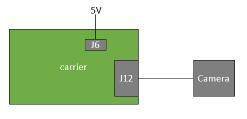

    Thanks for the info.  We have a power supply connected to the board and one connected to the J6 pin 2.  We still see the same behavior even with the external 5V power.  There is no current draw though since the powered USB hub is powering the camera, however without the 5V on pin 2, the USB hub itself doesn't provide enough current for the camera to fully function.  The other thing we have tried is measuring power draw when writing to the network.  With nothing running (except typical Linux processes), the current level is around 0.66A.  As we connect a client (server on the board writes fake images), the current level increases by 0.01A so after 4 clients are connected it's at 0.70A.  At this point after a few seconds/minutes, the xCHI controller dies and the kernel panics and the board locks up (all the typical LEDs are still lit though).  We then tried to get the current draw at 0.70A by something other than the network.  Using the stress Linux tool, we were able to get the draw at 0.71A and so far haven't seen the issue - of course, we haven't ran it for several hours yet (maybe an hour), but with the network test it only takes a minute or less to see the issue.  So we were struggling to figure out if the sudden current drop was causing the issue or is it a symptom of the issue.  Since the stress test hasn't caused the issue thus far, it's looking like the sudden current drop is due to the xCHI controller and camera dying.

    That's strange, so using the external supply to provide the 5V through J6 connecting the camera directly to the board doesn't work? That makes me think there is a handshake action of some kind between the hub and the camera to negotiate "asking" for more power. Otherwise using the external supply directly from the carrier should provide plenty to get the camera running.

    0 ctammann over 6 years ago in reply to jbspears
    So as shown in this quick diagram I made, or is the Hub inbetween the carrier J12 and the camera? image

    Correct, connecting the camera directly to J12 doesn't work most of the time (it may powerup once in a while, but quickly dies when frame capture is started).
    We do have a heatsink/fan on the SOM.  The hub is in between the J12 and camera.
