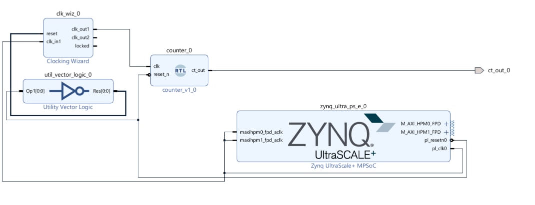

    The below is my design, where I'm taking default configuration of zynq ultrascale+MPSoc and connected it to clocking wizard and generated two clocks of 200 and 800 MHz each and the 200 MHz clock is provided as source to counter and the output of counter is the CT_OUT_0.
    Below is my design. and the default jumper setting is 1.2v, Anyways the design is failing at bitstream phase, so didn't go till board level execution.

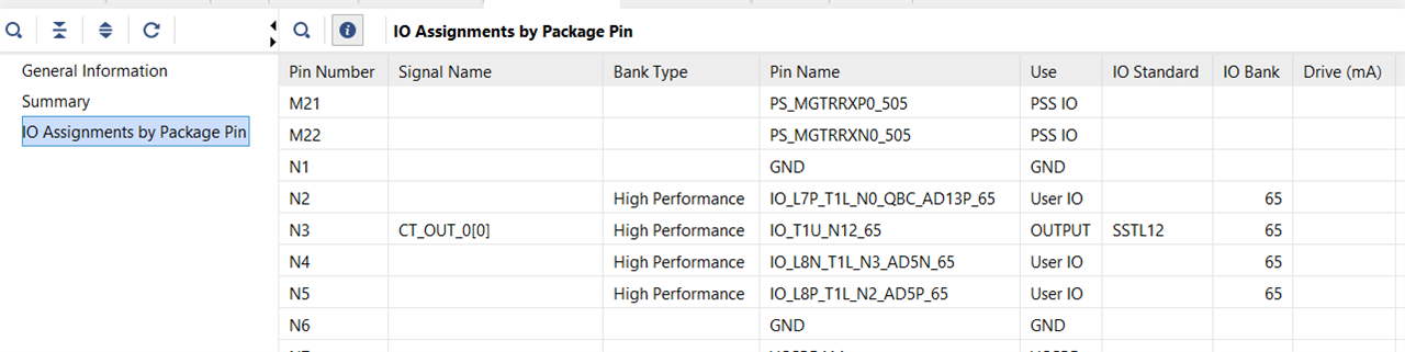

    You appear to be entering the constraints incorrectly. I created an example design with the following constraints:
    set_property PACKAGE_PIN N3 [get_ports {CT_OUT_0[0]}]
    set_property IOSTANDARD SSTL12 [get_ports {CT_OUT_0[0]}]

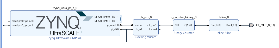

    Also with the following block design:
    I had no issue getting to a final solution. Please revisit your constraints.
    Here is the IO report:

  • Niru_10
    0 Niru_10 over 1 year ago in reply to iksevas
    iksevas
    This works now, I'm not sure what is the issue earlier, Maybe its the constraints not properly added.
