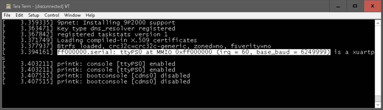

Just: I am struggling to build such a BSP: even I can build it - it crashes on boot:
I seems to configure the UART (for bootlog) with a wrong baudrate and it hangs afterwards.

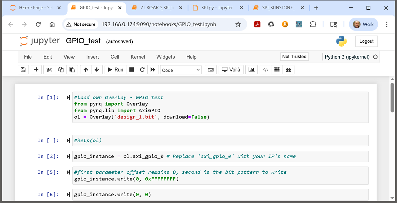

    Even with the "patched" PYNQ boot and Jupyter Notebook working, but no FPGA Manager available
    (not possible to load an overlay bit file in Python!),
    you can still load and use an overlay and with Python Jupyter Notebook!
    Just:
    It is not possible to use INT signals, e.g. from a AXI GPIO, with an AXI INTC. As long as your overlay bit file does not have, does not need...
    an INT signal - it still works to load overlay bit file and use it also in Jupyter Notebook.
    Otherwise, you get an error as:
    "could not find UIO device for interrupt pin IRQ 121" or complaining about "ip2intc_irpt not created"
    Not possible to use INT signals in overlay!
    What to do?
    1. copy the overlay bit BITFILE file into folder
      /lib/firmware
    2. change to root:
      su root      (pw is xilinx as well)
    3. create two directories in /dev:
      cd /dev
      mkdir dri
      cd dri
      mkdir by-path
      We do this just to make Python happy (otherwise you get an error about this missing directory path).
    4. still as root:
      echo BITFILE > /sys/class/fpga_manager/fpga0/firmware
      (it is the name of the BITFILE which must be located in /lib/firmware !)
    5. start the Web based Jupyter Notebook:
      use on loading the overlay - which is already loaded, manually, via the step 4 the download=False option:
      from pynq import Overlay
      ol = Overlay("BITFILE.xsa", download=False)
      or:
      ol = Overlay("BITFILE.bit", download=False)
      (you need to have also an associated *.hwh file! and you have created a /dev/dri/by-path directory, otherwise this will fail)
    Now, you can use your (already loaded) BITFILE as regular on PYNQ, even using names for instances, e.g. ol.axi_gpio_o.
    it works: I can toggle the LEDs, implemented in the OVERLAY bit file
    Just using or even having !! INT signals in BITFILE is not possible.
