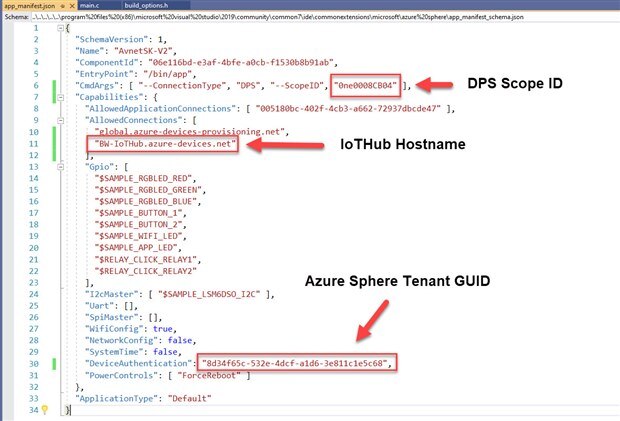

  • Modify the Azure Sphere source code
    • Updating the app_manifest.json file
      • DPS Scope ID and DPS global device endpoint FQDN
      • DeviceAuthentication (Azure Sphere Tenant ID)

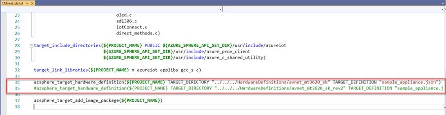

    • Update the CMakeLists.txt file to define which Avnet Azure Sphere Kit you are using Rev1 or Rev1

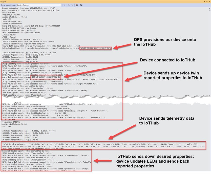

  • Build and run the application

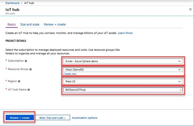

Create an IoT Hub

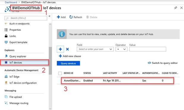

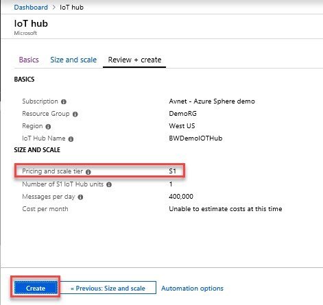

The first thing we need to do is create an IoT Hub.  The IoT Hub is a collection point for IoT devices connecting into Azure.  Once a device is connected to an IoT Hub and streaming telemetry data, other Azure services can ingest the data and do meaningful things.  Azure IoT Hubs can manage connections to hundreds of thousands of devices.
  • Log into Azure https://portal.azure.com

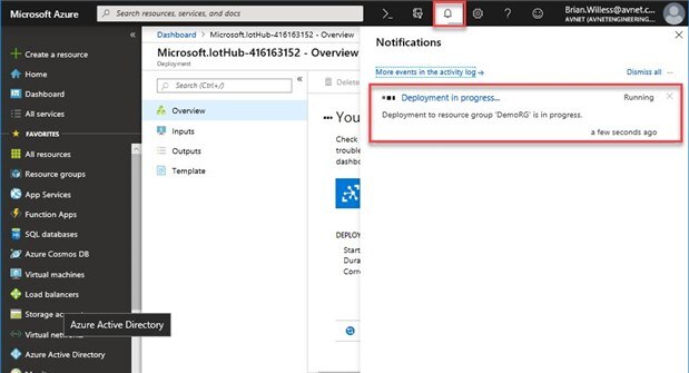

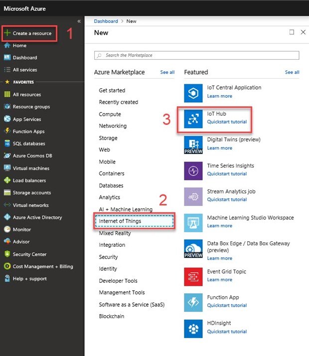

  • Click on “+ Create a resource” à “Internet of Things” à “IoT Hub.”  The IoT hub form will open.
    • You can also use the search bar to search for "IoT Hub."
  • In the IoT hub form fill in each entry
    • Subscription: Whatever your subscription is, it may be a “Free” or “Pay-as-you-Go” subscription.
    • Resource Group: Click on the “Create new” link under the entry box and give your new Resource Group a name.  For example “DemoRG”.
    • Region: Select the region closest to your physical location.
    • IoT Hub Name: Select a name for your IoT Hub. Note that the IoT Hub name must be unique across all of Azure.  Your entry will be validated and if the name you used is not available, the form will display an error.  Azure will generate a FQDN for your IoT Hub, so it must be unique.
  • Click on the “Review + create” button
  • Review the properties for your new IoT Hub.  The “Pricing and scale tier” should be set to S1, the default.  This tier will accommodate 400,000 data messages/day to/from your Azure Sphere device.  After you’re happy with the properties, click on the “Create” button at the bottom of the form.
  • Azure will start to work on deploying your IoT Hub.  This can take a few minutes.  You can monitor the progress/status of your deployment by clicking on the bell icon in the header.

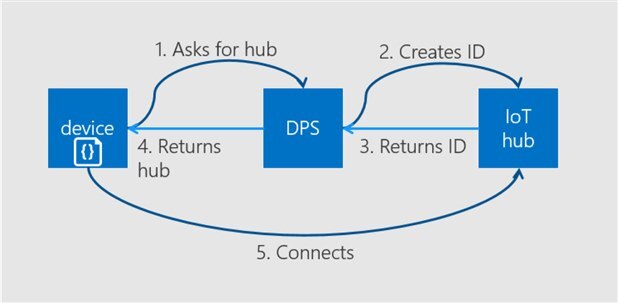

Now that we have an IoT Hub, we need to provision or add devices to our Hub. Devices must be provisioned to an IoT Hub; the IoT Hub will reject any connection attempts from un-provisioned devices.
When we’re talking about IoT this usually implies that we’ll have a very large number of devices. This allows us to collect large amounts of data that can be used to gain insights about our system so that we can make smart, data-driven, business decisions.
But how do we provision all these devices? One way is to manually add each device to an IoT Hub and use an IoT Hub connection string specific to that device. This works for a single device, but what about when you have 10, 100, or 100,000 devices. This approach would require some poor engineer to manually add 100 different devices to the IoT Hub, and would require 100 different application builds, each with its own specific connection string. It’s easy to see this this is not a scalable approach.
To make connecting 100, 100,000, or 1,000,000 devices to Azure easy, Microsoft provides a Device Provisioning Service (DPS). DPS allows large scale deployments without any manual provisioning steps. When you have 10 or 1,000,000 devices this is a great thing!
From the developer’s point of view, I can create a single application build that can be deployed on all my devices. When my devices first connect to the Internet they will contact the global DPS server that will use some specific information in my application to provision my devices onto my IoT Hub(s). The diagram below illustrates how DPS works. After step #5 the device is provisioned and connected to the IoT Hub!

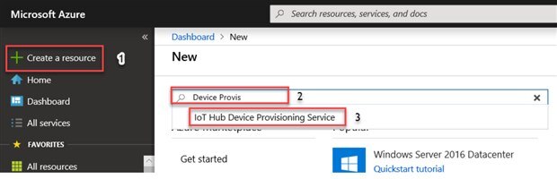

Create a new DPS

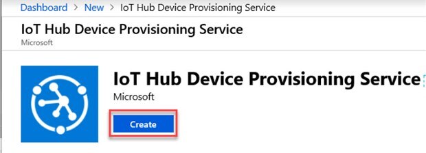

  • In your Azure portal click on the “Create a resource” button
  • Search the marketplace for “Device Provisioning Service”
  • Select IoT Hub Device Provisioning Service
  • Click Create

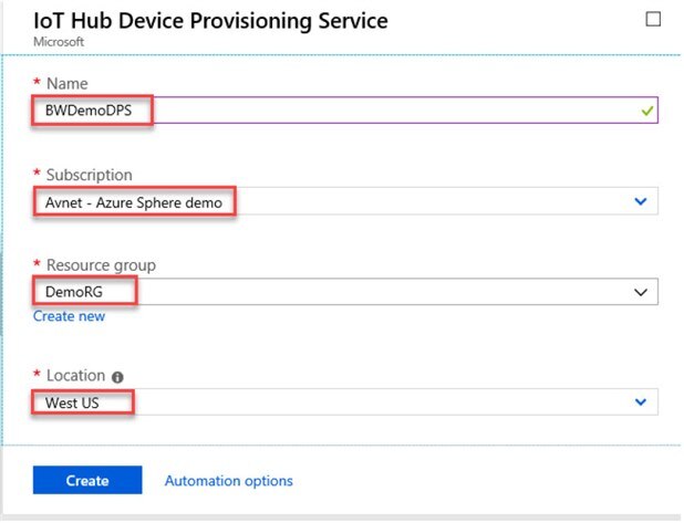

  • In the IoT Hub Device Provisioning Service form fill in each entry

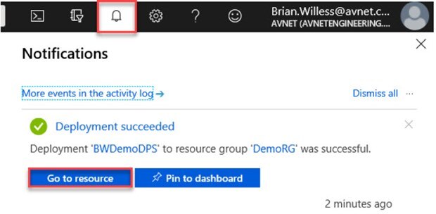

    • Name: Select a name for your DPS
    • Subscription: Select your subscription, it may be a “Free” or a “Pay-as-you-Go” subscription
    • Resource Group: Select the same resource group that you created when you created your IoT Hub
  • Click on the “Create” button
  • Wait for your DPS to be deployed

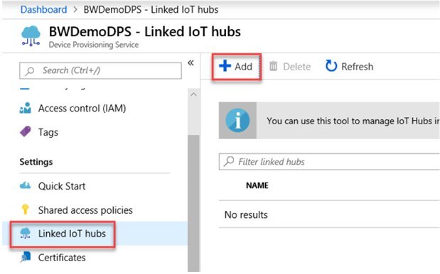

Next we need to configure our DPS. Find your new DPS resource. One way to find your new resource is from the notification icon at the top of the Azure Portal (the bell), click on this icon to see the resources you recently created.
  • Click on the “Go to resource” link

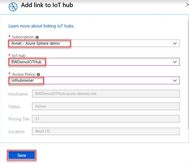

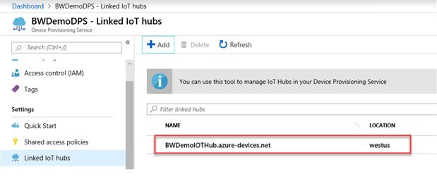

Next we need to associate our DPS with our IoT Hub. This way when a device connects to the DPS, the DPS will know which IoT Hub to provision the device.
  • From the DPS resource find the “Linked IoT hubs” blade (In Azure these configuration categories are called blades)
  • Click on the “+ Add” link
  • In the Add link to IoT hub form fill in each entry
    • IoT hub: Select the IoT Hub we created earlier
    • Access Policy: Select iothubowner from the drop down list
  • Click on the “Save” button
  • You will see your IoT Hub listed by its FQDN
  • If you don’t see your IoT Hub, click on the refresh button at the top of the form

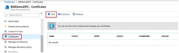

Upload the CA certificate to DPS to tell it that you own all devices whose certificates are signed by this CA. In return, the DPS presents a challenge code.
  • Back in your Azure Portal navigate to the DPS that you created
  • Open the Certificates blade from the list
  • Click on the “+ Add” link at the top of the form
  • In the Add Certificate form fill in each entry
    • Certificate Name: Create a name for your certificate, I recommend using the same name as your Azure Sphere Tenant
    • Certificate *: Browse to the certificate file we just downloaded

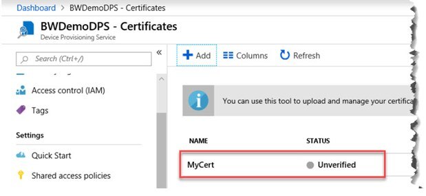

Your certificate will be added to the list and its state will be “Unverified.” Technically, we could have gained access to someone’s tenant ca. Just because we have this public certificate it does not prove that we own the tenant. Next we need to verify the certificate.

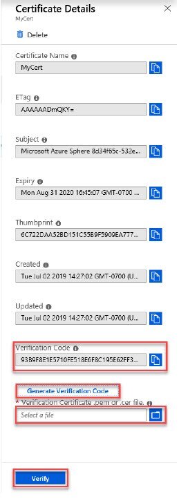

Generate and download a validation certificate from the Azure Sphere Security Service, which signs the challenge code. Upload the validation certificate to prove to DPS that you own the CA.
  • Click on your certificate in the list, this brings up the Certificates Details form
  • Return to the Azure Sphere Developer Command Prompt
  • Copy and paste the following command into the application but do not execute the command yet, as a verification code still needs to be added
          • CLI V1
                    • azsphere ca download-proof --output validation.cer --verificationcode <code>
                  • CLI V2
                    • azsphere ca-certificate download-proof --destination-file validation.cer --verification-code <code>
  • Click on the “Generate Verification Code” link towards bottom of the form, a Verification code is generated and displayed in the “Verification Code” box.
  • Copy the verification code, there’s a copy link to right of the box
  • Back in the command window, replace the <code> text with your verification code and execute the command

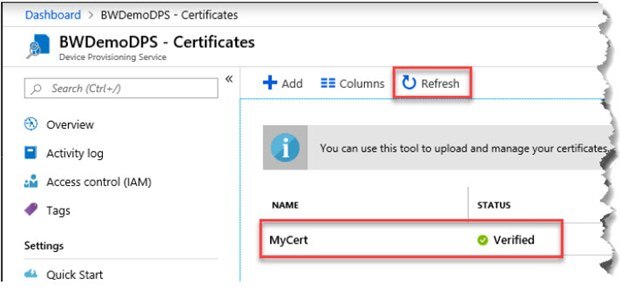

The Azure Sphere Security Service creates a new certificate using the verification code as the subject.  The validation certificate is encrypted with the devices private cert.  Since we uploaded the CA public cert, DPS can decrypt the verification cert and validate that the verification code matches the code it generated.  This way DPS confirms that you own, or have access to the Azure Sphere tenant.
  • Back in your Azure portal, upload the new Verification Certificate by browsing to the file.
  • Click the “Verify” link at the bottom of the form
You should see that your certificate is now shown as Verified. If not, click on the “Refresh” link at the top of the form.

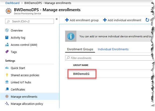

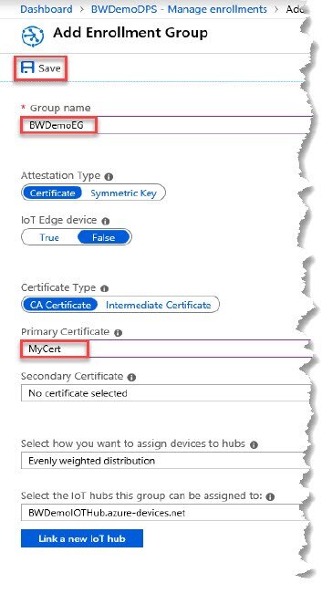

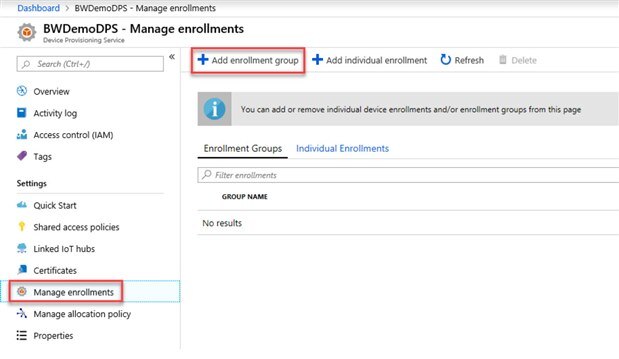

Create a device enrollment group, which will enroll any newly claimed Azure Sphere device whose certificate is signed by the validated tenant CA.
We’re almost done!
  • Back in your Azure Portal, navigate to your DPS resource
  • Find and click on the “Manage enrollments” blade
  • Click on the “Add enrollment group” link at the top of the form
  • In the Add Enrollment Group form fill in each entry
    • Group Name: Create a name for your enrollment group
    • Primary Certificate: Select the certificate that we just uploaded and validated
    • Leave all other fields at the default selections

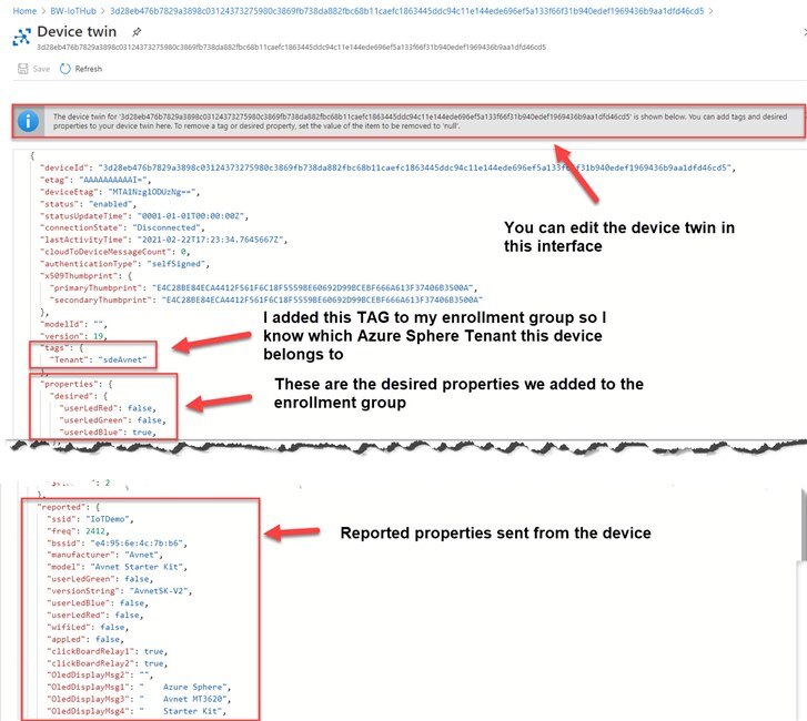

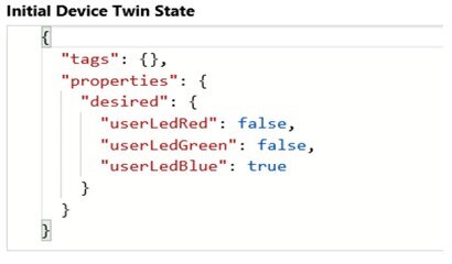

  • Update Initial Device Twin State by adding three userLed entries as shown below, ie.
"userLedRed": false,
"userLedGreen": false,
"userLedBlue": true
Click on the “Save” button at the top of the form
The Initial Device Twin State is a cool feature and the reason why we selected the S1 IoT Hub tier. When devices are provisioned by this DPS, they will get these initial device twin properties. By setting one or more of the userLed properties to true we’ll be able to see when our device connects to our IoT Hub. When the device connects to the IoT Hub it will receive this update and turn on any LED set to true!
You should see your new Enrollment Group appear in the list

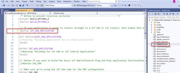

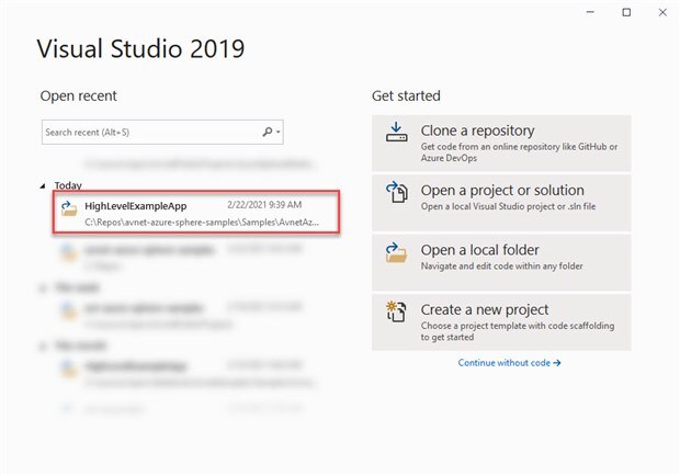

Now let’s go back to Visual Studio.  If it’s not open, go ahead and launch the Visual Studio application and open the /Samples/AvnetAzureSphereHacksterTTC/HighLevelExampleApp project.  Visual Studio keeps a list of recent projects, your project should be found in that list.
Remember in the simple non-connected application we discussed the two different build configurations:
  1. No cloud connectivity.  This is the simplest configuration.  The application runs and you can monitor sensor data from the Visual Studio debug window.
  2. IoT Hub connectivity.  This configuration requires an Azure IoT Hub and DPS.  Once we have the Hub configured and the application connecting to the IoT Hub, we’ll walk through how to provision a Time Series Insights (TSI) application to visualize the sensor data and control GPIOs on the board from the cloud.
For this example we’ll enable the IoT Hub Connectivity configuration.
  • Open the build_options.h file
  • On about line #6 remove the “//” comment characters to enable the #define IOT_HUB_APPLICATION configuration.  Save your work by typing (Ctrl+S).
Open the app_manifest.json file for this application. There are three items we need to include in order for our application to use DPS and connect to our IoT Hub:
  • DPS Scope ID: This is used when our application connects to the global DPS, this allows the global DPS to route our request to our DPS.
  • AllowedConnections : The “AllowedConnections” parameter is required to open a network firewall on the Azure Sphere device. We will locate and add the following detail:
    • The IoT Hub’s Hostname
  • DeviceAuthentication: This is the GUID for your Azure Sphere Tenant. This is included so that this application will only work on devices claimed to our Azure Sphere Tenant. So if someone was able to get our application and side load it onto an Azure Sphere device, that device would not be able to connect to our Azure services, unless it’s in the same Azure Sphere Tenant.

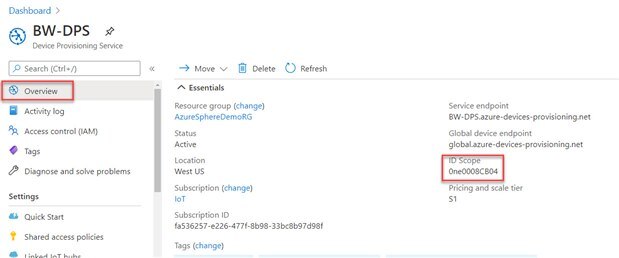

Open your DPS resource in Azure and on the “Overview” blade locate:
  • ID Scope: Copy + paste this FQDN into the “CmdArgs” line in the app_manifest.json file.

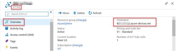

IoT Hub Hostname
From Azure also locate and copy the IoT Hub Hostname. Navigate to your IoT Hub resource and in the “Overview” blade find and copy your IoT Hub hostname. Add the hostname to your “AllowedConnections” line in your app_manifest.json file.

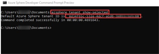

The “DeviceAuthentication” GUID is really just your Azure Sphere Tenant GUID. Get this by using the command line interface and the command azsphere tenant show-selected (You may be asked to login to your tenant to do this). Copy the reported GUID and paste this in the “DeviceAuthentication” line of your app_manifest.json file.
Below is a capture of an app_manifest.json file with the changes identified.
  • Open the CMakeLists.txt file in the project
  • Determine which Starter Kit revision you have Rev1 or Rev2.  This can be determined by looking at the silk screen text under the Avnet Azure Sphere certified module
  • Find the azsphere_target_hardware_definitions lines.  Make sure you uncomment the line that describes which kit you have
    • In the example below I 'm using a Rev1 kit
  • If you get this wrong, the wifiLED device twin control will not work correctly since the GPIO driving the LED is different between the two kits

Let's review this output . . .
AZURE_SPHERE_PROV_RESULT_OK
This output is showing that our device was provisioned on our IoT Hub by our Device Provisioning Service
IOTHUB_CLIENT_CONNECTION_OK
This output shows that our device has connected to our IoT Hub.   If you don't see your device connect to the IoT Hub, please review the Troubleshooting Azure IoT Hub Connection Issues blog entry.
Device sends up Device Twin Reported properties
The application sends up reported properties for all the device twins that I knows about.  This seeds the device in the IoT hub with all the device twins that the application supports.
Sending telemetry:
This output shows the telemetry data we’re sending to Azure.  We’re sending JSON key: value pairs. To send telemetry, you just need a valid JSON structure.  The IoT Hub will collect this data and simply pass it on to any services that subscribe to the IoT Hub.
Device Twin Desired Properties
This debug is from the initial device twin desired properties we put into the DPS Enrollment Group.  When the device connects to the IoTHub, it will send down all desired properties so that the device can sync up with the cloud configuration.  After processing each item, a reported property message is sent with the new value as requested in the desired property.  On my device, the Blue element of the RGB LED is on after processing these messages.

    • Log into your Azure account https://portal.azure.com.
    • Navigate to your IoT Hub (1)
    • Find and click on the “IoT devices” blade (2)
    • Click on your device (3)

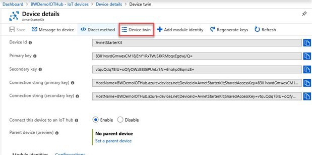

Click on the “Device twin” link.
The Device Twin page opens up and displays a scrolling window with the contents of our device twin.
A few things I want to point out here.
  • Notice the information bar stating that we can modify the device twin from this interface.
  • Desired properties.  This object contains the initial device twin structure we added to the DPS enrollment group.  We can add additional desired properties and Azure will send Cloud to Device (C2D) messages to our application with the desired {key: value} pairs.  More on this soon.
  • Reported object. This JSON object has all the device twin properties that our application sent up on startup.  Remember we did not do anything special on the Azure side to pre-define these properties.  Our application sent them up, and Azure populated them into our device twin.
The reported properties is a cool feature.  For instance, we sent up the “versionString.”  This could be used when managing a large number of devices to make sure all devices in the field are running the correct application version.

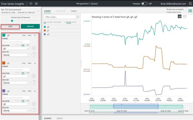

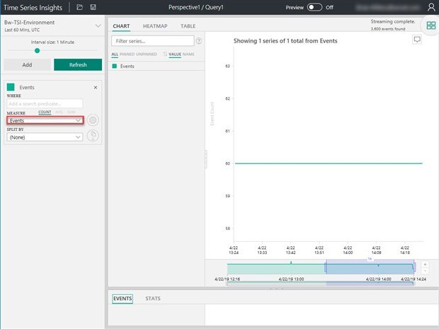

Our application is also streaming lots of telemetry data.  What can we do in Azure to view this data?  One answer is to setup a Time Series Insights (TSI) environment.  TSI documentation is here.  There are other services available in Azure to visualize your data, TSI is easy to setup and is a powerful tool.
“Azure Time Series Insights provides powerful data exploration and telemetry tools to help you refine operational analysis.”

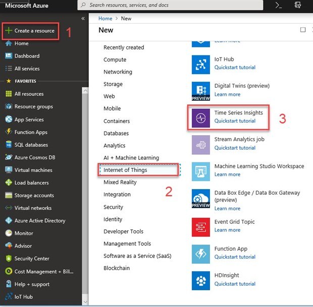

  • Login to your Azure account: https://portal.azure.com
  • Click on the “+ Create a resource” link (1)
  • Click on the “Internet of Things” category (2)
  • Click on the “Time Series Insights” link (3)

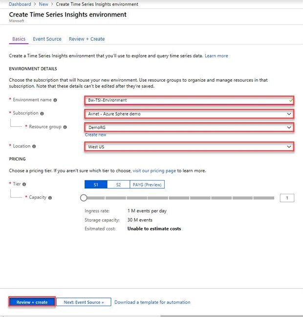

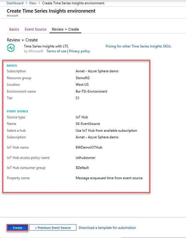

On the “Basics” Tab fill in the form
  • Enter a name for your TSI environment
  • Select your Subscription
  • Select the same Resource Group you used for the IoT Hub
  • Select the Location closest to your physical location

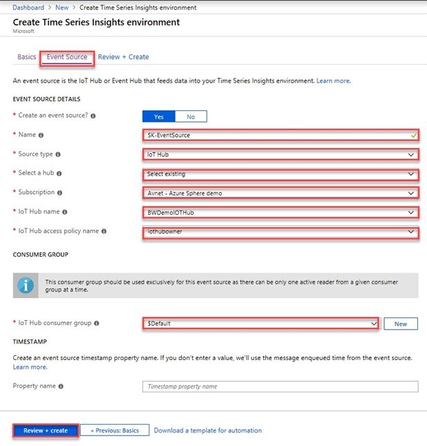

Next click on the “Event Source” tab.
  • Name: Select a name for your event
  • Source Type: Select “IoT Hub”
  • Select a Hub: Select “Select existing”
  • IoT Hub Name: Select the name of your IoT Hub from the list
  • IoT Hub access policy name: Select “iothubowner”
  • IoT Hub consumer group: Select “$Default”
  • Click on “Review + create”

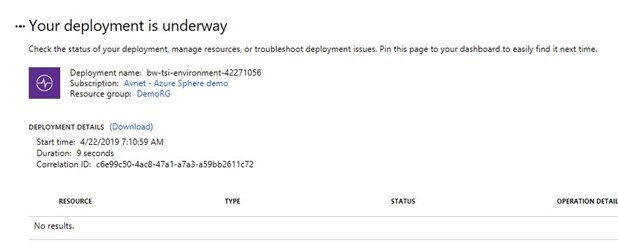

On the “Review + Create” screen, review your settings and if they look good, click on the “Create” button at the bottom of the form.
You’ll see your TSI environment being provisioned:

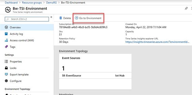

Once your deployment is complete (mine took 42 seconds), navigate to your new TSI resource.

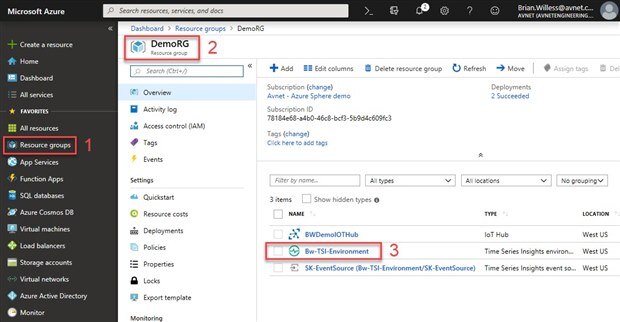

  • From the left most column, click on “Resource Groups”
  • Select your resource group
  • Select your TSI Environment
  • Click on the “Go to Environment” link
The Environment will open, but you won’t see any data
Select the “Events” pull down menu.  You’ll see entries for all the different telemetry items the application sends up, select the “gX” entry.  You can add additional measurements to the graph by clicking the “Add” button.  The graphic below shows the gX, gY, and gZ data all plotted.  I was moving my Starter Kit around on the different axis’s to generate this data.

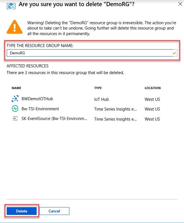

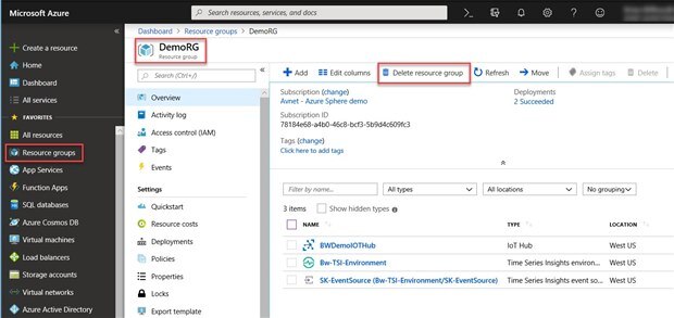

Clean up the resources
When you’re finished playing with the graph and the demo, you should delete the Azure resources.  If you don’t delete them, then you’ll see monthly charges for the IoT Hub, and for the Time Series Insights resources.  The quick and easy way to remove all these resources is to delete the Resource Group.
  • Open the Azure Portal: https://portal.azure.com
  • In the left most column, select “Resource Groups”
  • At the top select “Delete resource group”
  • Type the name of your resource group into the form
  • Click on the “Delete” button at the bottom of the form.
