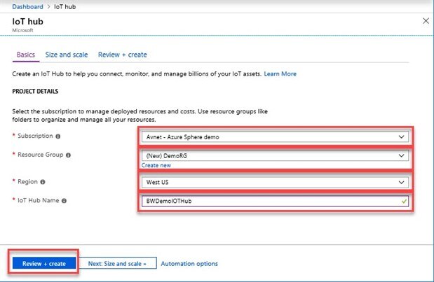

Create an IoT Hub
The first thing we need to do is create an IoT Hub.  The IoT Hub is a collection point for IoT devices connecting into Azure.  Once a device is connected to an IoT Hub and streaming telemetry data, other Azure services can ingest the data and do meaningful things.  Azure IoT Hubs can manage connections to hundreds of thousands of devices.
  • Log into Azure https://portal.azure.com
  • Click on “+ Create a resource” à “Internet of Things” à “IoT Hub.”  The IoT hub form will open.
    • You can also use the search bar to search for "IoT Hub."
  • In the IoT hub form fill in each entry
    • Subscription: Whatever your subscription is, it may be a “Free” or “Pay-as-you-Go” subscription.
    • Resource Group: Click on the “Create new” link under the entry box and give your new Resource Group a name.  For example “DemoRG”.
    • Region: Select the region closest to your physical location.
    • IoT Hub Name: Select a name for your IoT Hub. Note that the IoT Hub name must be unique across all of Azure.  Your entry will be validated and if the name you used is not available, the form will display an error.  Azure will generate a FQDN for your IoT Hub, so it must be unique.

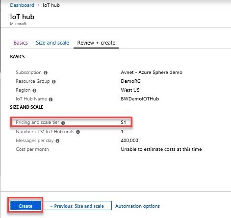

  • Click on the “Review + create” button
  • Review the properties for your new IoT Hub.  The “Pricing and scale tier” should be set to S1, the default.  This tier will accommodate 400,000 data messages/day to/from your Azure Sphere device.  After you’re happy with the properties, click on the “Create” button at the bottom of the form.
  • Azure will start to work on deploying your IoT Hub.  This can take a few minutes.  You can monitor the progress/status of your deployment by clicking on the bell icon in the header.
