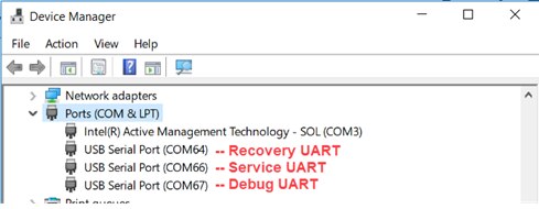

FTDI USB Combo Interface Features

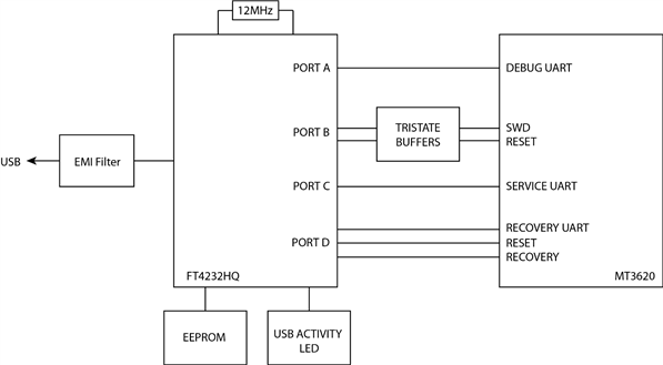

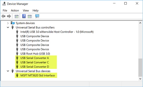

Of value during development and debug of your software applications, is getting to know the multiple interfaces supported by the FTDI FT4232 USB Serial bridge device on your Starter Kit. This provides three dedicated MT3620 UART interfaces (with RTS/CTS flow-control plus RESET and RECOVERY control signals) as well as a full SWD Programming/Debug interface to the M4 cores on the MT3620 device.
An example of how Windows Device Manager reports these MT3620 interfaces is shown below:
The Avnet Azure Sphere Starter Kit implements all of the interfaces that are detailed in the Microsoft documentation on this topic at
https://docs.microsoft.com/en-us/azure-sphere/hardware/mt3620-mcu-program-debug-interface
Some noteworthy aspects include the following:

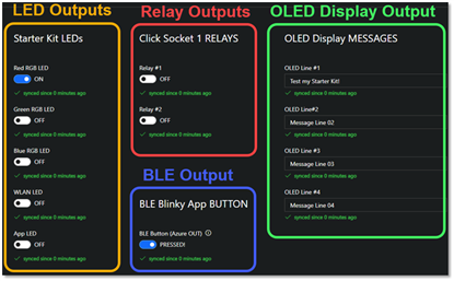

  • paradug
    paradug over 7 years ago +1
    Where do I find the source for the application shown at the beginning of the article? Specifically, the panel that shows the state of the LED outputs, Relay outputs, OLED display output, and BLE output…
  • peterfenn
    peterfenn over 7 years ago in reply to paradug +1
    The screenshot is from an adapted version (a BLE Pmod board is fitted to the Starter Kit) of the Advanced Tutorial material. This has not yet been posted
  • peterfenn
