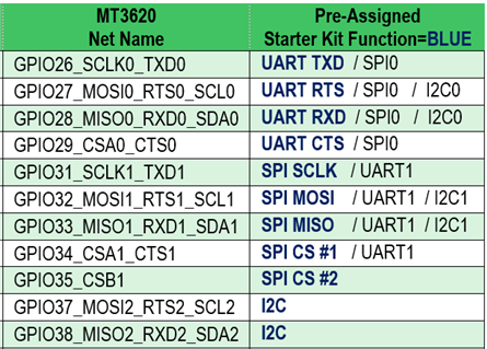

Avnet Starter Kit use of MT3620 ISUs (serial interface blocks)
The three ISUs accessible on your Starter Kit are "preconfigured" in that the ISU signals pinned-out of the module were limited for the support of:
  • ISU0: UART0 (4 IOs)
  • ISU1: SPI1 (5 IOs)
  • ISU2: I2C2 (2 IOs)
It is possible however within these pinout limitations, to assign the ISU functions as follows:
  • ISU0: use for I2C or UART or SPI
  • ISU1: use for I2C or UART or SPI
  • ISU2: use for I2C only
The table below shows in blue text the functions these ISUs are "assigned" to on the Starter Kit, followed by the alternative interfaces that can be supported by these pins
The serial interface capabilities of the ISUs are documented at:
https://docs.microsoft.com/en-us/azure-sphere/hardware/mt3620-product-status

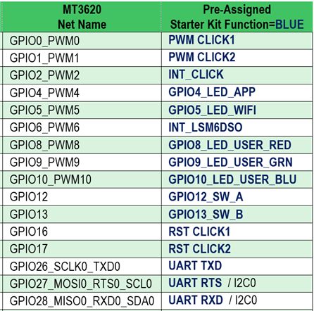

Starter Kit use of GPIOs
The table below shows in blue text the functions that other GPIOs have been assigned to on the Starter Kit

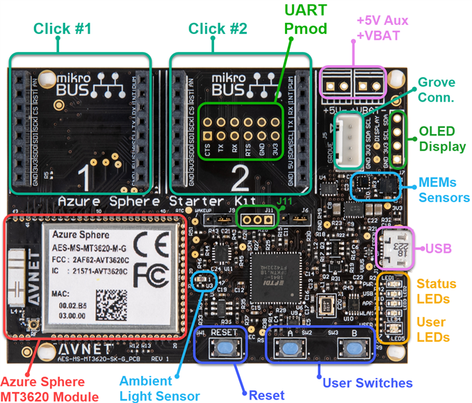

Starter Kit unpopulated Expansion Connectors
Additional expansion options are accessible via three unpopulated connector sites on your Starter Kit (see green-colored call-outs in the board view above)
J11 3-pin header
This pins-out the TXD outputs of the MT3620's two M4-dedicated UARTs, typically for M4 application debugging (via a USB to serial cable)
but can alternatively be assigned for user-defined GPIO functions

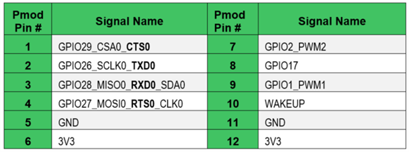

J13 UART/BLE Connector
An unpopulated 2x6 connector site is located under Click Socket #2. Designed to accommodate a 2x6 right-angle female socket,
the pinout is compatible with a subset of Pmod peripheral boards available from Digilent and other suppliers
Notes:
  • The four (ISU0) UART pins and GPIO2 are shared with both Click sockets
  • GPIO1 and GPIO17 are shared only with Click socket #2
  • The WAKEUP input pin allows an external device to wake-up the MT3620 SoC
  • All signalling on this connector is at 3.3V levels
Right-angle Pmod connector (viewed from board edge)

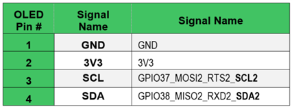

J7  OLED Display Connector
The pinout and corner mechanical mounting hole were designed to accommodate one of many 3rd-party 128x64 I2C OLED graphic displays
Make sure to select an OLED display with GND and VCC in the correct order! (Some low-cost OLED displays reverse the sequence of the GND and VCC pins!)
This connector site can alternatively be used for easy attachment of an external sensor to the I2C bus
OLED Display Connector (viewed from above the board edge)

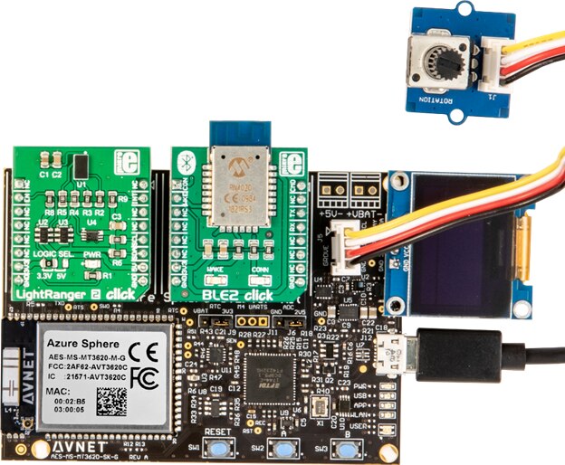

    Steve, Thanks for pointing this out. The Grove connector on the Azure Sphere Starter Kit is committed for I2C use only For access to ADC inputs you will need to make use of a Click board rather than Grove…
  • stevesmythe
    stevesmythe over 7 years ago +1
    peterfenn The photo at the bottom of this article shows a Grove rotary angle sensor plugged into the Grove socket on the Azure Sphere board. This would require an ADC channel to read the voltage. Is this…
  • peterfenn
    peterfenn over 7 years ago in reply to stevesmythe +1
    Steve, If looking for a rotary control, have you considered a rotary encoder? There are a couple of inexpensive Click boards that encode the position of the control, some with a ring of LEDs to provide…
