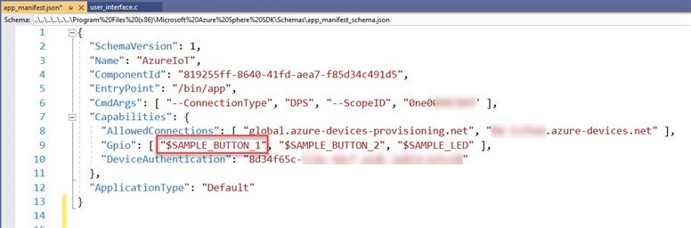

    • GPIO

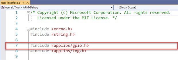

      • Include the GPIO libraries in the project
      • Add the GPIO reference to the app_manifest.json file

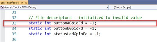

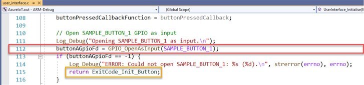

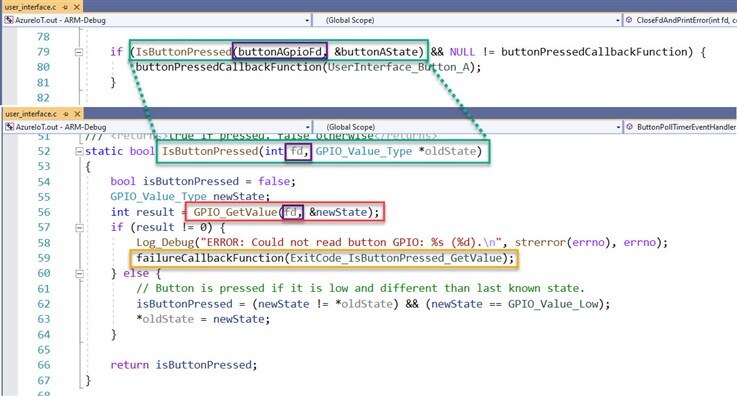

      • Declare a file descriptor

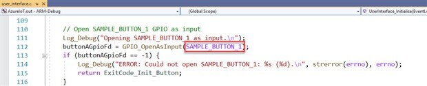

      • Open the GPIO as an input
      • Read the GPIO level

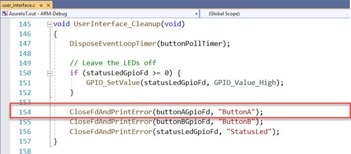

      • Close the file descriptor

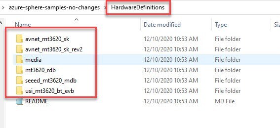

  • Hardware Abstraction Layer

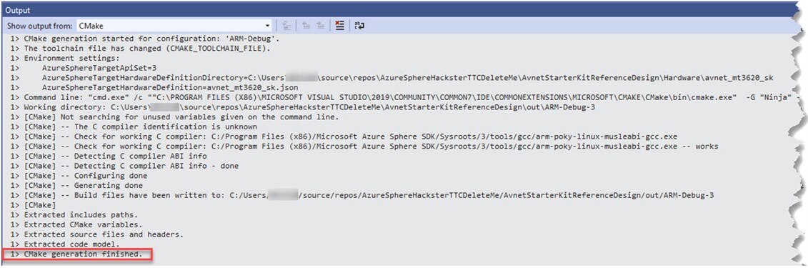

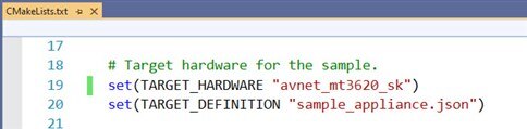

    • Modify a project to reference a different hardware solution

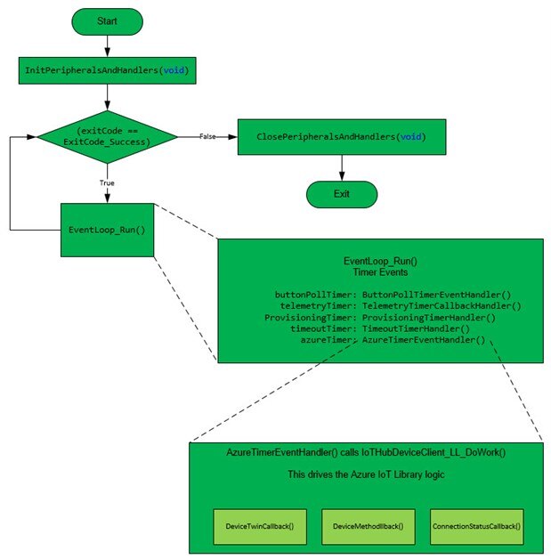

High Level Application Architecture
Since Azure Sphere is a connected secure IoT solution.  I recommend leveraging Microsoft’s AzureIoT Azure Sphere example, or one of the Avnet example projects for new high level applications. The AzureIoT example connects to an Azure IoTHub and implements all the connection, Device to Cloud (D2C) and Cloud to Device (C2D) logic that any connected application requires.
To understand this application let’s examine the four ways the application execution path is driven.
  1. main() loop
  2. Event Loop Timers
  3. Event Loop Events
  4. Azure IoT Library Callbacks

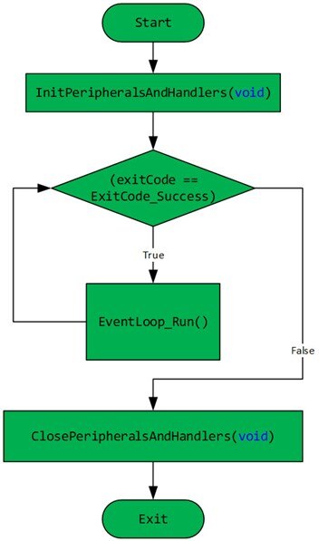

The main() loop
On start up the operating system passes execution control to the main() function along with any command line arguments defined in the app_manifest.json CmdArgs entry .  The main function in the AzureIoT example application can be simplified into three sections.
  1. Initialization: InitPeripheralsAndHandlers()
    1. Allocates system resources
    2. Configures hardware interfaces
    3. Configures timers and timer handlers
  2. Main loop
    1. Checks to see if any other logic in the application has set the global variable exitCode to flag an exit condition.
      1. If application code in the rest of the high level application encounters an error condition it will set the global variable exitCode to reflect any issue encountered.
    2. EventLoop_Run() “Runs an EventLoop and dispatches pending events in the caller's thread of execution.”
  3. Clean up: ClosePeriheralsAndHandlers()
    1. Closes hardware interfaces
    2. Releases system resources
Upon application exit, the value of exitCode is returned to the OS so that the exit reason is visible for application health tracking and troubleshooting.  Exit codes are defined in common/exitcodes.h in the ExitCode enumeration definition.

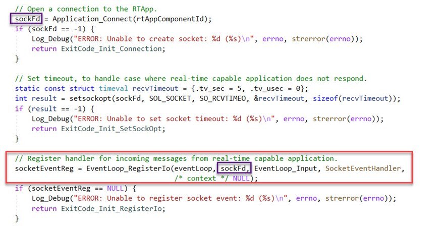

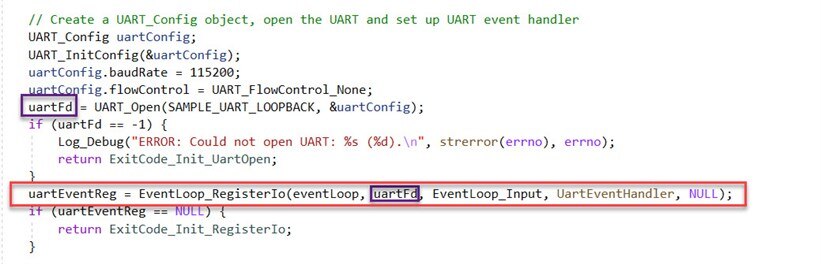

In addition to timer events, Azure Sphere supports events based on input/output (I/O).  These events are tied to file descriptors.  The Azure IoT example does not implement any I/O events, so let’s examine using I/O events in other example applications.
When an application uses a UART, it can register an Event Loop I/O event so that when the UART receives data, an event fires and a user defined handler will be called that executes the logic to read and process the UART received data. See the UART_HighLevelApp example to see how this is configured and used.
Another example is when two Azure Sphere applications share an inter-core communication connection.  The Event Loop I/O event can be configured so that when the real time application inserts a message into the queue, the high level application is notified and a handler is called to process the incoming data.  See the intercoreComms High Level example application to see how this is configured and used.

High Level Application Diagram
If we put together a diagram that shows all the elements discussed above it would look like . . .

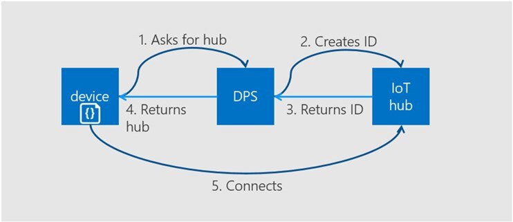

The recommended method to provision IoT devices to Azure IoT Hubs is to use an Azure service called a Device Provisioning Service (DPS).  You can read all about DPS here.  Using a DPS you can deploy a single software application build onto millions of devices.  The first time each device connects to the internet, and then the global DPS server, they will all automatically be provisioned to an IoT Hub and then connect to the IoT Hub that each device was provisioned to.  This is a powerful IoT concept and is required to deploy IoT devices at scale.  The diagram below shows the process . . .
The AzureIoT example supports multiple ways to connect your device to an IoT Hub or IoT Central.  The readme.md file in the gitHub repo contains all the details to connect the application to an IoT Hub.

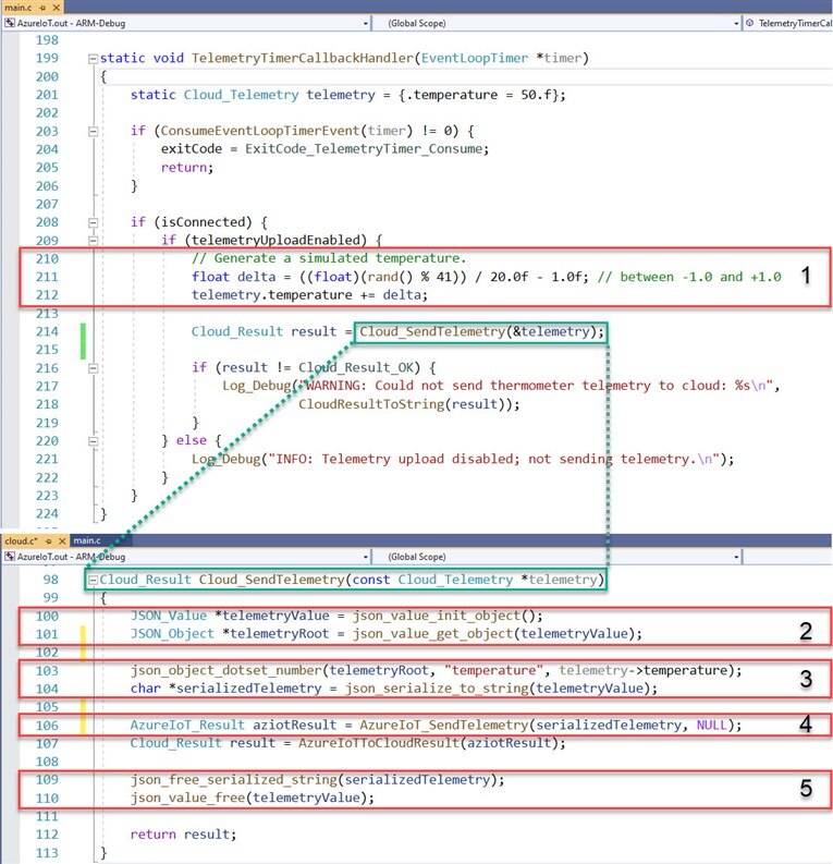

Below you’ll see the AzureIoT example application code to create and send a JSON telemetry message.  There are basically five things to do . . .
  1. Read your sensor or generate the data to send (line 211)
  2. Allocate memory to store the JSON object (line 100)
  3. Construct the JSON object (lines 103-104)
  4. Send the message to the IoTHub (line 106)
    1. The message will be sent the next time IoTHubDeviceClient_LL_DoWork()is called
  5. Release the memory resources (lines 109 - 110)

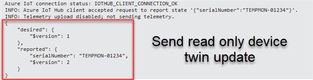

Device twins can be read only as well.  For example, the AzureIoT example sends up a device twin when the application connects to the Azure IoT Hub:  {"serialNumber":"TEMPMON-01234"}.  This device twin captures the device serial number so it can be viewed or used to drive a custom work flow from the Azure cloud.

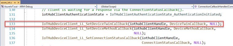

Setup a Device Twin callback routine
Before we can receive a Device Twin update, we need to tell the Azure IoT Library how to inform the application when a new Device Twin message is received.  In azure_iot.c around line #133 the application informs the Azure IoT Library that the routine DeviceTwinCallback() should be used to process incoming Device Twin messages.

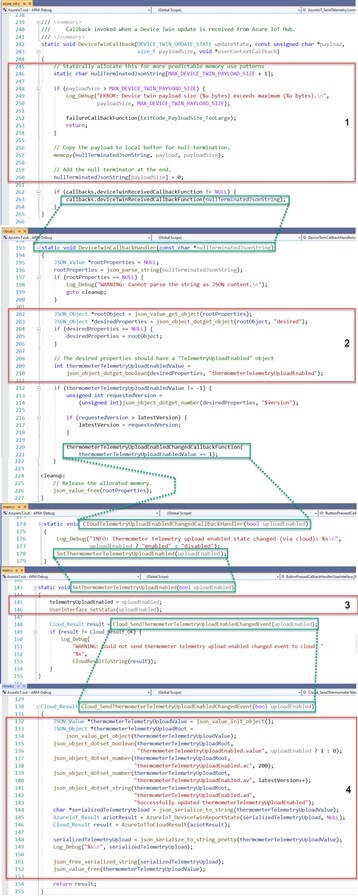

Implement the callback routine and send a reported properties message back to the IoTHub

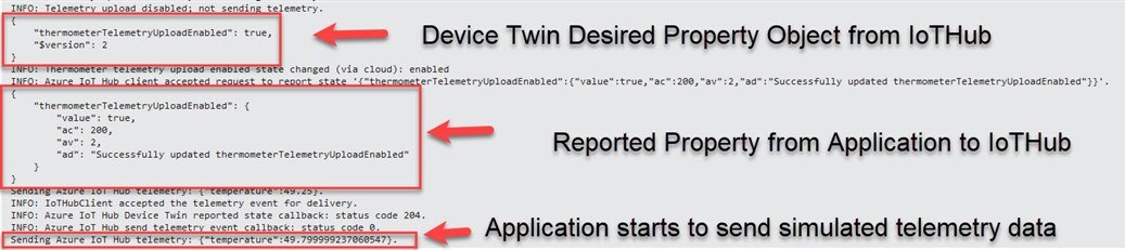

The application code path is shown below.  It's a little crazy, but this graphic documents what happens when the device twin desired property update is received from the IotHub.  I've identified some of the more interesting code.
  1. The incoming payload is copied to a memory buffer and null terminated.  The JSON parser requires a null terminated string.
  2. The routine looks for the "thermometerTelemetryUploadEnabled" Key
  3. The global variable is updated with the new value passed in by the device twin desired property
  4. The "reported" property JSON is constructed and sent back to the IoTHub
    1. Notice that there is extra metadata appended to the response.  These items are required for Azure Plug and Play and IoTCentral interactions.
Note: Click on graphic below to see full size image
I've added code to the example to capture the device twin JSON as it's received and sent for reference.

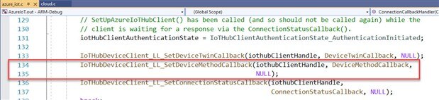

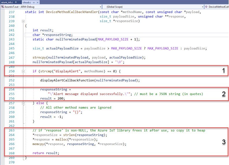

Another powerful IoT Hub feature is Direct Methods. You can read the Azure documentation on Direct Methods here.  You can also read a very detailed blog all about Azure Sphere and Direct Methods here.
“Direct methods represent a request-reply interaction with a device similar to an HTTP call in that they succeed or fail immediately (after a user-specified timeout). This approach is useful for scenarios where the course of immediate action is different depending on whether the device was able to respond.”
Let’s see how to implement a Direct Method on Azure Sphere and review the AzureIoT example application direct method implementation.  There are three things we need to accomplish to implement and use a direct method.

Setup a Direct Method callback routine
Similar to processing Device Twin messages from the IoTHub, we tell the Azure IoT Library that we want to be notified when a direct method is called on our device and provide a callback handler.
The callback implementation is shown below. There are three sections identified in the graphic.
  1. Check to see if the Direct Method called is the one we expect “displayAlert”
  2. Construct a response string and a response code
  3. Allocate memory on the heap and copy the response string to the allocated memory.  Note that the Azure IoT Library is responsible for freeing this memory. Return the response code 200 to tell the Azure IoT Library that we successfully processed the Direct Method.

  3. Declare a file descriptor that we’ll associate to our GPIO signal
  4. Open the GPIO pin as an input and assign a file descriptor to work with the hardware
  5. Read the GPIO level using the file descriptor as a reference to the hardware
  6. Close the file descriptor
Using the AzureIoT example let’s identify the source code for each of these items . . .
To add the GPIO libraries to our project just include gpio.h header file
We need to explicitly grant permission for the application to use the GPIO signal for Sample Button 1.  We add "$SAMPLE_BUTTON_1" to the app_manifest.json file in the Capabilities --> Gpio section. At build time the Hardware Abstraction layer implementation will map "$SAMPLE_BUTTON_1" to the number 12 or GPIO12.  If we were to omit this step, when the application attempted to open GPIO 12 the OS services would block the operation and return an error.
The Microsoft documentation on the app_manifest.json file can be reviewed here.
The system uses file descriptors to reference and operate on hardware interfaces.  We declare a file descriptor sendMessageButtonGpioFd to allow the code to operate on the GPIO interface.  You’ll notice that all calls to initialize and read the GPIO pin reference this file descriptor.
This line of code opens GPIO 12 (SAMPLE_BUTTON_1) as an input. That will allow us to read the GPIO level.
Read the GPIO level
This is the code that actually reads the GPIO hardware.
When the application exits, it calls the ClosePeripheralsAndHandlers() which calls UserInterface_Cleanup() to clean up.

Microsoft has implemented a hardware abstraction layer so that the Microsoft Azure Sphere GitHub samples can run on multiple Azure Sphere hardware platforms.  All the Microsoft Azure Sphere GitHub examples use this abstraction layer. This is a great feature because there are multiple Azure Sphere platforms and each of these platforms may expose hardware features of the underlying Azure Sphere device in different ways.  You can read about the Hardware definitions and how to create custom definitions here.
For example the Seeed development kits and the Avnet Starter Kit all use pushbuttons and user LEDs.  These devices use GPIO signals.  Microsoft needed an implementation so that a single sample application could correctly reference the GPIO signals for the hardware platform that the application was built for, even if different hardware platforms used different signals for a common function like driving a LED.
To implement the abstraction layer, they have included a “HardwareDefinitions” folder in the azure-sphere-samples directory structure.  Under the “HardwareDefinitions” folder, there are folders for each of the currently supported platforms.
Each folder contains a JSON file and a header file that maps the board-specific, or module-specific features to the underlying Azure Sphere MCU hardware signals.  The example projects use identifiers when referring to hardware signals which are mapped to the specific peripherals on the target hardware platform.
Here’s a code snippet where the AzureIoT example opens the GPIO for the button.  Note that we don’t pass in the GPIO integer, but an identifier that references the actual GPIO signal, an integer.  In this way different hardware platforms can use different GPIO signals for the buttons, but the sample application will work for all hardware platforms as long as the hardware definitions are correctly defined and the correct hardware platform is defined for the build.
To specify the target hardware in an Azure Sphere project open the CMakeLists.txt file and update the azsphere_target_hardware_definitions() statement to specify to the correct HardwareDefinitions directory for your kit or solution.
Or
When you modify and save this file, the CMAKE subsystem will automatically re-generate the build configuration.  If there is a problem with the path or filename that you added, you’ll see errors.  A successful process will look like the graphic below.
Note that the default platform for all the Microsoft GitHub examples is the Seeed development kit.  So if you’re using the Avnet Starter Kit, you’ll need to update this property each time you open a sample project from GitHub for the first time.
