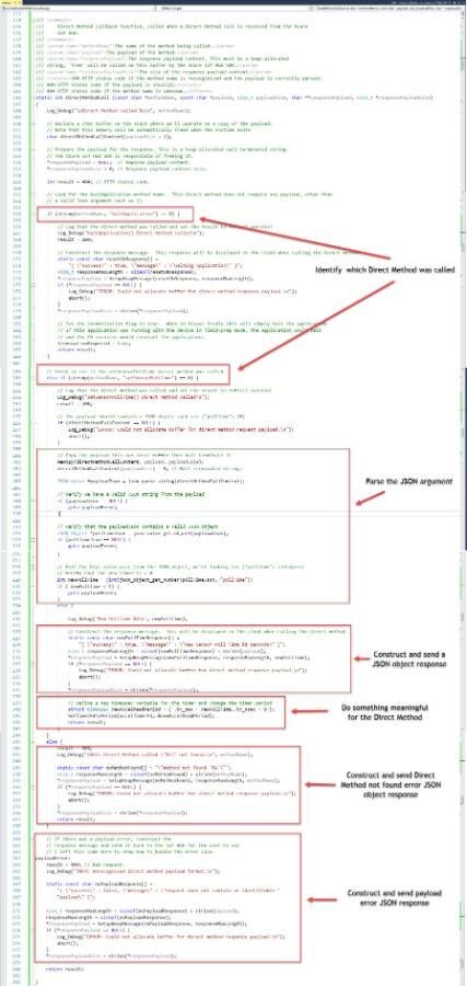

(3) Implement the callback method
The callback method must use a specific function signature shown below:
static int <Your_Callback_Method_Name> (const char *methodName, const char *payload, size_t payloadSize, char **responsePayload, size_t *responsePayloadSize)
Annotated Code Example
The graphic below calls out each of the pieces needed to implement the Direct Method.  You can click on the graphic to see a larger version of the picture.

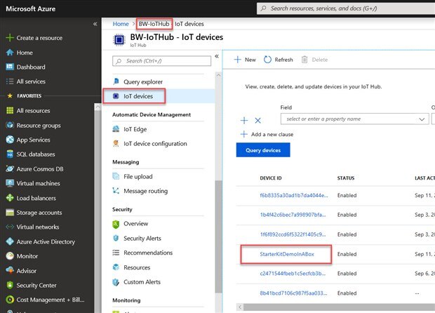

  1. Open the Azure Portal and sign in
  2. Find your IoT Hub, open the IoT Hub resource
  3. From the IoT Hub instance find the "IoT devices" blade, then your IoT device
    1. image

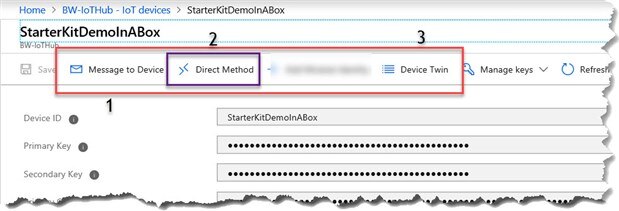

  4. Once you're inside the page for your IoT Device look along the top of the window.  Here you'll see some of the things you can do with your IoT device.  Note that the three ways we identified to send C2D message are all represented in this interface.  Since this blog is all about Direct Methods, click on the Direct Method link.
    1. image

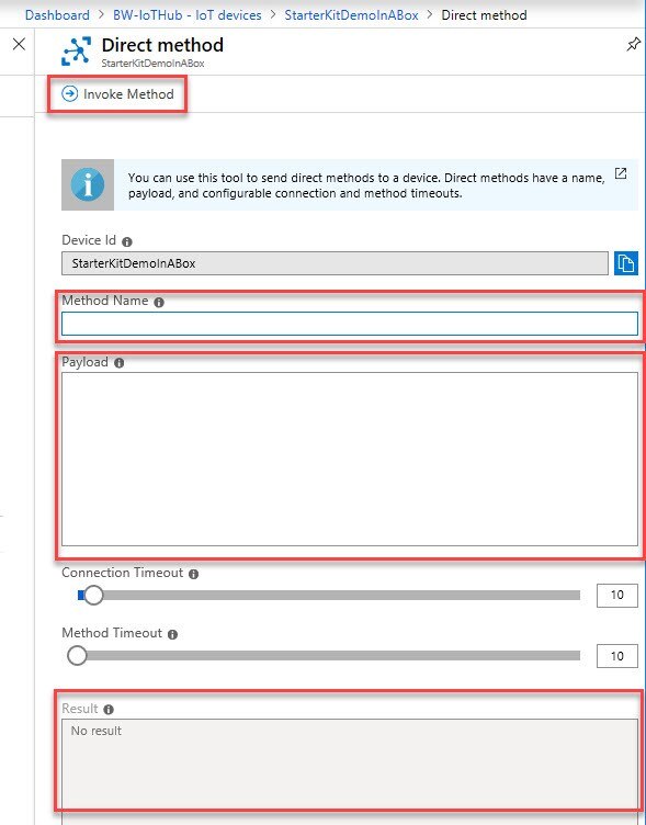

  5. This will open the Direct Method interface. Below I'll describe each item in this interface:
    1. Invoke Method:  This is the GO button.  After you enter the Method Name and any Payload details, click on the "Invoke Method" link to send the Direct Method call to your device.
    2. Method Name: This is where, you guessed it, you type in the name of the Direct Method you want to call in your application.  Note that this name is case sensitive.
    3. Payload: This is where you type in the JSON structure with the arguments for your Direct Method.
    4. Result: This is where the JSON return object will be displayed.

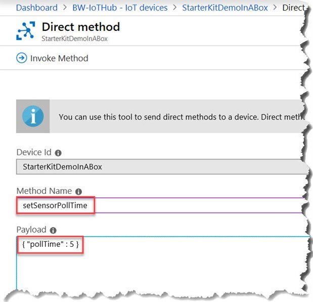

Let's see it in action:
In the graphic below I'm calling the setSensorPollTime Direct Method and I'm setting the new poll time to 5 seconds.
Next I click on the "Invoke Method" link:
  1. Azure IoT Hub sends the Direct Method Call to my device
  2. The Azure Sphere OS Services catch the message and invoke my directMethodCall() routine and include all the required arguments
  3. The routine determines that the setSensorPollTime Direct Method was called
  4. The setSensorPollTime code parses the argument JSON object and validates that the data is good
  5. The setSensorPollTime code changes the poll timer

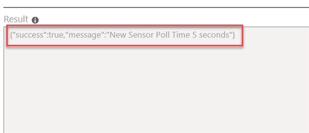

  6. The setSensorPollTime code constructs the return JSON object and sends it back to the Azure IoT Hub
You can see that the return JSON object is displayed in the Azure Portal inside the Result window!  Like magic!
