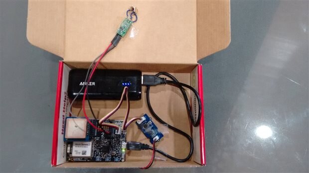

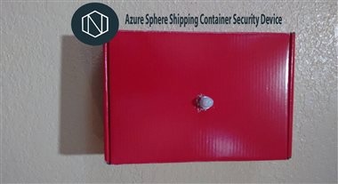

The monitoring of incoming cargo into US ports and roadways is of vital importance for a multitude of security and economic reasons. Cargo shipments can be subject to problems such as theft, tampering, or being used to smuggle contraband without the knowledge of the shipper.
The Azure Sphere Shipping Container Security Device is a portable security device that will be mounted inside the doors of a container and will be used to continuously monitor for unauthorized door access, unauthorized relocation of the container outside the facility , and detect breaches to any of the six walls of a container.

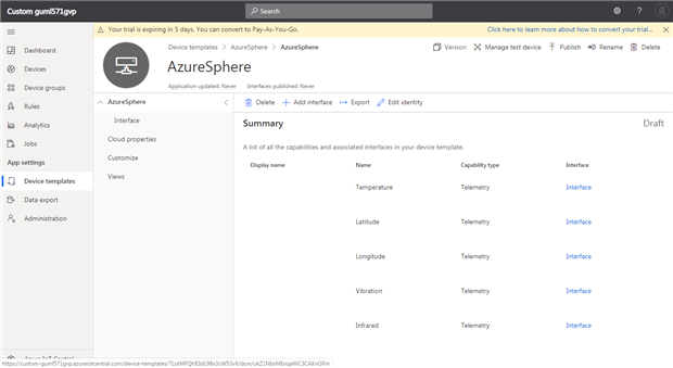

Configure IoT Central Hub

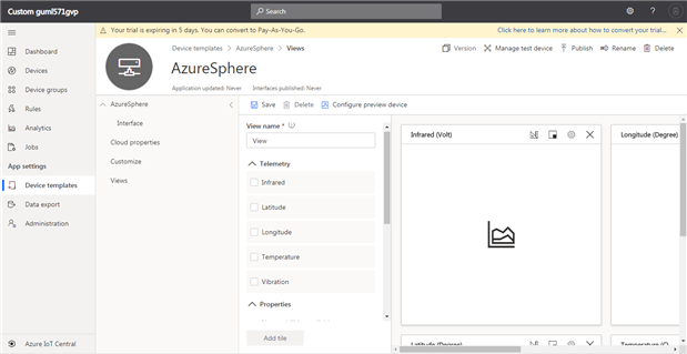

Once the IoT Central Hub and had been set up with the Azure Sphere MT3620, create the following interfaces in device template :
  • Temperature
  • Latitude
  • Longitude
  • Vibration
  • Infrared
Then go to view and create five chart as below. These chart will help to visualize Azure Sphere data over time.

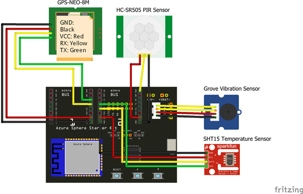

  • 1. GPS
    • The first sensor that I interface the MT3620 is the GPS. For GPS, I used UART protocol to get the data from the GPS module. Below is the function for GPS:
  • 2.Grove Sensor Vibration
    • Next , I configure the Grove Vibration Sensor with I2C protocol. The output is an analog value from 0-3.3V which i scale to 0-100. In my system, anything above 60 is consider major vibration and could be a possible breach.
  • 3.Temperature Sensor
    • Temperature Sensor is also use I2C protocol. The process is similar to Vibration Sensor but the register address is changed.
  • 4.PIR Motion Sensor
    • The motion sensor implementation is simple. The senor output a high (3.3V) if there detection of human presence and a low (0V) if there no detection. I connect the output of the PIR Motion Sensor to a PWM pin on the MT3620. The simply just check the pin value and send a 1 or 0 based on the pin voltage level.

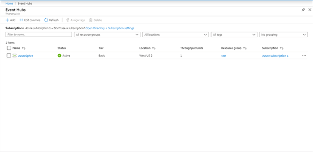

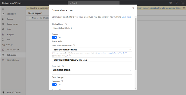

For this project, I used the Azure Cloud Services to create an Azure Event Hubs to store the data from the IoT Central Hub. The Azure Event Hubs are going to serve as a cloud storage platform where my app going to pull data that the MT3620 send out. First, I set up an Azure Event Hubs as show below :

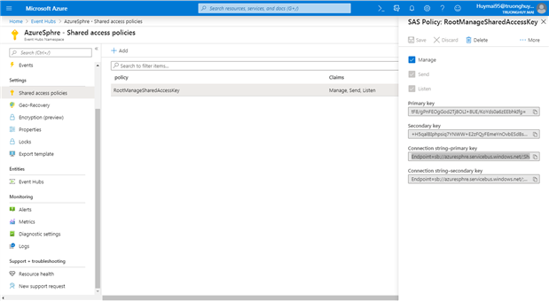

Then I go and find the primary key connection string-primary key. These number going to be used to link with the Azure IoT Central Hub and the phone app.
Then enter the connection primary-key into the Azure IoT Central Hub in the data export section.

    • To compile the firmware you must have VS2017 with Azure Sphere SDK install. Launch the .sln file in AzureFirmware folder and press F5 to compile.
Final Product
