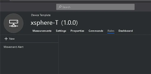

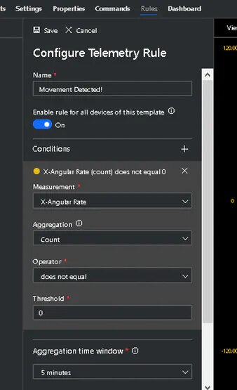

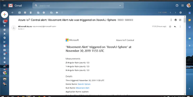

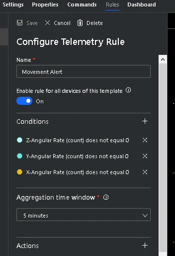

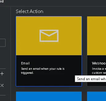

  • Setting up rules to trigger email

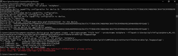

  • Put your device to debugging mode. Use command azsphere device enable-development or azsphere dev edv (make sure you have connected your device and its working.

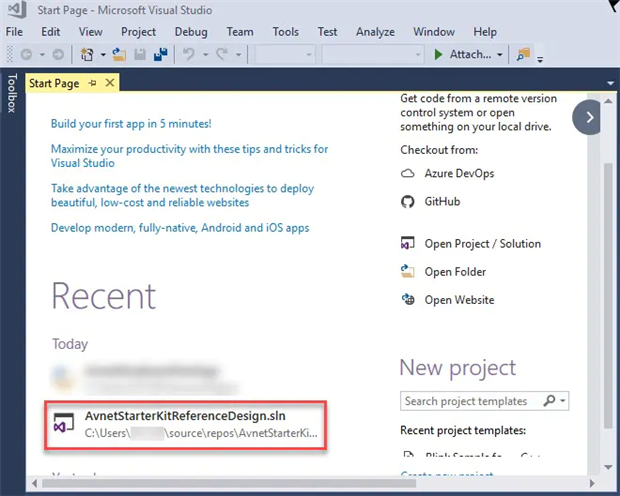

Now that we have the GitHub extensions installed we can clone the project to our local drive.
  • Open Visual Studio, Start a blank project without any code. From the pull down menus select "File" then select “Clone or check out code”. In the repository location paste this https://github.com/Avnet/AvnetAzureSphereStarterKitReferenceDesign.git

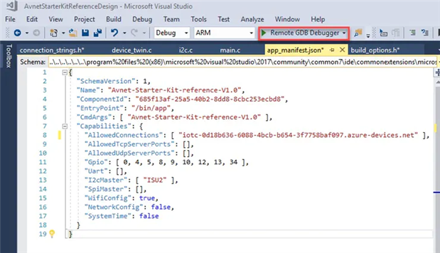

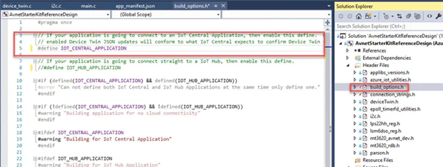

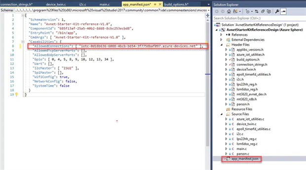

Open the Solution Explorer and expand the project “AvnetStarterKitReferenceDesign” This will display all the different resources in the project. Expand the “Header Files” and “Source Files” folders to see the source code for the project.
The build configurations are defined in the build_options.h file. Open that file and confirm that both IOT_CENTRAL_APPLICATION and IOT_HUB_APPLICATION are both commented out. Look around lines 5-8 for the #define pre-processor directives. This will build the no cloud connectivity configuration.

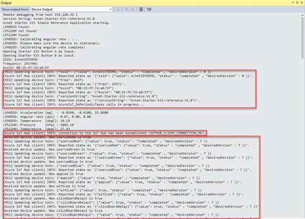

One of the really cool features of the Azure Sphere development environment is that to build, link, load, and run your embedded application all you have to do is click one button.
  • Build, link, sideload, and run the project by clicking on the “Remote GDB Debugger” button at the top of the application.
You’ll see the build and link process, then a popup window stating that Visual Studio is starting the debugger on the target. If all goes well, you should see output similar to the text below. If there is a problem, the build output will tell you what’s wrong and hopefully provide a hint on how to correct the issue.
Remote debugging from host 192.168.35.1
Version String: Avnet-Starter-Kit-reference-V1.0
Avnet Starter Kit Simple Reference Application starting.
LSM6DSO Found!
LPS22HH Found!
LSM6DSO: Calibrating angular rate . . .
LSM6DSO: Please make sure the device is stationary.
LSM6DSO: Calibrating angular rate complete!
Opening Starter Kit Button A as input.
Opening Starter Kit Button B as input.
SSID: AvnetIOTDEMO
Frequency: 2462MHz
bssid: 00:15:ff:7d:a8:5f
LSM6DSO: Acceleration [mg] : 62.8300, -36.9660, 1002.7180
LSM6DSO: Angular rate [dps] : 0.00, 0.00, 0.00
LSM6DSO: Temperature [degC]: 24.11
LPS22HH: Pressure [hPa] : 1063.18
LPS22HH: Temperature [degC]: 23.08
You have successfully completed your first demo application well done! Now you are good to go for the next application that is our PROJECT.

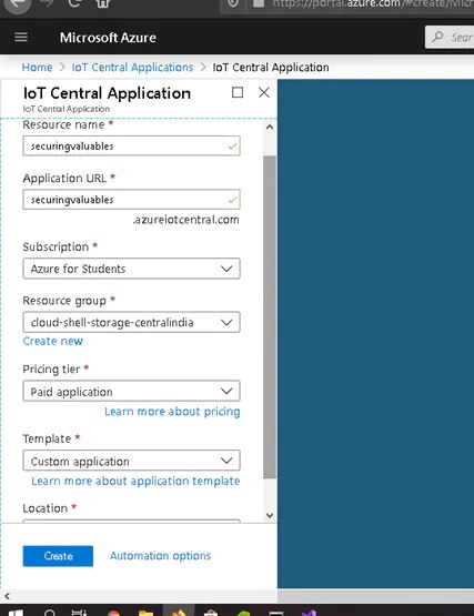

  • Now login to your Azure account

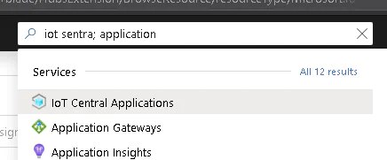

  • Create a IoT Central Application here, if the link doesn't work simply search for IoT Central Application in the Azure Home search bar and create / + one.
  • Fill in suitable information. As you are new to Azure you may have to create a new resource group, So click create new and fill the required info there. Now select "Custom Application" under Template.
  • Now "Create" the application. It make take a couple of minutes.
  • Now directly go to your Application URL previously defined in the application form. xxxxx.azureiotcentral.com replace xxxxx with your custom URL. If you cant access the URL, search for IoT Central Application in your Azure search bar.
  • Find you application and open it. And then go-to your IoT Central URL shown there.

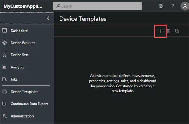

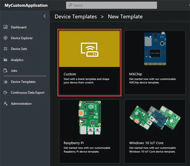

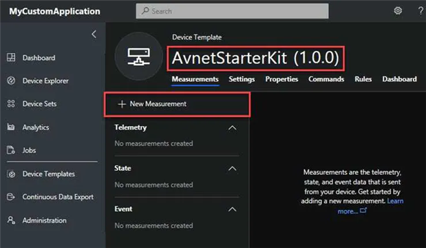

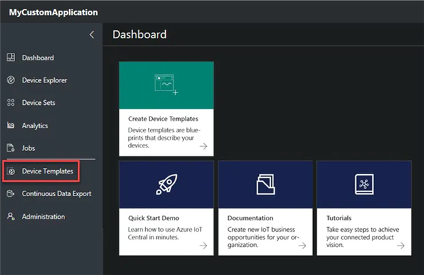

  • Here you’ll see the landing page. The first thing we need to do is to create a “Device Template,” so click on the link at the left side of the page.
A device template is where we’ll define all the information that will be displayed for our device. By default there are not any templates for our beloved Azure Sphere. On the “Device Templates” page, find the “+” link at the top right and click.

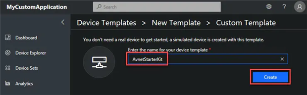

You’ll be given many choices to start your new template.But select the “Custom” square as there isn't any AVNET Azure Sphere Template predefined.
Enter a name for your template, then click on the “Create” button.

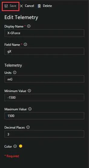

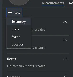

The next page shows your new template. The template is empty. So let’s build it out! We’ll add Telemetry data first, so click on the “+ New Measurement” link.

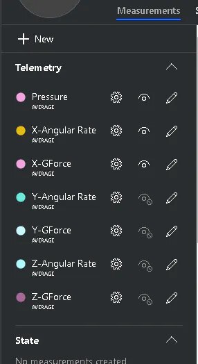

On this page you can add different things to your template. Telemetry, State or Events. The first thing we’ll do is configure some telemetry items, so click on the “Telemetry” square.

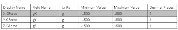

This is where we define all the properties for a new Telemetry item. We’re going to add the X G-Force component to the measurement data graph. To do this we just need to fill out the form.
  • Display Name: The name of the telemetry item to add (anything you want)
  • Field Name: Enter the “key” name of the {“key”: value} key pair telemetry data. The sample Azure Sphere application uses “gX” for the X g-force component, so we enter “gX” in this field.
  • Units: Anything you want, but it should represent the units of your telemetry data, in our case milli-g-force so “mG”
  • Min/Max Value: Use these fields to add bounds to your graph. You should select values that are close to what you expect the maximum and minimum values to be. That way your graph will not have too much empty space or allow your data to be off the graph. We'll set our limits in the range (-1500, 1500)
  • Decimal Places: How many decimal places to show on your graph, I selected to display 3 decimal places of accuracy.
  • Color: Select the color you want for this telemetry item
  • That’s all there is to add telemetry data. The critical piece is that you need to know what key:value pairs your application is sending up. Once you fill out the form, click on the “Save” button at the top of the form.

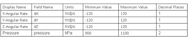

  • Next we need to add Telemetry entries for other axis. Use the table below and your new knowledge to add rest of the data.
Angular Rates and Pressure

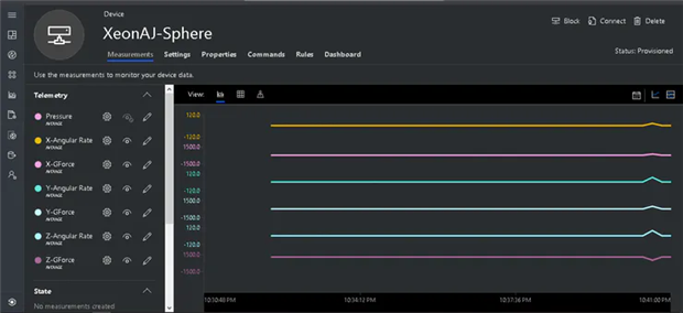

After entering the telemetry measurements, your screen should look similar to the picture below.
  • You may notice data showing up in the graph already. This data is being generated by a Simulated Device. Whenever you create a new Device Template in IoT Central it will auto generate a simulated device, and that device will start to send random data within the min/max bounds you defined in the new measurement configurations.

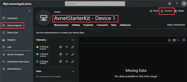

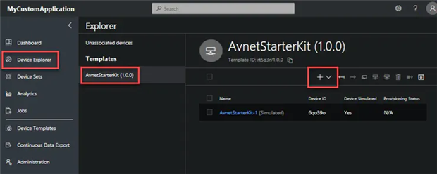

  • To manually add a device to IoT Central, navigate to the Device Explorer by clicking on Device Explorer.
  • Once you’re in the Device Explorer you’ll see the simulated device that was automatically created for you and no other devices listed.

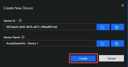

  • Add a new “Real” device by clicking on the “+” link and selecting “Real.”
This will open the “Create New Device” form.
  • Device ID: Leave this set to the default.
  • Device Name: This field is pre-populated with the device template name and the device ID. I like to change it to something friendly.
Click the “Create” button.

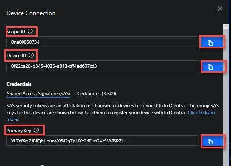

Once created, you’ll be taken to the new devices main page. There’s nothing interesting here yet, because our device is not yet connected to the application. The next step is to generate the connection string.

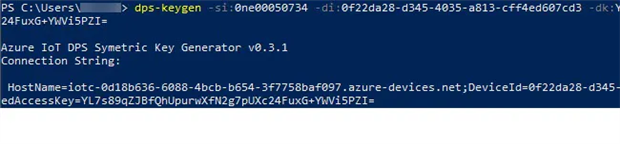

To generate the connection string we’ll use a tool called dps-keygen. This is a simple command line tool where you provide specific information about your IoT Central application and your device, and the tool generates a connection string that your application can use to connect to IoT Central.
Note: node.js must be installed to run the dps-keygen utility. Node JS can be installed here: https://nodejs.org/en/
  • From Windows Powershell execute the command npmi -g dps-keygen. You should see output similar to the picture below:
  • Navigate to your “real” device and click on the Connect link at the top right.
The “Device Connection” dialog box contains all the details we need to use the dps-keygen utility. We need Scope ID, Device ID, and Primary Key.
  • Notice that Microsoft provides a link at the right side to copy the contents into the copy/paste buffer.
  • Back in Windows PowerShell use the dsp-keygen utility to generate the connection string. The command is dps-keygen -si:<scope ID> -di:<device ID> -dk:<device primary shared key>
Note: Make sure you don't have any spaces between the command line arguments and their value. For example do NOT have any spaces between the -si: switch and the scope ID you provide for the -si option
  • Using my device details it looks like this:
My connection string is: HostName=iotc-asdjfnalkejmnfkawjenasjdfnlsamdnfazure-devices.net;DeviceId=asdjfnalksejmnfajenfkasjdnflkmwenawen;SharedAccessKey=skdjfnadjfnkajsdnflkajsdnfkjasdcnfuwejadnfasdfasdkjfas
  • Now let’s go back to Visual Studio. If it’s not open, go ahead and launch the Visual Studio application and open the “AvnetStarterKitReferenceDesign” project. Visual Studio keeps a list of recent projects, your project should be found in that list.
  • Open the build_options.h file
  • On line #5 remove the “//” comment characters to enable the #define IOT_CENTRAL_APPLICATION configuration.
  • Open connection_strings.h and paste the connection string you generated with the dps-keygen tool inside the “ ”. The entry in my file looks like this:
Notice that the first part of the string contains a FQDN hostname, in my case, the hostname is “akjwenflksandklfaneiqanwefijazure-devices.net”
  • Open theapp_manifest.json file. This file is located outside the other folders in your Solution Explorer window, usually at the very bottom of the list.
  • Find the “AllowedConnections” entry and paste the hostname from your connection string into the field with a set of “ ” around the text. If you already have a FQDN for your IoT Hub example, you can replace this FQDN, or add to the list by comma separating the two entries.
  • To compile, link and load the application onto your Starter Kit, you just need to click on the “Remote GDB Debugger” button in the toolbar.
You’ll see the build process run and a popup box stating that Visual Studio is starting the application. If you look at the output window, you should see something similar to the text below.
Check out your Azure IoT Central Application select real device which you created later, you will find telemetry data there.

5. Setting up rules to trigger email

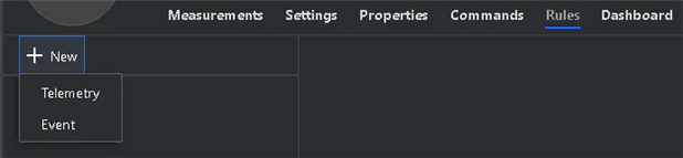

  • Now navigate to your template and select the rules tab.
  • Click on "+ New", We are going to create the most important rule now. The event which would trigger the email stating that your cupboard isn't safe!

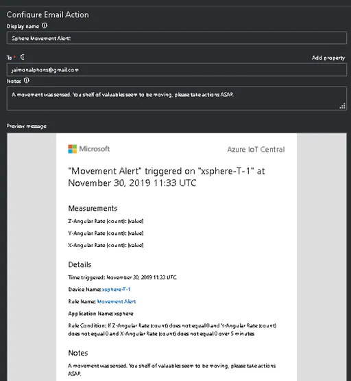

  • Select telemetry
Fill out the required information
Create other two conditions like shown below
Save and click on Actions + and select Email
Fill in the email information the way you like it.
  • Click on save you have successfully created a event for movement alert you have completed the main part.

  • Create a product azsphere product create --name MyProduct
  • Enable Cloud based deployment azsphere device enable-cloud-test --productname "MyProduct"
  • Find the .imagepackage file. Go to your previously cloned GitHub repo on your local disk. Go AvnetStarterKitReferenceDesign > bin > ARM > Debug > AvnetStarterKitReferenceDesign.imagepackage. Copy this path.
  • Load image to your azure sphere device azsphere device-group deployment create --devicegroupname "Field Test" --productname MyProduct --filepath path\to\AvnetStarterKitReferenceDesign.imagepackage
  • Now just unplug your device and connect it to a 5v-2A wall charger or power bank and click on reset button on the board. GREAT now you can see the telemetry on your computer, just move or shake your azure sphere after some time you will recive some

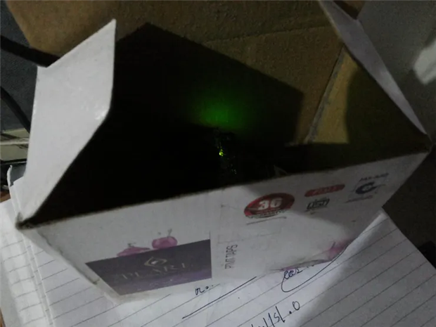

7. Final Placement of module on your wardrobe / shelf door
Hiding my Azure Sphere Movement Detection Module inside a perfume box. And placing it just behind the door.
