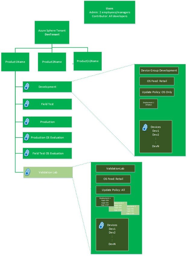

Development Tenant
The development tenant could be organized as shown in the graphic down below.  Please click on the image to enlarge it.  The graphic shows three different products in the tenant.  Each product can have separate development activities.  Under the "Product1Name" product I'm showing 6 device groups. The first 5 device groups are the standard device groups that are created when you create a new product.  The last device group called "Validation Lab" is a custom device group created by a tenant user.  You can create as many custom device groups as you need to support your development process.
Users
The users for this group includes the entire development team as Contributors and a couple of managers as Administrators to add/remove users as needed.
Development Device Group
When devices are put into enable-development mode azsphere device enable-development, they are logically moved into this group.  Note that this group still receives OS OTA updates, but not application OTA updates.
Validation Lab Device Group
I've also shown a custom device group called "Validation Lab."  Since the developers all have access to this tenant, this device group could be used to give the validation team early access to features as they are developed to help flush out use cases and obtain feature feedback before any production builds are available.  Devices that have been claimed to this tenant could be deployed to the Validation Lab and builds/applications can be pushed to the devices OTA by uploading them to this device group.

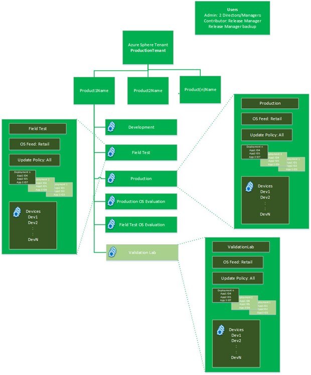

The Production tenant could be organized as shown below.  Please click on the image to enlarge it.  Each device group can have different builds/applications/deployments so you can manage risk for the devices in each device group as appropriate.
Users
The users for the Production tenant is limited to only the most trusted team members.  I'm showing director level Admins and Release Managers with the contributor role.  This way only the Admins and Release Managers have the ability/access to push new builds to the validation team or production devices as builds pass through the organization's release process.  With great power comes great responsibility!
This device group still exists in this product and if a production device needs to be moved into this group for troubleshooting or debugging, any of the defined users can enable development for the device then pass it to a developer/engineer.
The Validation Lab could have production units claimed to this tenant and defined in this device group.  The Release Manager can push release candidate builds to the device group for each test pass.
The release process should be tightly controlled.  Once a build/application has been pushed to the tenant then deployed to the Validation Device group, it can be moved/associated to other device groups in the tenant.  So the build that the Validation team tested is the exact same build that gets deployed to the Field Test or Production device group.  This is the proper way to promote builds through the process and guarantees that the build that was tested is the build that gets deployed.
Field Test Device Group
This group could be used for your Beta customers that are willing to accept early releases and provide early feedback to the product team.
Production Device Group
This group is used to manage all your production devices.  You could have multiple Production device groups.  For example maybe you want to manage devices by region so you could have ProductionAsia, ProductionUS, and so on.  Maybe your product has multiple hardware revisions that require different application builds, you could create separate Production device groups for each, for example ProductionRev1, ProductionRev2 and so on.
OS Evaluation Device Groups
Your validation plan should always include testing new OS releases before they are released into the retail feed.  Microsoft will push new OS builds to the OS Evaluation feed 2-3 weeks before they are moved to the retail feed.  These device groups facilitate testing new OS releases as early as possible.
