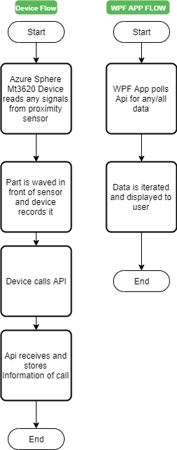

Challenge:
  1. In small scale manufacturing industries,There is manual labor involved in parts of production process
  2. Many times inventory of (individual) processed parts(of product) are taken when phases of manufacturing are completed
  3. The counting is laborious and slow .Even more there is no time estimate taken for each separate part processing to give a real estimate,So questions like below cannot be answered
    1. E.g. Time it takes to process a single part through trimming metal phase?.
  4. Integration of a Counting solution so as to have no impact on the various processes of manufacturing
Idea/Working:
  1. An Azure Sphere based IOT solution with a Proximity sensor will act as a counter
  2. When a person finishes the process on a individual part,The person will wave the part in front of the sensor for a brief moment for it to get recorded
  3. An Wpf desktop App can then present the Job sheet  in front of the user (displaying time it takes to process each part) ,with features for exporting data

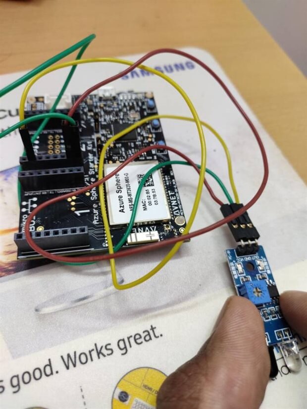

Parts:
  1. Avnet Azure Sphere IOT Kit
  2. Proximity Sensor
  3. Web Server (PHP installed)
  4. A Mobile Hotspot connected to Azure Sphere (Small scale industries may not be connected to internet )

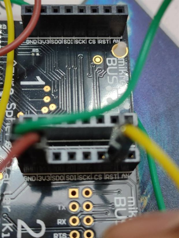

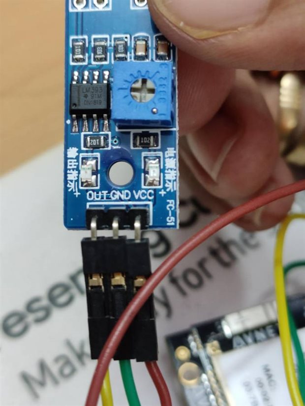

Solution:
  1. I used the Azure sphere Multi CURL sample as base starting point
  2. A Proximity Sensor was connected to GPIO pin 17 for data input
  3. The Azure Sample was modified to call my API whenever a input was read from the sensor
  4. The API created an entry on the php database hosted on my website
  5. A WPF app was created which can interact with the API and get the records in JSON form for displaying to proprietor

FlowChart:
