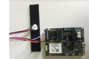

In this blog, I'll demonstrate how I connected a Heart Rate Sensor to the Avnet MT3620 kit. The Beats Per Minute are calculated and displayed on an attached OLED Display. The RED LED will indicate the users heart beat..

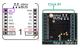

Since we're using the Avnet Azure Sphere Starter Kit, We will be putting the 3 leads from the Heart Sensor into boards headers on the Click Socket #1.

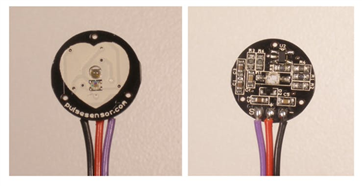

The  sensor is very simple with three legs:
Heart Rate Sensor
• BLACK: Ground
• RED: Input: +3V or +5V
• PURPLE: Signal

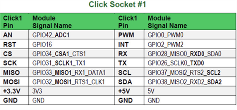

The  Click Socket #1 and the color of the Sensor lead connected to it
• PIN AN - PURPLE lead
• PIN +5V - RED  lead
• PIN GND - BLACK lead
. image
See the pinout table below.  For Pin AN the Name used in code is GPIO42_ADC1

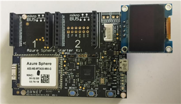

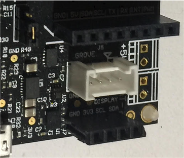

Connecting the OLED Display
You will need to solder a header to the board. This is how I did mine using a 4 pin header I had lying around.
Solder a 4 pin header to the  OLED Display  interface on the board
