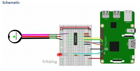

For a NEW project, I am connecting a Heart Rate Sensor that I have from another project to my Avnet MT3620.
The project uses the Raspberry PI and a circuit on a breadboard. The code is written In C.
The circuit (Depicted below), contains an ADC chip that  takes a signal from the heart Sensor into  an analog input pin on the ADC
This  project is working great for me on a Raspberry PI . Here  is the link to the project from the vendor of the Heart Pulse sensor.
https://github.com/WorldFamousElectronics/Raspberry_Pi/blob/master/PulseSensor_C_Pi/PulseSensor_C_Pi.md

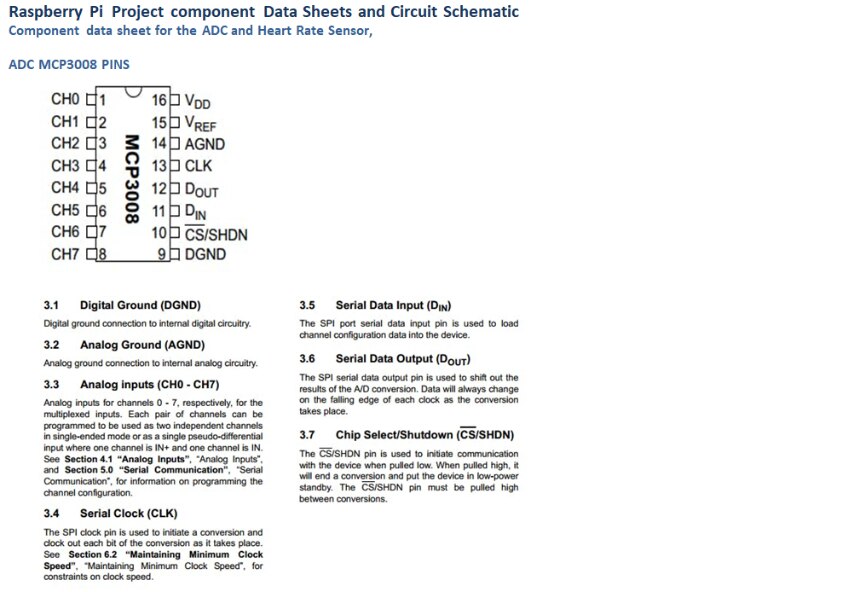

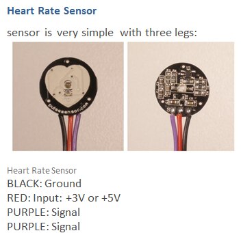

The Sensor and the ADC used are Summarized in the section
  • RasPI Project
For my NEW Project  Beats Per Minute -- Home Is Where the Hack Is Challenge  ,I would hope that I can use this project as an model of How to connect and read a sensor directly to the MT3620 and port the code to the Sphere SDK.
