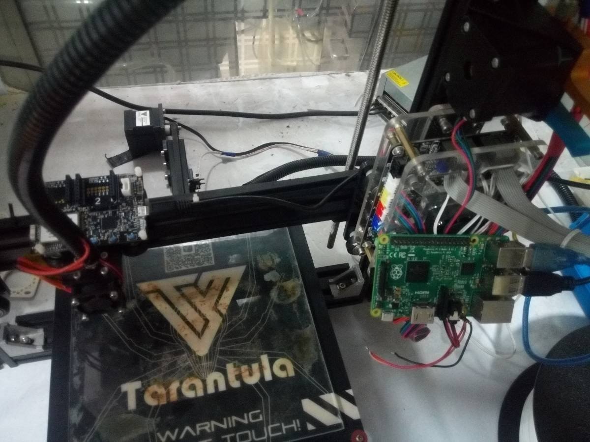

This project would be combining the duos for predictive maintenance of 3D Printer (Tevo Tarantula) through Raspberry Pi3B+ Octoprint server and Avnet Azure Sphere MT3620 Starter Kit.

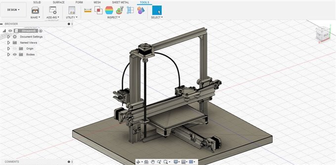

Step 1. Creating a digital twin for 3D Printer;

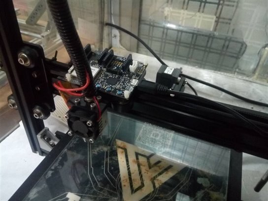

Building an accurate 3D model of Tevo tarantula; and powering the model with IoT data integrated from Azure Sphere IMU and Octoprint server
To build a 3D model of our 3D printer we have modelled each part of the system to our close approximation through Solidworks and Fusion360, collaborating the mechanical, electrical and process engineering to describe and virtually present the physical properties of printer and its components (e.g., vibration, fatigue in x-axis extruder tension belt, wobbling in z-axis, ambient temperature, 3D axis movement, etc.). Then, this 3D model is powered with IoT data fetched from Avnet Azure Sphere MT3620 Starter Kit mounted overboard the X-axis carriage(refer the diagrams for more detail). This data includes records about printer's performance, condition and environment and combines this data with the real-time data obtained from the raspberry powered Octoprint server.

Azure Sphere MT3620 exposes every interface required for the project, here raspberry pi 3/3B+ is connected to the printer via blue USB cable and azure sphere connected through black USB cable, azure sphere logs the raw onboard (IMU) sensor to the azure cloud service, and MKSgen board (spinoff MEGA2560) logs the fine details of 3D printer to RPi powered Octoprint server, the trio devices can be easily powered through the printer's SMPS, while the data can be accessed to local private network.
The entire setup is tried and tested barely, and soon would be revamped with 3D printed custom ABS enclosure.
