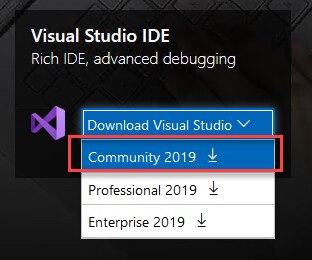

1.2. You will need Visual Studio to install the Azure Sphere SDK and develop applications. You can use Community (free) Edition. Just go to https://visualstudio.microsoft.com/ and install Visual Studio IDE (Community will be OK).
1.3. After downloading the loader here, run it and select Desktop development with C++ and Linux development with C++.

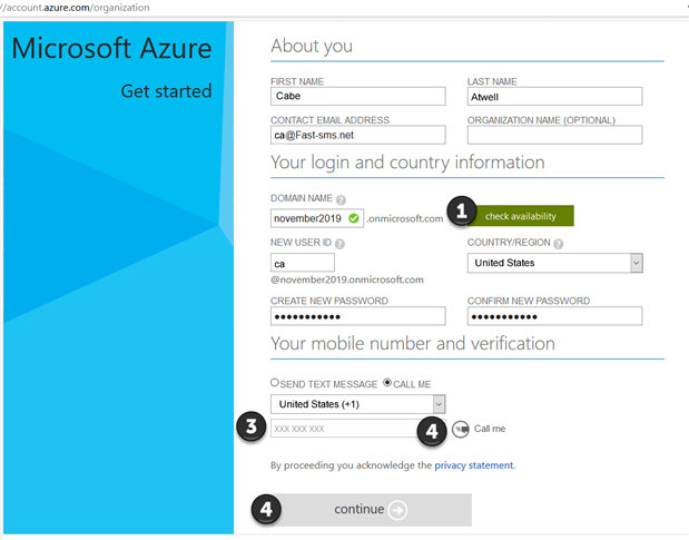

1.5 If you will be creating a new account, please create a new Organization Account (Azure Active Directory) - it is a must for Azure Sphere and you can create it here: https://account.azure.com/organization
Please use the CALL ME option. Sometimes Text Message doesn’t work.

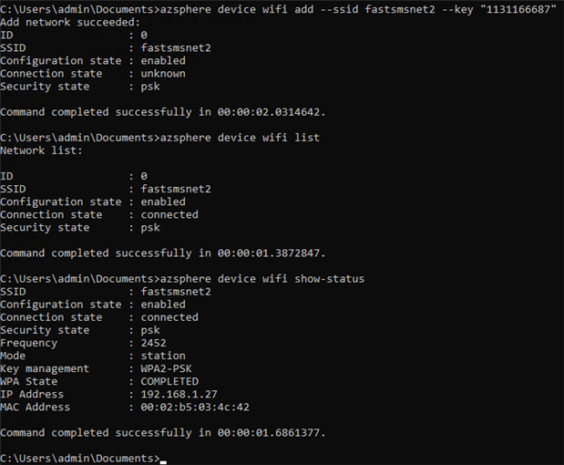

1.13. Now you can connect your device to the internet using:
azsphere device wifi scan
azsphere device wifi add --ssid fastsmsnet2 --key "1131166687"
azsphere device wifi list
azsphere device wifi show-status
If all this worked out for you, move on to Part 2.
