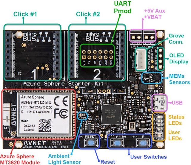

Of course the Azure Sphere Development board from Avnet. A battery pack to power this thing.

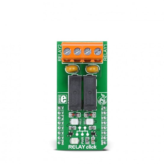

A Relay Click from MicroE

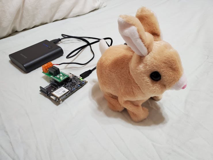

Here's how the whole setup looks like. I connected the controller of the bunny to the relay.

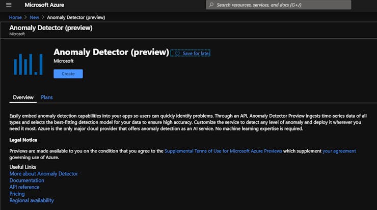

First create a resource in Azure.
I followed the instructions here
https://docs.microsoft.com/en-us/azure/cognitive-services/anomaly-detector/quickstarts/detect-data-anomalies-csharp?tabs=windows
Here's the link to get an API key valid for 7 days.
https://azure.microsoft.com/en-us/try/cognitive-services/#decision

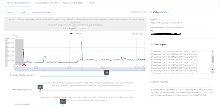

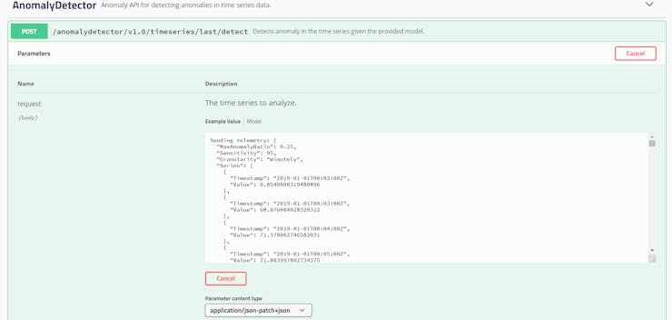

After you get your API key, if you want to try out and test Anomaly Detector API, here's the link https://algoevaluation.azurewebsites.net/#/
Fill in your Key, click on Sample 1, then Start Notice how it's simulating the event, if it finds an anomaly
When you hit stop, look at the Current Response window. It will tell you if the last value is detected to be an anomaly.

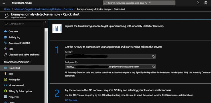

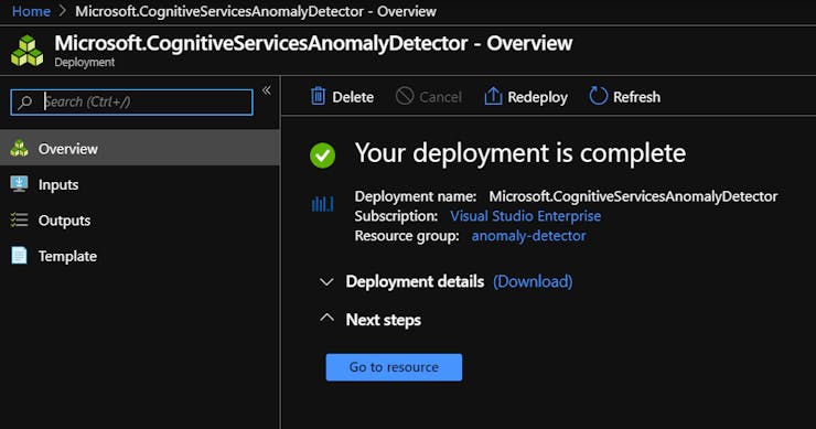

Then you can create your Azure Resource
Click Create -> fill in Name, Subscription, Location, Pricing tier, Resource Group
After it's done, click Go to resource
Then you'll have your api key and endpoint

I create a POST to Anomaly Detector API endpoint. I'm using /anomalydetector/v1.0/timeseries/last/detect
you can test it out on your container too.
The result would look like this. I use parson library to read the json data received from the API. I use the isAnomaly attribute.
"period": 0,
"suggestedWindow": 1441,
"expectedValue": 71.1259994506836,
"upperMargin": 0.74541999816894533,
"lowerMargin": 0.74541999816894533,
"isAnomaly": false,
"isNegativeAnomaly": false,
"isPositiveAnomaly": false
I read the isAnomaly attribute, then set the relayState to set or clear.
