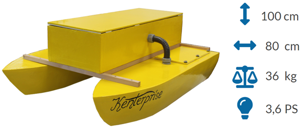

Lets first take a look at the boat from the headline. In the picture below you can see our big yellow Katamaran, the "Kenterprise" (kentern is German for capsizing, that's how much we believed in its floating capabilitiesimage. Luckily it worked out). The Kenterprise is actually not that big, with a length of only 1 m and a width of 80 cm. It is made of Styrofoam, wood, fiberglass and a lot of sweat by 4 of my university colleagues and me. It is meant to monitor the nasty stuff two pictures below, "Cyanobacteria". The boat is mostly done: it features two electric motors, a big lithium ion battery, made from 40 18650 cells, and can be controlled with a remote. It is basically a supersized RC-boat that can carry a fairly heavy payload. This payload is the measuring assembly, which is the focus of this project and not yet functional.

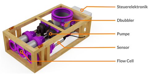

The measuring assembly is the heart of the operation. It consists of 3 smart sensors that measure dissolved oxygen, pH, temperature and the cyano-concentration (by utilizing their fluorescent properties). The sensors run on 12V and offer a Modbus RTU interface.They are each mounted inside a so called "Flow Cell" where the water passes them. Before the water enters the Flow Cells it has to go through a Debubbler. In there the sediment can sink to the bottom, while any air bubbles can move upwards and leave the system through an extra air line. A secondary Pump then proceeds to move the water through the 3 Flow Cells, which are connected in series. The Flow Cells, the Debubbler and the pumps are mounted inside of a wooden frame. By the way, because of our limited project budget, we developed and 3D printed our own Flow Cells and Debubbler, which worked out quite well but they are not quite water tight yet. So far we still haven't gotten to the actual project of this blog, but bare with me we are almost there. On the back of the frame is a gray box that contains all of the electronics. These are not yet working, mostly because we had issues with broken RS485 modules and because we were unable to finish the code in time for the big boat project. Let's take a closer look at the electronics.

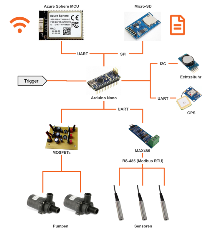

Finally, something electronics related, the control electronics of the measuring assembly. Previously the control electronics consisted of an Arduino Nano that was connected to a bunch of MOSFET's to control the pumps, a MAX485 UART to RS485 Converter, that allows it to talk the sensors and a bunch of modules to get the the time and the GPS position and write it to an SD card. We called this assembly the Data-Logger, although it also controls the pumps.
Whats new in the Overview schematic is the Azure Sphere MT3620 MCU. It is loosely coupled to the Arduino and is supposed to connect the Data-Logger to the Microsoft Azure Cloud. That is why I also refer to it as the "Cloud-Link". The Cloud-Link doesn't do too much work, considering it's performance capabilities. It could in theory replace the Arduino completely. However, as I was not sure, if I would be  able to make it work at all, I decided to loosely couple it to the existing system via UART.

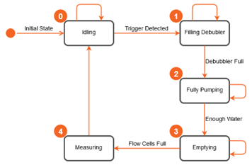

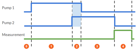

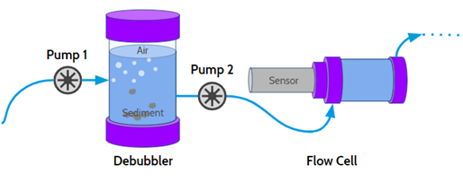

The Data-Loggers state machine is based on the measuring assemblies pumping scheme (left line diagram). Let me give you a quick rundown of the pumping action. Onc the measuring assembly receives a trigger signal [1] it starts filling the Debubbler with water from the lake by turning on pump 1. Based on timers, it decides whether or not the Debubbler is full. [2] Once it is full, pump 2 is turned on to fill the Flow Cells. Note that pump 1 keeps running for some time. That is due to the fact that the Debubblers maximum volume is smaller than the combined volume of the 3 Flow Cells, therefore we need to refill the Debubbler for a little bit to prevent the assembly from running dry. After we have enough water [3] pump 1 is finally shut off and pump 2 keeps running, until the water in each Flow Cell has been replaced with the new probe. [4] Then the sensor measurements are triggered. In this step the Arduino also retrieves the GPS position, as well as the current time, from the GPS module. Even if there are any sensor errors the system returns to the idling state [0] and waits for the next trigger.
This state diagram has been compiled into a big switch statement, that can be seen here. I've got to admit, this is not my nicest piece of code but it serves it's purpose of managing the 5 available states. The source code can also be found in the attachments. It was written using the Atom IDE with the Platform IO plugin installed. That is the reason you will find a main.cpp instead of the usual .ino file.

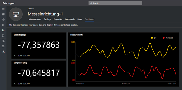

The Result

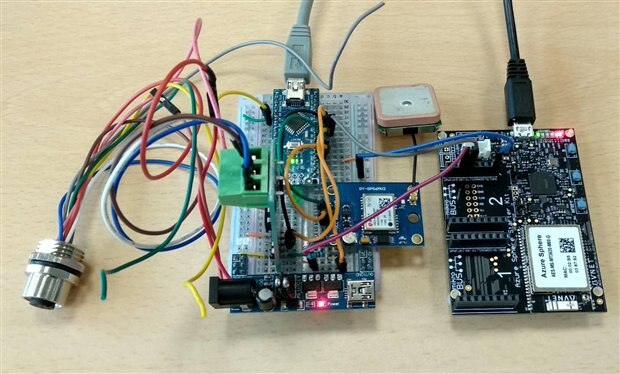

The first picture shows my breadboard-build. On the left you can see the Data-Logger with the Arduino Nano, an M12 Connector for the sensor and a bunch of wires. Three of those go over to the Avnet Azure Sphere Board. Those are GND, SoftRX and SoftTX. The TX coming from the Arduino is reduced to 3.3V by a simple voltage divider, in order to reach the correct logic level for the Azure Sphere Board. The second image shows the pH sensor. To test it I put it into a beer glass filled with cold water.
In the future the boat is supposed to have it's own WiFi hotspot, as of right now I am using my smartphone as a hotspot for the Azure Sphere Board to connect to the internet.
Furthermore you can the that the USB cable is still plugged into the Azure Sphere board. As I didn't have time to find out how to move from debugging mode to a proper OTA deployment.
I left the setup running for an hour with the sensor connected and we got two line graphs for pH and temperature. I didn't grab a screenshot but below you can see the dashboard with simulated data.

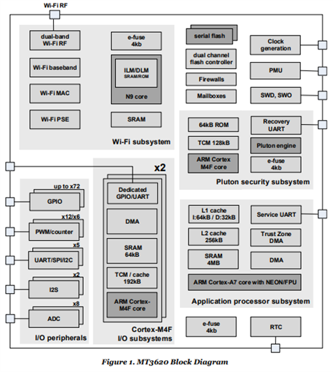

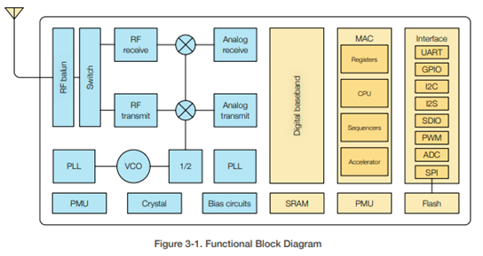

I am also pretty fascinated by the MT3620's. For this project I took dive into the datasheet and the functional diagram. At my university I had to take a closer look at several different MCU's in the past and the MT3620 definitely stands out. From the block diagram below you can see the multiple different subsystems that are actually hardware-separated. The cool thing is that they can work independently. Even if I mess up my application code, the Wi-Fi subsystem will most likely still keep on working and allow me to upload a fixed firmware. The Pluton subsystem offers secure boot, on a microcontroller. How cool is that?
All right I might be a little bit of a hardware geek, but if you take a look at a functional diagram of the ESP8266, which you can see in the second, more colorful image, you can clearly see the difference. By the way, I cut those pictures out of Mediateks and Espressifs respective datasheets.
