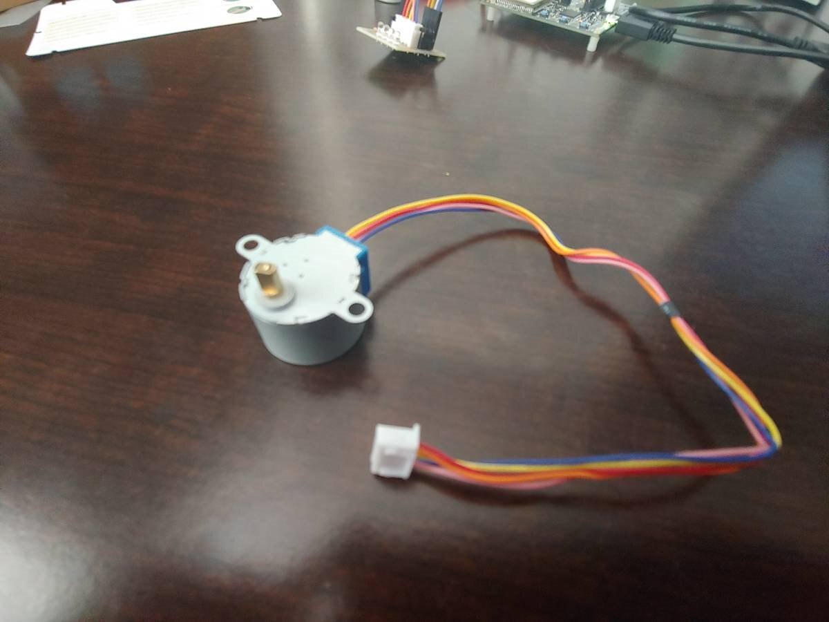

The Stepper motor
The motor we will be using is the 28-BYJ48. It is a commonly found motor in different electronics, machines, and toys. It is also very cheap and from what I can tell very easy to find online.
The science behind the stepper motor is very straight forward. Internally, the central shaft is surrounded in a circular pattern with electromagnets. Periodically the electromagnets are sent an electric charge one after another. They are sent these charges in a sequence known as "steps" This allows the shaft to rotate in very precise fixed positions. The motor we have has a set of four electromagnetic coils. According to the documentation the motor will move a specific distance every step. To complete we a full rotation we implement that number of steps which is (360 / distance in degrees). The style of motor will have a lower speed than a DC motor but will have higher levels of torque and be able to make movement more precisely. The motor also includes 5 wires, one for power and the others assigned to igniting a coil

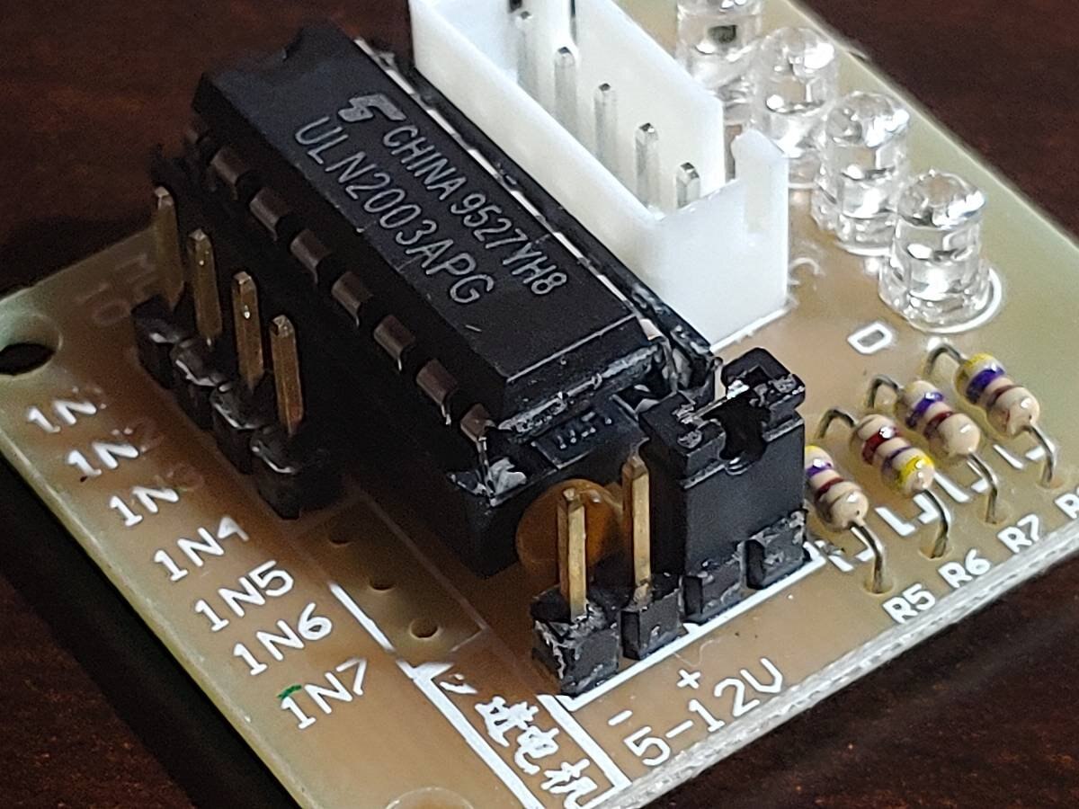

The Motor Driver
We also will use the ULN2003 motor driver. This is a very simple and inexpensive driver that allows us to interface with stepper motor by handling things like supplying power, allowing us a clean way to send signals to the motor, and even giving us visual aid LEDs that light up when we successfully signal to the corresponding coil.

On the motor driver we are going to find the input pins denoted by driver pins labeled IN1,IN2,IN3,IN4
Next we will wire these GPIO pins 31,32,33,34 on the Azure Sphere. We will also connect the ground of our power source to the ground pin. Just like with the Arduino, I would not try to drive motors directly from the power provided from the Azure Sphere. With this small motor it might not be too bad, but it could definitely cause issues with motors that could draw more current.
IN1 = GPIO 32
IN2 = GPIO 33
IN3 = GPIO 31
IN4 = GPIO 34
Take note that the Azure Sphere's pins aren't in exactly sequential order.
Finally we will connect the driver to the power source by plugging the image pin to the positive of our power source and the ground pin image to the ground of our power source
