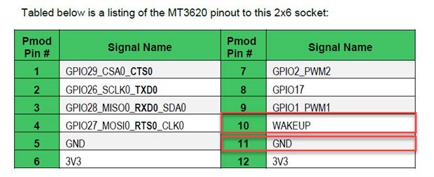

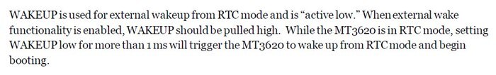

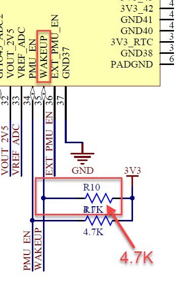

Identify the signals on the Starter Kit to wake the device from an external source
Remember that once the device is in the Power Down state it can wake up on two different conditions.  The first being that a timer expires and the second is that some external input drives WAKEUP low.  We want to see this functionality work so let's identify the signals we need to see this feature in action.
The MediaTek application note states  . . .

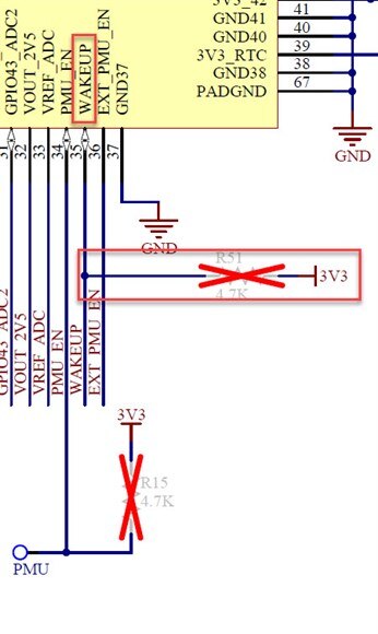

Let's look to see how these connections are implemented on the Avnet Azure Sphere Starter Kit.  The Avnet Starter Kit does not pull WAKEUP high (note that R51 is unpopulated), but the Avnet Module does pull WAKEUP high using a 4.7K resistor.
Starter Kit Signals
Avnet Module Signals

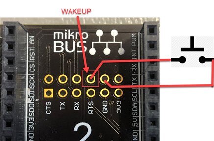

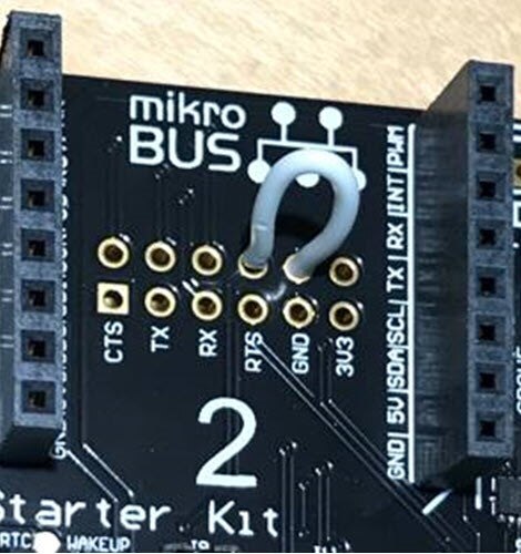

So what do we have to do to trigger an external WAKEUP event?  It's easy, we just need to connect the WAKEUP signal to GRD for more than 1 ms.  This can be accomplished with a jumper wire or my solution I wired a momentary push button switch between WAKEUP and GRD.  When my device is in Power Down mode and I want to wake it up, I just push the button!
The most convenient location to find the WAKEUP signal is on the PMOD connector footprint.  See the details below from the Starter Kit User Guide.

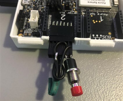

Here's a photo showing where you can find the WAKEUP signal
My switch plugged into a PMOD connector that I added to my board
You can also just short out the two pins like this photo.

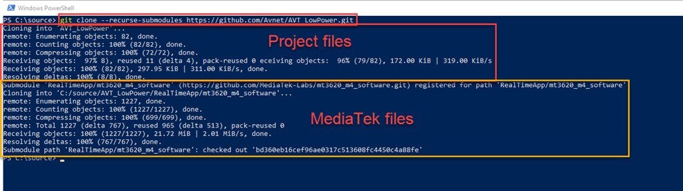

Clone the GitHub Project
A couple things to note when you pull this project . . .
  1. You must clone the git repository from the command line since we need to pass in the --recurse-submodules command line option
  2. The project needs to be pretty close to the root directory on your drive.  If you put the project files too deep into a directory path then the project will not compile and it won't give you any details stating that the path is too long
  • Open Windows PowerShell (or your preferred command line shell)
    • Change to the directory where you want your project files
    • Execute the command: git clone --recurse-submodules https://github.com/Avnet/AVT_LowPower.git

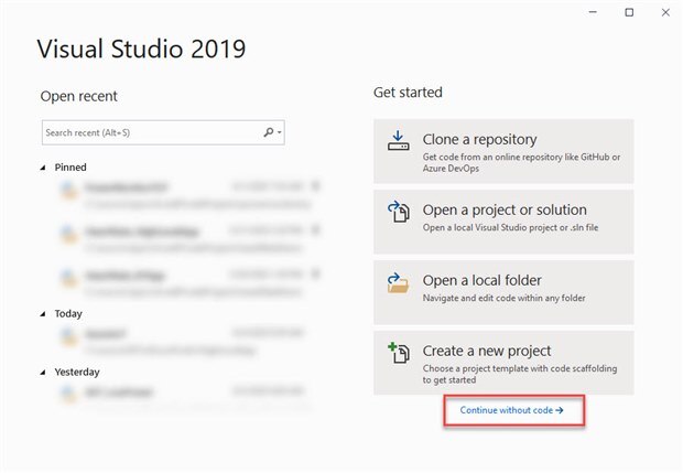

  • Launch Visual Studio
  • Select the "Continue without code" link
  • The Visual Studio IDE will open

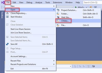

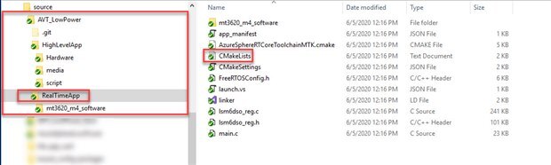

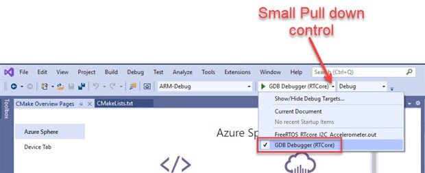

  • Select File --> Open --> CMake from the pull down menus
  • Browse to <your project directory>/AVT_LowPower/RealTimeApp/ and select the CMakeLists.txt file
  • The Visual Studio project opens and CMake will generate the build files
  • Select the GDB Debugger (RTCore) option from the
  • Next build, load and run the real-time application by clicking on the GDB Debugger (RTCore) button
  • The application builds, side-loads and runs.  You should see the yellow USB activity LED flashing fast on your Starter Kit

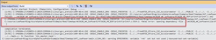

  • If the build fails with an error like the one below, then your path is too long and you need to move your project closer to the root directory on your local drive

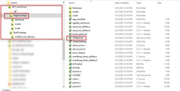

  • Either launch another Visual Studio instance, or select File--> Open --> CMake from the pull down menu from your current Visual Studio instance
  • Use the same process that we used with the M4 application to open the project, only this time select the CMakeLists.txt file from <your project directory>/AzureSphereLowPowerExample/HighLevelApp/AzureIoT directory

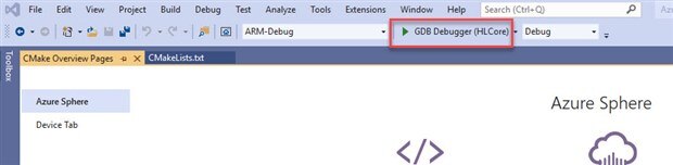

  • Build, side-load and run the High Level project

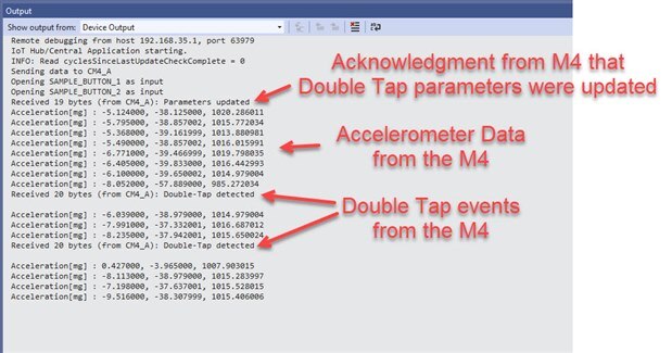

  • Select the "GDB Debugger (HLCore)" target, then click on the "GDB Debugger (HLCore)" button
  • You should see debug similar to the capture below.  Note I generated the Double Tap events by double tapping on my device

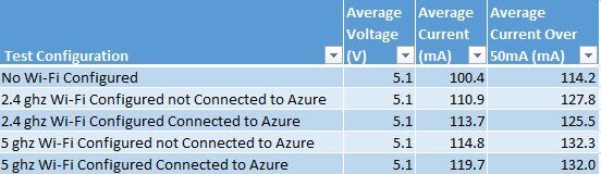

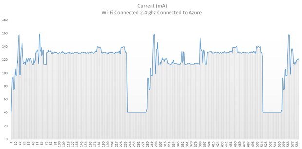

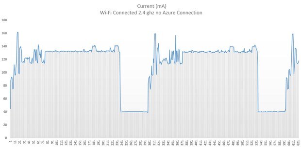

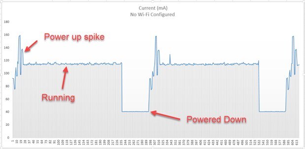

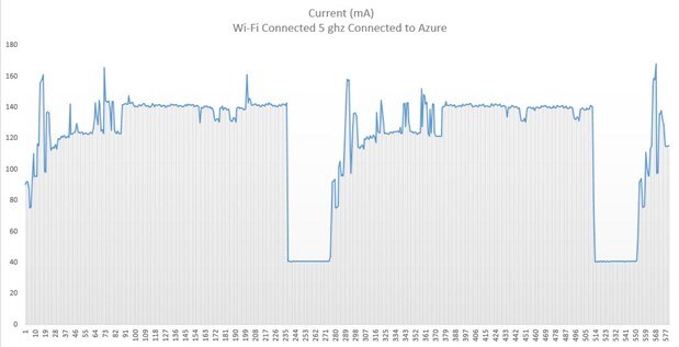

Power Measurements

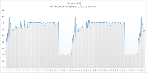

Originally for this section I was just going to measure the power for the simple application to show the current draw of the Avnet Starter Kit executing the Low Power example.  I completed that capture, but then got curious about what the power consumption would look like with different Wi-Fi configurations.  So I ended up measuring the same application in each of the configurations in the table below.  I was a little surprised by the data in this table, I expected the current draw to be a little higher in each of the Azure Connected tests, just because there is data being transmitted.  I think if I created an application that hammered the Wi-Fi with data, the average currents would look a little different.
You can really see how when the Wi-Fi is active the current jumps from ~115mA to ~130mA.  This is really noticeable in the cases where the application connects to Azure.  There is a period at the start of the power-up cycle where the device is maybe crunching on some cryptographic algorithms and the Wi-Fi is held off, then it spikes up.
Here are charts for each test.  I've added comments to the first graph.
Link to my excel spreadsheet with the data and graphs:  Link

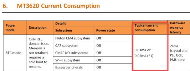

A note on the Power Down current draw
You can see in the graphs that in the Power Down state the board is drawing ~40mA of current.  The MediaTek documentation states that the MT3620 should be drawing ~0.01 mA.  That means that the Starter Kit hardware is consuming most of the 40mA.

  • peterfenn
    peterfenn over 6 years ago +2
    This Starter Kit’s hardware implementation for support of POWERDOWN, was designed prior to the release of support for this low power mode. The MT3620 POWERDOWN mode can be correctly entered, then later…
  • bwilless
    bwilless over 6 years ago +1
    peterfenn had a great idea for an improvement, so I thought I would capture it here. Rather than have the user wait 120 seconds for the MT3620 to go into POWERDOWN, why not just have the user press button…
  • bwilless
    The MT3620 POWERDOWN mode can be correctly entered, then later exited via expired timer or WAKEUP signal events, but the overall implementation on this board has some shortcomings:
    EXT_PMU_EN: The state of this output does not disable the main 5V to 3.3V dc/dc regulator
    Consequently some devices external to the MT3620 Sphere device remain powered and drawing current from the 3.3V rail (eg. the FTDI USB-Serial bridge device)
    WAKEUP: The pullup resistor for this signal is tied to the 3V3 rail instead of the 3V3_RTC rail (this pullup is on the Sphere module, not the Starter Kit)
