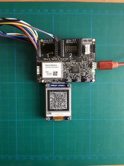

  • The user approaches the IWT device.
  • Then, the user opens the containers door.
  • If the device has no message programmed it shows estimate capacity level.
  • When the door closes the device generates offline a new QR code that contains a signed JWT token, JSON Web Token, including an unique identifier and the date and time of the token issuance.
  • Then the device displays the QR code on a low power consumption E-Paper display.
  • Asynchronously, the device sends an event to the Azure cloud in order to:
    • record and monitor new QR requests
    • record times the container is used
    • record the internal ambient light in the container
    • record the estimate capacity remaining.
  • The user can capture the image with any camera for later validation or can use a specific application that validates the token at the moment.
  • After a configurable time the token disappears from the screen and the device is ready to generate the next token.
  • For loyalty programs the IWT device can issue programmed reward messages from the IOT Central/IOT Hub platform.

  • EPaper display conected in Click 1 (2,3,4,6,7,8).
  • Reed Switch conected to PIN GPIO_42, Click 1-1.
  • SparkFun Proximity Sensor Breakout - 20cm, VCNL4040 (Qwiic)
The hardware consists of an Avnet Azure Sphere MT320 Starter Kit development kit and a Waveshare 1.54inch e-Paper Module electronic ink display.

Waveshare 1.54 inch e-Paper Module electronic ink display
  • The electronic ink screen has been chosen for its good qualities to present QR codes and its reduced power consumption in a project of these characteristics.
  • It is an E-Ink display module, 1.54 inch, 200 x 200 resolution, with embedded controller, communicating via SPI interface, and supports partial refresh.
  • Characteristics: low power consumption, wide viewing angle, clear display without electricity.
1.54inch e-Paper V2 is an Active Matrix Electrophoretic Display (AMEPD), with interface and a reference system design. The 1.54” active area contains 200×200 pixels, and has 1-bit B/W full display capabilities. An integrated circuit contains gate buffer, source buffer, interface, timing control logic, oscillator, DC-DC. SRAM.LUT, VCOM and border are supplied with each panel.
https://www.waveshare.com/wiki/1.54inch_e-Paper_Module
PART NUMBERCOLORSGRAY SCALERESOLUTIONDISPLAY SIZE (MM)OUTLINE DIMENSION (MM)FULL REFRESH TIME (S)PARTIAL REFRESHPI HEADER1INTERFACE
1.54inch e-Paper Moduleblack, white2200x20027.60 × 27.6048.0 × 33.02√×SPI

Click 1 Pinout diagram
This table shows how the pinout on eINK click corresponds to the pinout on the mikroBUSTm socket (the latter shown in the two middle columns).
NotesAVNET KITPinMikrobus logo.pngPinAVNET KITNotes
Reed SwitchGPIO_42AN1ANPWM16D/CGPIO_0Data/Config
ResetGPIO_16RST2RSTINT15BSYGPIO_2Busy indicator
SPI chip selectGPIO_34CS3CSTX14NC
SPI clockGPIO_31SCK4SCKRX13NC
NC5MISOSCL12NC
SPI data inputGPIO_32SDI6MOSISDA11NC
Power supply3V3+3.3V73.3V5V10NC
GroundGNDGND8GNDGND9GNDGround

Creating the JWT Token QR
Anatomy of the JWT Token QR
The device will use QR codes like the one in the nest image:
The QR code contains this string:

This my device: Fullcarga1
