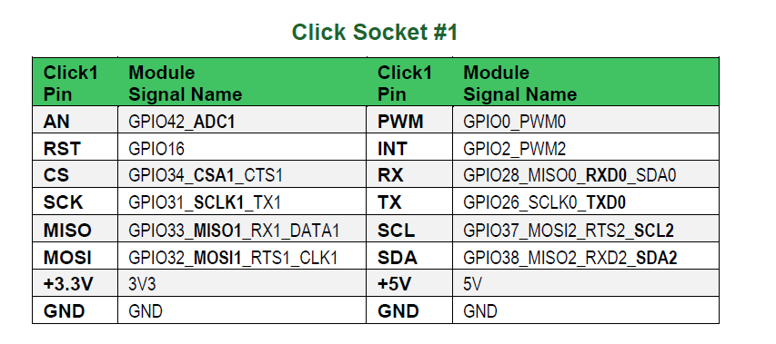

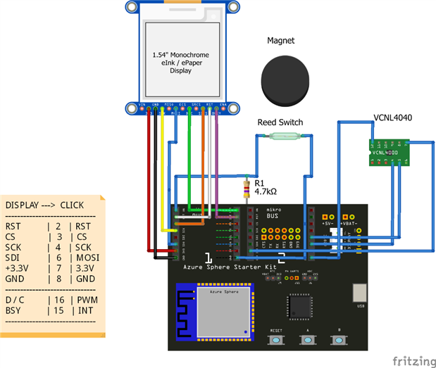

  • EPaper display conected in Click 1 (2,3,4,6,7,8).
  • Reed Switch conected to PIN GPIO_42, Click 1-1.
  • SparkFun Proximity Sensor Breakout - 20cm, VCNL4040 (Qwiic)

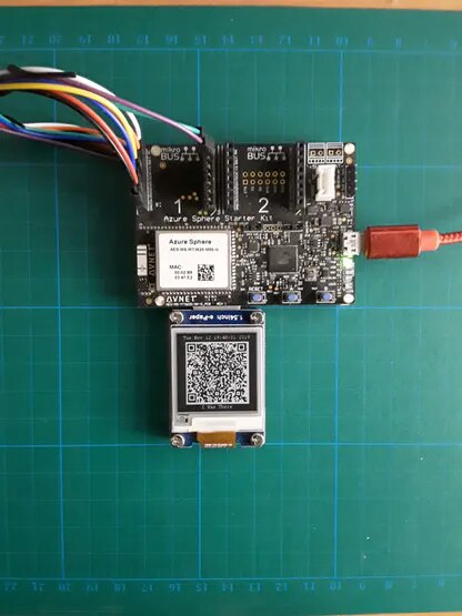

The hardware consists of an Avnet Azure Sphere MT320 Starter Kit development kit and a Waveshare 1.54inch e-Paper Module electronic ink display.

Waveshare 1.54 inch e-Paper Module electronic ink display
  • The electronic ink screen has been chosen for its good qualities to present QR codes and its reduced power consumption in a project of these characteristics.
  • It is an E-Ink display module, 1.54 inch, 200 x 200 resolution, with embedded controller, communicating via SPI interface, and supports partial refresh.
  • Characteristics: low power consumption, wide viewing angle, clear display without electricity.
1.54inch e-Paper V2 is an Active Matrix Electrophoretic Display (AMEPD), with interface and a reference system design. The 1.54” active area contains 200×200 pixels, and has 1-bit B/W full display capabilities. An integrated circuit contains gate buffer, source buffer, interface, timing control logic, oscillator, DC-DC. SRAM.LUT, VCOM and border are supplied with each panel.

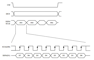

  • Different from the traditional SPI protocol, the data line from the slave to the master is hidden since the device only has a display requirement.
  • CS is slave chip select, when CS is low, the chip is enabled. (CS#) is the chip select input connecting to the MCU. The chip is enabled for MCU communication: only when CS# is pulled LOW.
  • DC is data/command control pin, when DC = 0, write command, when DC = 1, write data. (D/C#) is Data/Command control pin connecting to the MCU. When the pin is pulled HIGH, the data will be interpreted as data. When the pin is pulled LOW, the data will be interpreted as command.
  • SCLK is the SPI communication clock.
  • SDIN is the data line from the master to the slave in SPI communication.
  • (RES#) is reset signal input. The Reset is active low. Note 1.5-4: This pin (BUSY) is Busy state output pin. When Busy is High the operation of chip should not be interrupted and any commands should not be issued to the module. The driver IC will put Busy pin High when the driver IC is working such as: - Outputting display waveform; or - Communicating with digital temperature.
  • (BS1) is for 3-line SPI or 4-line SPI selection. When it is “Low”, 4-line SPI is selected. When it is “High”, 3-line SPI (9 bits SPI) is selected.
SPI communication has data transfer timing, which is combined by CPHA and CPOL.
  • 1. CPOL determines the level of the serial synchronous clock at idle state. When CPOL = 0, the level is Low. However, CPOL has little effect to the transmission.
  • 2. CPHA determines whether data is collected at the first clock edge or at the second clock edge of serial synchronous clock; when CPHL = 0, data is collected at the first clock edge.
There are 4 SPI communication modes. SPI0 is commonly used, in which CPHL = 0, CPOL = 0.
Data transmission starts at the first falling edge of SCLK, and 8 bits of data are transferred in one clock cycle. In here, SPI0 is in used, and data is transferred by bits, MSB first.
Click 1 Pinout diagram
This table shows how the pinout on eINK click corresponds to the pinout on the mikroBUSTm socket (the latter shown in the two middle columns).
NotesAVNET KITPinMikrobus logo.pngPinAVNET KITNotes
Reed SwitchGPIO_42AN1ANPWM16D/CGPIO_0Data/Config
ResetGPIO_16RST2RSTINT15BSYGPIO_2Busy indicator
SPI chip selectGPIO_34CS3CSTX14NC
SPI clockGPIO_31SCK4SCKRX13NC
NC5MISOSCL12NC
SPI data inputGPIO_32SDI6MOSISDA11NC
Power supply3V3+3.3V73.3V5V10NC
GroundGNDGND8GNDGND9GNDGround

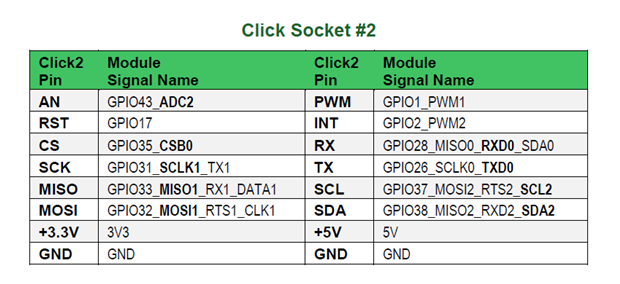

Click 2 Pinout diagram
This table shows how the pinout for the VCNL4040 Proximity Sensor corresponds to the pinout on the mikroBUSTm socket (the latter shown in the two middle columns).
NotesPinMikrobus logo.pngPinNotes
NC1ANPWM16NC
Interrupt output
GPIO17
RST2RSTINT15INT
NC3CSRX14NC
NC4SCKTX13NC
NC5MISOSCL12SCL
I2C Clock
SCL2
NC6MOSISDA11SDA
I2C Data
SDA2
Power Supply3.3V73.3V5V10NC
        GroundGND8GNDGND9GNDGround

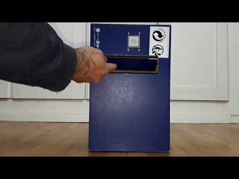

Reed Switch and Magnet
The magnet is behind the door.
The circuit is closed when a magnet is near the switch, indicating the opening is shut. Opening the door breaks the connection.
Sensing the user
In addition to launching the new QR code when the button is pressed, we can activate it when it detects when the user using the recycling container using a proximity sensor.
  • The reed switch we'll be using is normally-open. We have two alternatives to detect when the door is fully closed o when the door is fully opened. For this project we will be using the first alternative:
  • Detect door fully closed: The magnet is close the Reed Switch when the door is closed and will be in that state until the door is opened. We connect the Reed Switch to ground and we will pull up the GPIO pin 42 via 4.7K. In closed stated will read Low. The event for a new QR will be sent when passing from High to Low, that is when the door is fully closed again, rewarding the user for closing the door image after use.

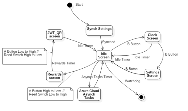

Software Design
State Diagram
  • Idle show the "Press A"
  • Rewards show reward associated to the QR if any
  • JWT_QR issue and show new QR Token
  • Clock show time clock
  • Settings show settings
  • Synch Settings sync settings with Azure cloud
  • Azure Cloud Async Tasks send/receive/synch cloud data

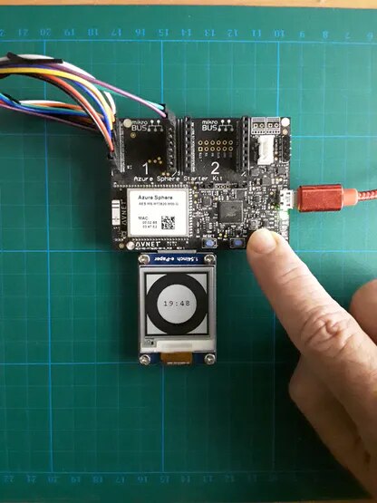

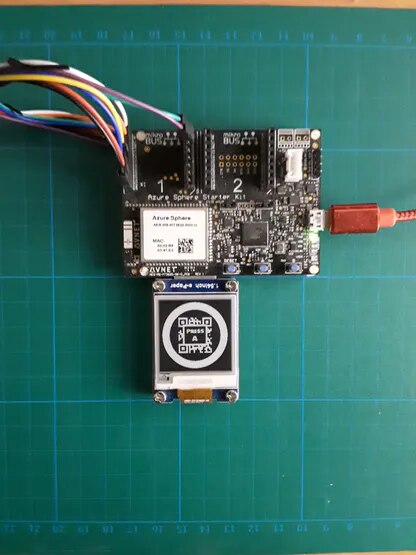

Idle Screen: During the Idle state the screen shows the indication of pressing the A button to obtain a new QR

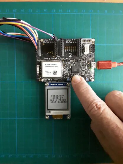

Rewards Screen: Once button A has been pressed if a new prize status was received for the next QR, the prize associated to the QR is displayed. Option for customer loyalty programs.
QR Screen: Then the new QR code containing a signed JWT token. A time set from the Azure cloud will be in this state.
Clock Screen & Settings: When the B button is pressed, a clock with the current time of the device is displayed and if pressed again the application settings are displayed.

The device will use QR codes like the one in the nest image:
The QR code contains this string:
eyJhbGciOiJIUzI1NiIsInR5cCI6IkpXVCJ9
.eyJqdGkiOiJlMmRhNzc3My1hN2NkLTQ0YTAtODVkNy00M2ZlMDY1NGNiMjItN2RjNTQ4MTEtNWRjYjBjNzAiLCJpYXQiOjE1NzM1ODgwODB9
.Dm8qKzv5n0EHMCcIECn08Ev_eppzPNc-hGtuICCNGK0
It is a JSON Web Token in its compact form. A JWT typically looks like the following: xxxxx.yyyyy.zzzzz

Programming new messages to show
  1. New award or information messages can be programmed from IoT Central or completely disabled.

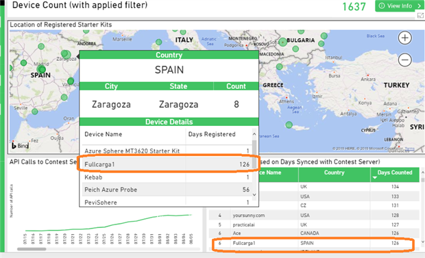

This my device: Fullcarga1
