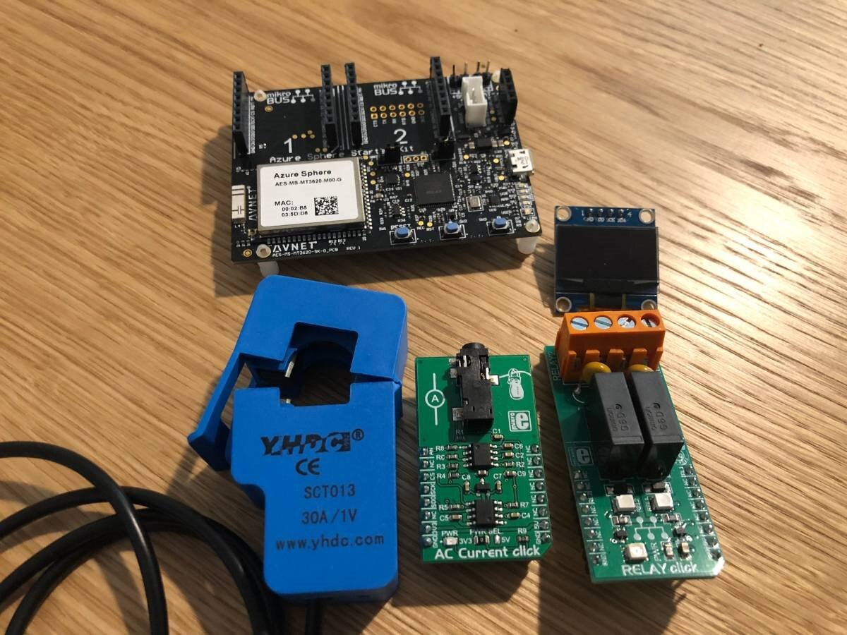

Devices
This is a list of devices I will use to build MeasureBridge.
  1. Azure sphere MT3620 Starter Kit
  2. AC Current click board + AC Sensor
  3. RELAY click board
  4. OLED 0.96" I2C 128x64 display
  5. Power supply - Hi-Link HLK-PM01 100V-240VAC / 5VDC - 0,6A (not included in that picture)

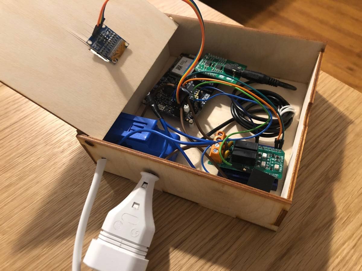

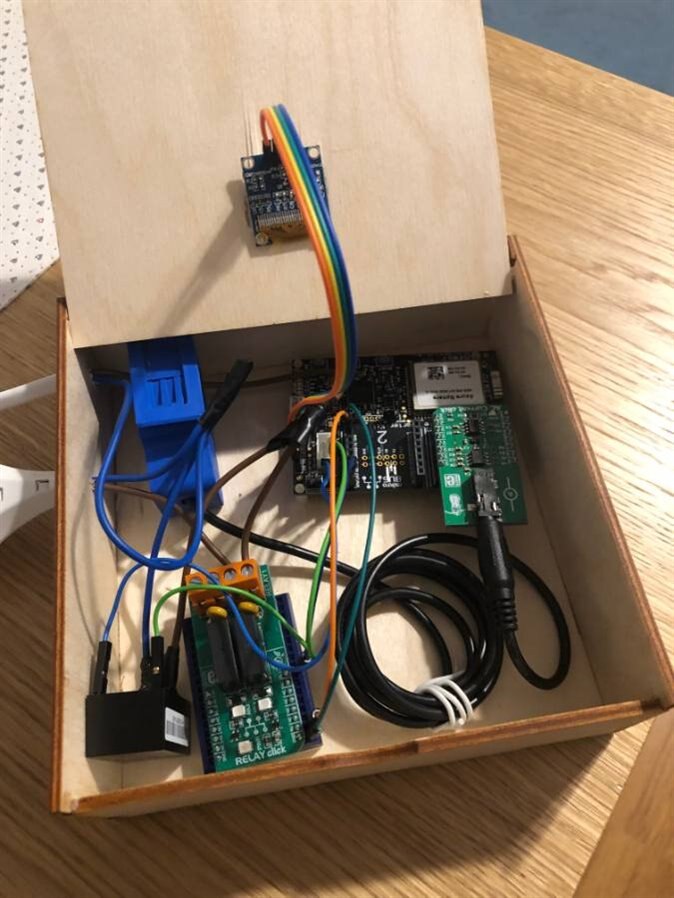

  • Put it all in nice wooden box image
As you saw in the device list, I want to use MikroE Click boards to measure the current and also to control the connected device.

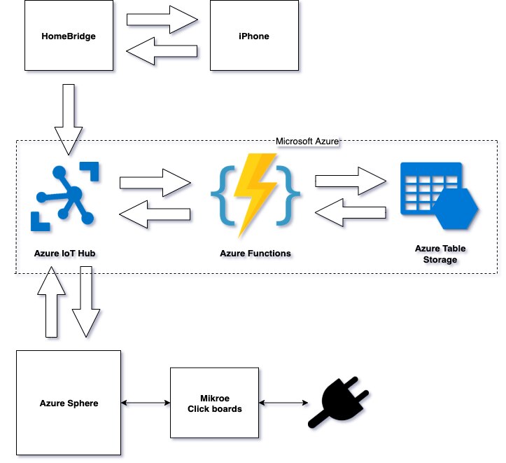

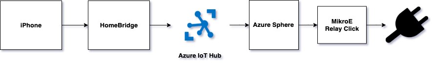

Architecture and project structure
As you can see below there is a project structure. Starting from the top there is a HomeBridge server installed on RaspberryPi. It's a gateway between iPhone and Microsoft Azure. More about HomeBridge later on.
Next there are services from Microsoft Azure:

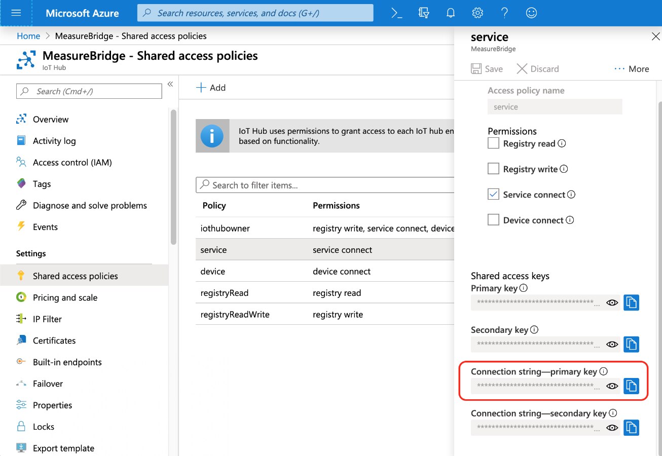

  • Azure IoT Hub - used to communicate with Azure Sphere
  • Azure Functions - used to
    • capture messages send from Azure Sphere device
    • calculate energy consumption and send it back to Azure Sphere
  • Azure Table Storage - used to store data from Azure Sphere and Azure Functions
The last but not least we have Azure Sphere device (Azure sphere MT3620 Starter Kit) and MikroE Click Boards.

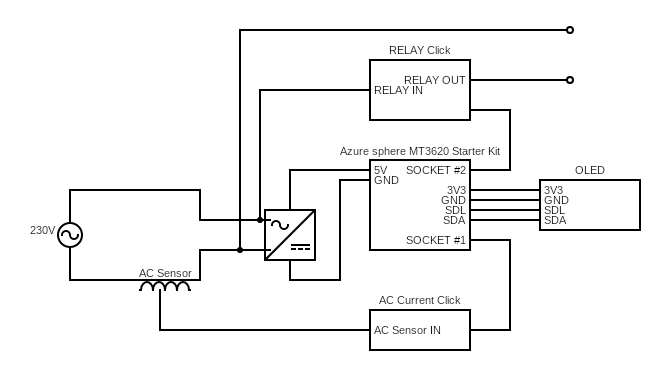

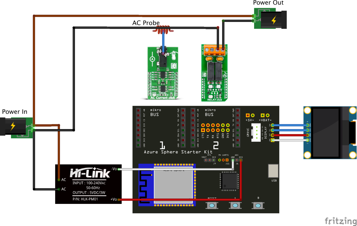

Circuit diagram
{gallery} Circuit diagram
Breadboard schematics
Connection schematics

  • Create Azure IoT Hub and add a new IoT Device

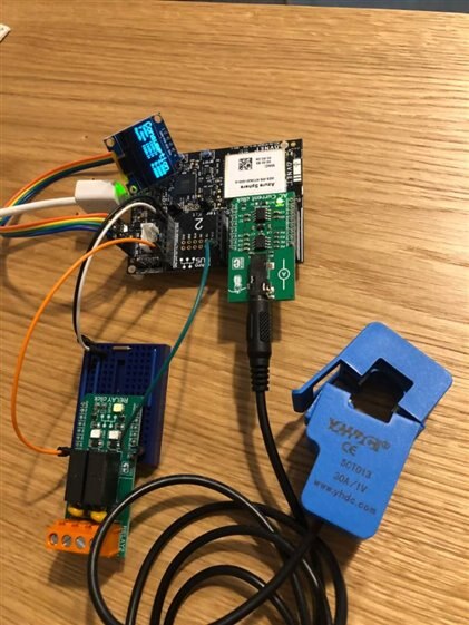

MikroE Click boards were attached into ClickModule 1 and ClickModule 2. However I had some issues connecting Relay Click board to the Click Module 2 - because if SPI or i2c initialization process the relay was switching on and off during startup. It's not safe to immediately turn on and off electric devices so I decided to not plug that module directly. Instead I've used small breadboard and then connect it to the Avnet Sphere.
The display is connected to the OLED connector on the Avnet Sphere board.

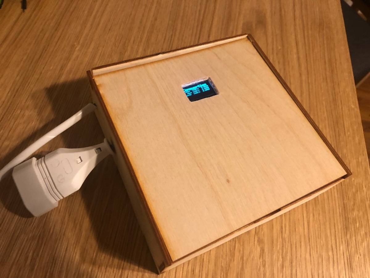

OLED display
Product link: https://www.amazon.com/gp/product/B072Q2X2LL/ (mine has blue display)
I used a blue OLED display that is 0.96" wide. It's based on the SSD1306 driver and it supports i2c communication.
There is a good blog post on how to use it here. I used the library from the example (https://github.com/CloudConnectKits/Azure_Sphere_SK_ADC_RTApp/blob/master/AvnetAzureSphereSK_OLED/AvnetStarterKitReferen… ) to communicate with the OLED display. The idea is to display:
  • Current [A]
  • Energy [kWh]
  • State of the relay [On/Off]
  • Time since the relay was turned on
You can see below the code responsible for what is displayed on the OLED. It is a state machine which is really easy to control. You have oled_state variable which you need to set to display desirable scene. I decided not to use any buttons in the project. So every couple of seconds I'm increasing the oled_state to switch to the next scene.
At the bottom there are some functions that converts number into string.

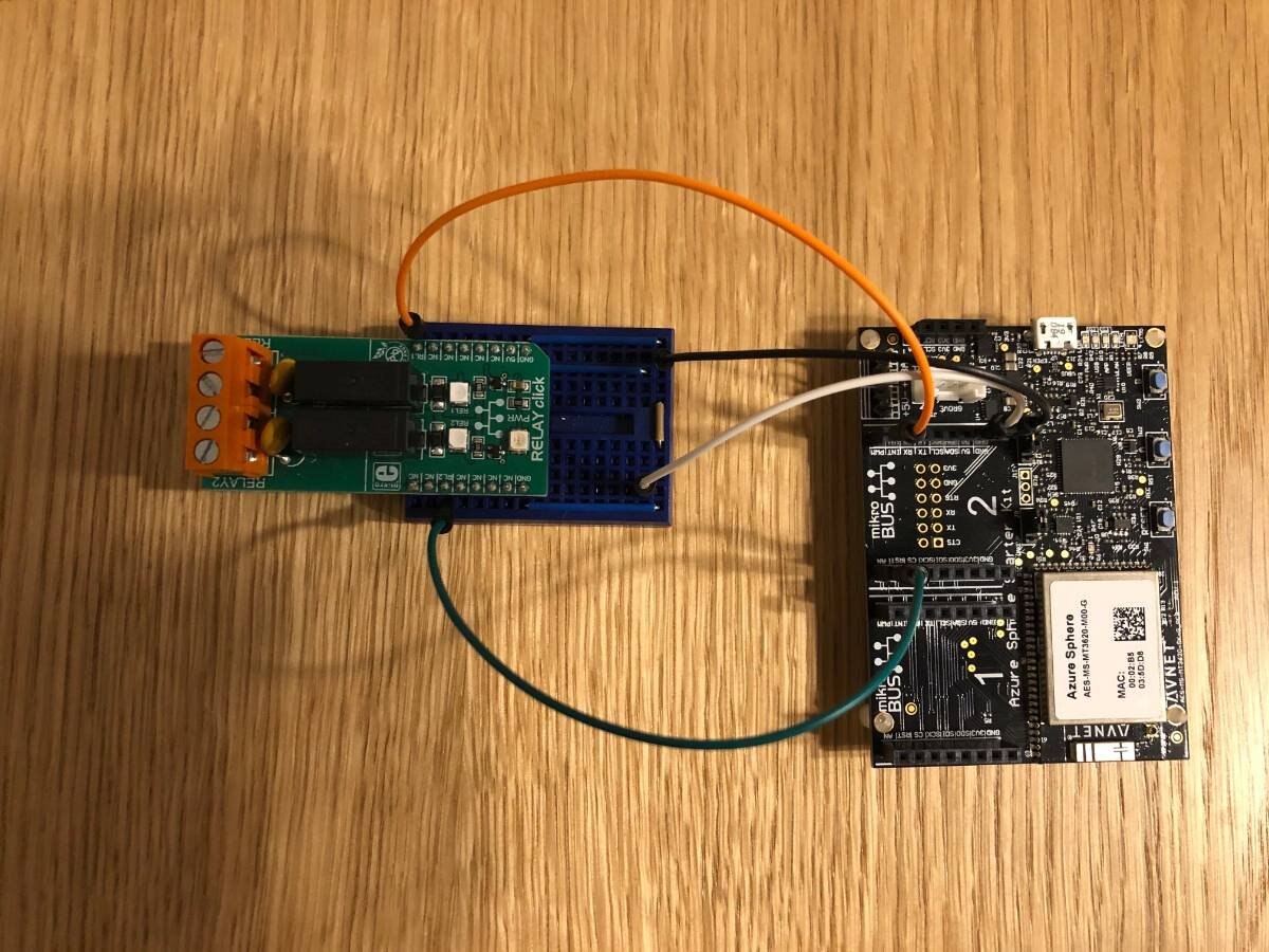

MikroE Relay click
Product link: https://www.mikroe.com/relay-click
Relay Click board offers an elegant and easy way for controlling a wide range of electric devices. There are two relays on the board and each can be in opened or closed state. When the relay is in the closed switch state the current flows through it.
Avnet Sphere supports two MikroE click-boards - ClickModule #1 and #2. As I mentioned at the begging, I've connected the Relay Click to the ClickModule #2, but not directly.
Relay Click module is really easy to use. You have two relays that can be controlled. All you need to do is to set hight or a low state on one of the inputs: CS for Relay1 and PWM for Relay2.

HomeBridge
I have couple of HomeKit accessories in my apartment. As you probably know, it is a way of making you home smart. However, some devices are not compatible with Apple HomeKit. But there is also a solution for that - HomeBidge. HomeBridge is a lightweight NodeJS server that emulates the iOS HomeKit API. It supports plugins - modules that provide a basic bridge from HomeKit to various devices. I have HomeBridge server installed on the RaspberryPi 3b.
One of the project goals was to be able to turn on and off the electric device connect to the MeasureBridge. The device is turned on/off by MikroE Relay click board. I used device twin properties to control state of the relay. Microsoft provides SDK for NodeJs, so I decided to create a homebridge plugin. The plugin updates the desired of twin properties on the Azure IoT Hub. Then hub sends twin properties to the AzureSphere device. At the end, the device is opening or closing the relay.

You have to specify couple of things first in the HomeBtidge config.json file
  • name - name of the device to display in the Home app
  • connectionString - connection string to the Azure IoT Hub Shared Access service
  • targetDevice - name of you Azure IoT Device
  • deviceTwinName - name of the twin property

Now let's connect an electric device and test it.
Summary
So I had a lot of fun building that device and cool that it worked at the end image It was very challenging for me, specially a part getting value of alternating current from MikroE AC Current Click board.
