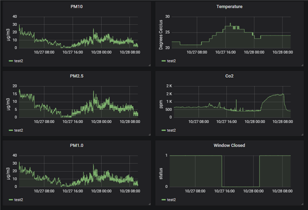

Based on my end result, I had a time series plot of dust, temperature, CO2 and whether my window was open at the time.

And congratulations. After all of that you now have a dashboard that lets you view your IOT device.
You can change the time period you look at through the top bar.
Taking a look at ~ 1 weeks worth of data, it looks as though the CO2 levels go above 2000 ppm which may not be ideal.
I notice that dust is less of an issue than I thought it would be, there are some period where I am breaching the WHO air quality guidelines but in general it seems like the values are reasonably good.
I can see the immediate effect of opening my window, although curiously soon after closing it again the CO2 readings begin to spike up, leading me to believe that my sensor may be too close to the window.
I can also see that keeping my window open when I sleep causes CO2 PPM to never rise even close to the levels it got to before, which should not be a surprise.
