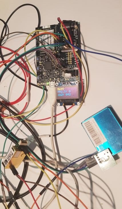

I'll probably be the first to admit that I spend way too much time in my room with my door and window shut, either coding or sleeping. Recently, I saw “This Is Your Brain On Stale Air” by Tom Scott and it has made me consider what kind of effect this is having on my, being in an enclosed space for a large amount of time. To figure this out, I wanted to get a rough idea of air quality in my room, in terms of CO2 (because I spend a lot of time there) and dust (because of allergies). I used the Sensing the World Challenge as an excuse to sense the air quality of my room to see whether I should be concerned, or start opening a window more often. I wanted to create a system with the Azure Sphere that would be able to capture and display data on a time series plot with some indication of whether my window was open, the current CO2 levels and current dust levels.
Thankfully despite my horrible dupont line wiring, the Azure Sphere was able to gather the required information.
Based on my end result, I had a time series plot of dust, temperature, CO2 and whether my window was open at the time.

I read the PMS-7003 and MH-Z19 dust senors using two of the Azure Spheres ISUs set to UART mode (ISUI0 & ISU1), leaving ISU2 to be set to I2C mode to drive on OLED screen which gives basic PM5 and CO2 readouts. I get information about whether my window is open or closed by reading a reed switch that's attached to one of the GPIO pins.
The data from these sensors then gets sent to Azure IOT Hub. An Azure function processes the telemetry messages and dumps the data to an Azure hosted SQL database. Grafana uses the data in this SQL database to provide an interactive dashboard to see dust levels, CO2 levels and whether my window is currently open in one place.
While I don't currently utilize this feature, I also update the devices digital twin model with the current sensor readings. I had originally planned to do something with this information but ran out of time.

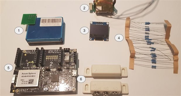

Parts List
  1. PMS-7003 Dust Sensor
  2. MH-Z19 CO2 Sensor
  3. OLED screen
  4. 10K resistor
  5. Azure Sphere MT3620 Starter Kit
  6. Reed Switch
Parts Choice
It looked like there were a lot of cheap sensors that claim to be accurate at measuring CO2, but looking at reviews online they seemed to be very questionable. I chose the MH-Z19 CO2 sensor because it was one of the cheaper NDIR sensors that had the ability to automatically calibrate itself in fresh air, it also happened to be one of the sensors visible in that Tom Scott video.
I chose the PMS-7003 because it was one of the cheaper Dust sensors that was capable of measuring PM 2.5, PM 5.0, PM 10 that I could find with some long term data to back it up and seemed to be reasonably accurate for my purposes.

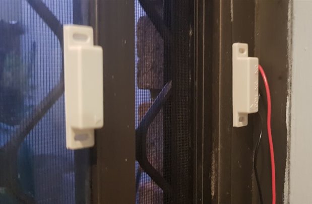

I picked the first reed switch that I could pick up at my local electronics store, as I did not plan that part out very well (originally I was using a hall effect sensor, but I realized that what I was after was probably a solved problem and commercial product) and left it as a late addition to the project. This reed switch had a normally open or normally closed mode so I could select this in hardware rather than software. I used this in normally open mode with a 10k pulldown resistor to make sure I didn't get a floating input. The OLED screen was one that I had laying around from another project.If I were to do this project again, I would probably buy a slightly larger screen as I found the character limit was quite restrictive.
As this was made for an Azure Sphere competition, it would probably be a pretty good idea to include the Avnet Azure Sphere Starter Kit (Thanks Danzima).
Of course, any guide involving sensors needs to come with a disclaimer. These sensors have not been calibrated by a professional and I have not yet generated enough data to prove their accuracy, precision or sensitivity. The readings that you get from them should be treated as a rough guide.

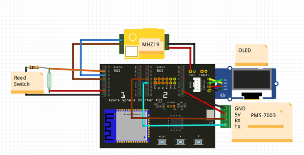

Wiring Guide
(Diagram made with Fritzing using the Azure Sphere model by vanepp)

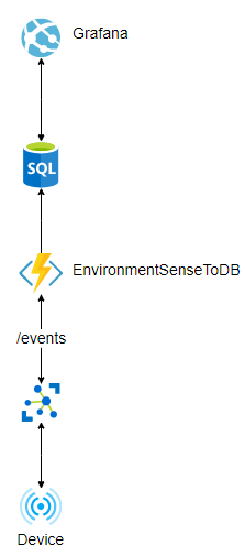

Data Flow
  • Data flows from the Device to the IOT Hub through digital twin updates and telemetry messages.
  • These messages are then picked up from the IOT Hub the /events topic by an Azure Function App (EnvironmentSenseToDB) which then get put into the required SQL tables.
  • Grafana is then used as a visualization layer for this data.

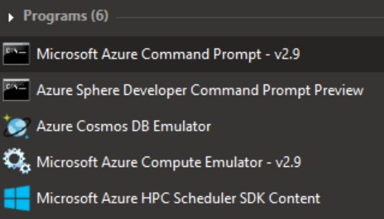

Install Azure Sphere SDK for your required version of VS Code (2017 or 2019)
Once this is done you will find that you have the Microsoft Azure Sphere Developer Command Prompt Preview.
In the Sphere Developer Command Prompt, enable the Azure IOT Hub extension

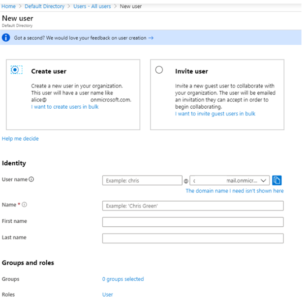

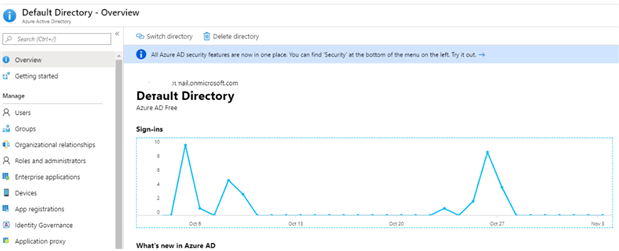

If your login fails with a message similar to “identity provider 'live.com' does not exist in tenant 'OsTechnology'", you'll need to create an active directory account in Azure.
Log in to your Azure Portal (https://portal.azure.com/) and select Active Directory.
Select "Users"
Create a new user under "Users". This user will not require any roles.
Note: Based on the comments on the 19.10 release, it looks like these steps won't be required for a non enterprise AD account. I haven't had a chance to test this release.
Run azsphere device claim and log in as this new user. You may need to create a new tenant with tenant create --name “Name of your tennant”.

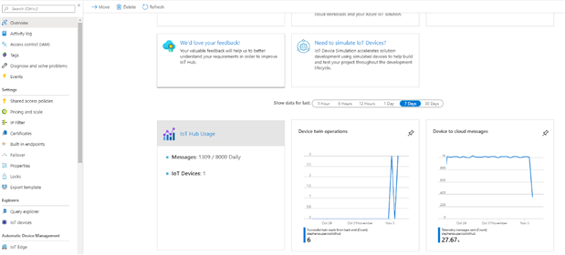

You should also see that you start getting "Device to Cloud Messages" through your IOT Hub.
You can also view the exact content of the messages that arrive in your IOT Hub by downloading the Azure IOT Explorer.

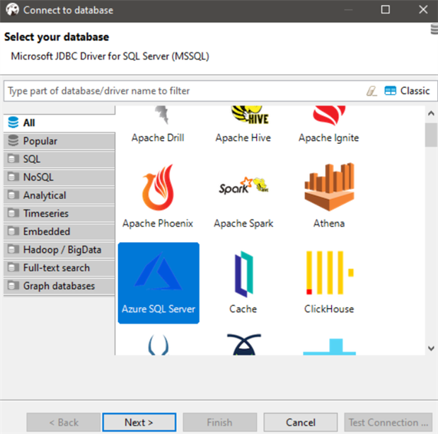

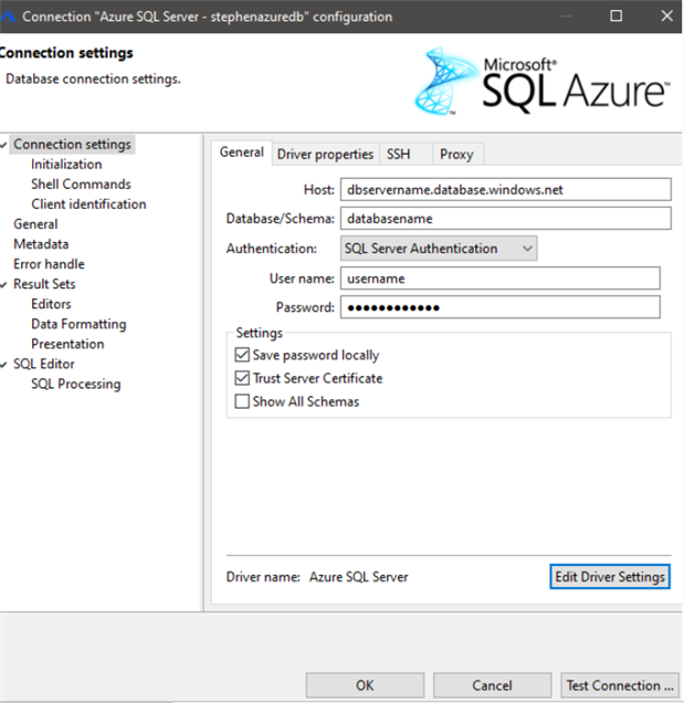

To manage the SQL server, download Dbeaver an open source database management tool and add a new Azure SQL Server connection
And enter your login credentials
To create the required tables, change yourdb name in the following SQL script to create the required tables.

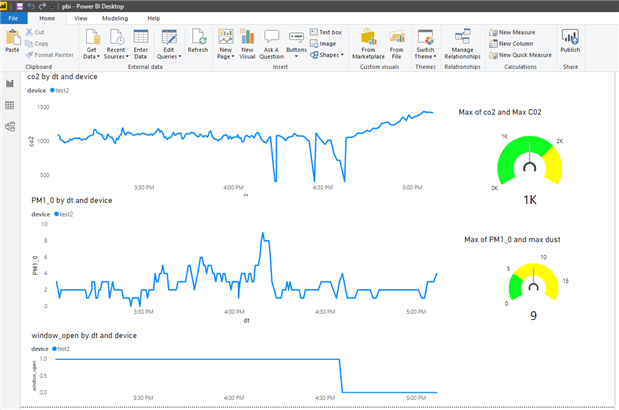

The choice to save datetimes as varchars probably seems a bit strange if you've done some SQL before, as it would probably be more efficent to save them as unix epoch times and you'd be right. Originally I was going to use PowerBI as my presentation layer, which can easily convert datetime strings to an accepted datetime format. While I built my original dashboard in PowerBI, I ultimately thought that the licencing for it (limited trial period) would be too limiting for hobbyist use, so I ended up switching to an open source presentation layer (Grafana).
Old power BI dashboard during initial tests.

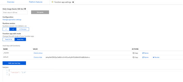

Set up the required environment variables
az functionapp config appsettings set \
--name {function app name} \
--resource-group {group name} \
--settings "MyConn={result from az iot hub device-identity show-connection-string command} DBConn={result from sql db show-connection-string}"

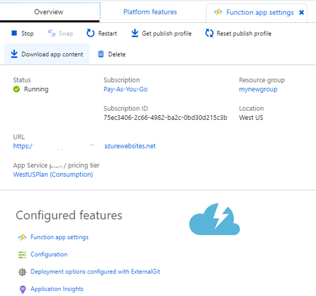

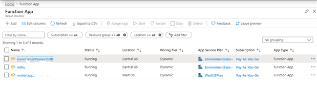

Monitor it through Azure Functions to check that it's working. Select the function app you're after.
And hit Monitor.
Check that your function is running correctly, then check that data is appearing in your SQL server with DBeaver.

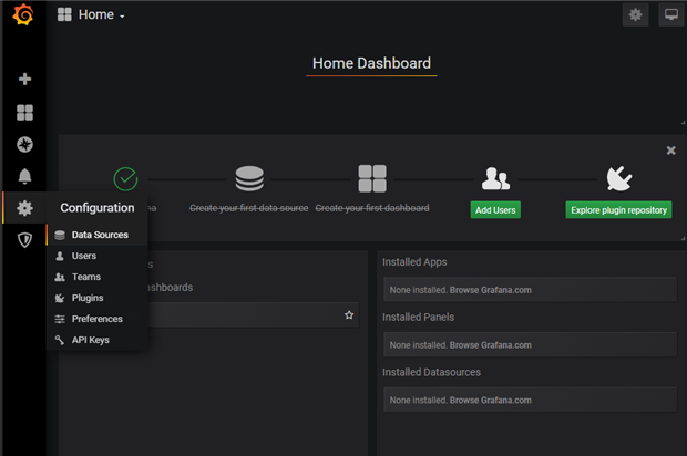

Grafana
To keep this guide short, I will be running Grafana locally, so download it for your required distribution here. Once installed you will be able to connect to it by visiting http://localhost:3000 in your web browser.
If you want to run Grafana to have it accessible over the internet, I'd suggest you follow this great guide by l by Jamie Phillips on how to run Grafana in Azure App Service.
The remainder of the steps are applicable to both cases.

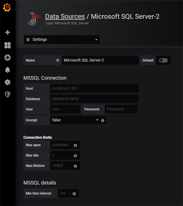

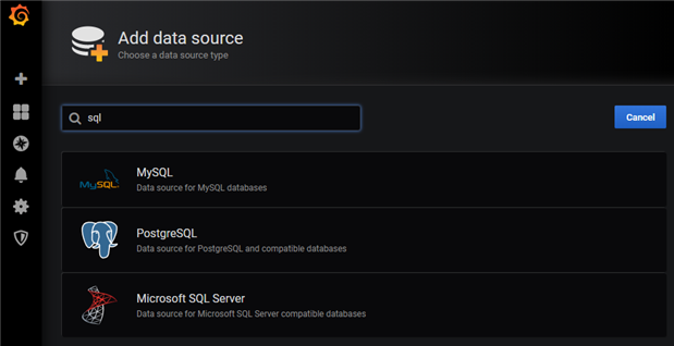

Add your database through "Data Sources".
Select Microsoft SQL Server.
Enter your database credentials (Host, Database, User, Password, Encrypt and give this connection a name). The rest of the values can be left as their defaults.

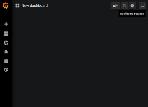

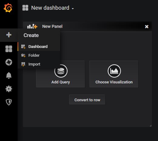

Create a new dashboard.
Go to dashboard settings.
You can copy the dashboard with the grafanaconfig.json file found here

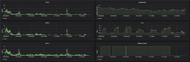

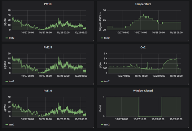

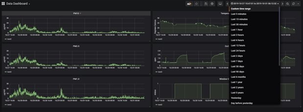

And congratulations. After all of that you now have a dashboard that lets you view your IOT device.
You can change the time period you look at through the top bar.
Taking a look at ~ 1 weeks worth of data, it looks as though the CO2 levels go above 2000 ppm which may not be ideal.
I notice that dust is less of an issue than I thought it would be, there are some period where I am breaching the WHO air quality guidelines but in general it seems like the values are reasonably good.
I can see the immediate effect of opening my window, although curiously soon after closing it again the CO2 readings begin to spike up, leading me to believe that my sensor may be too close to the window.
I can also see that keeping my window open when I sleep causes CO2 PPM to never rise even close to the levels it got to before, which should not be a surprise.

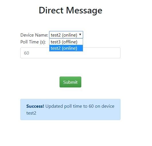

Implementing Direct Methods
With my main goal done, I wanted to try something extra based on the example in Implementing Direct Methods in Azure Sphere: I wanted to have a convenient way to change the sensors polling time, and have that persist between reboots. I also wanted to extend that tutorial by providing a nice UI to call the direct methods rather than relying on logging into the Azure Web Portal to use its direct method invoking portal.
My chosen implementation of this uses the direct methods to store a polling period value in the Azure Spheres mutable storage, to change sensor polling time without having to modify the devices code.
This is entirely unnecessary if you're goal is just to pull some sensor data from an azure sphere and show it in a visualization tool, but I thought it was pretty neat so went ahead and implemented it.
az functionapp config appsettings set --name {function app name} \
You'll need to grab your Azure Function host key to allow your application to access your API. There is a much better way to do this in code, but it's best explained by the original author.
Go to your Function App Settings image

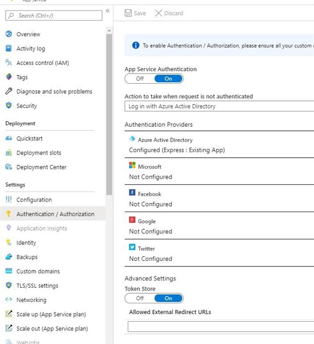

Finally secure this front end with Azure Active Directory by going to your web application, selecting Authentication/Authorization and enabling active directory with express configuration.
And you should be done! Visit your Azure App service URL, log in with an email within your Azure Active Directory account and you should be good to go!
Device names and their statuses will appear, select an online device and change that poll time!

    Here's a runthrough of me changing the polling time
    And here's me showing the values changing when I open my window.
