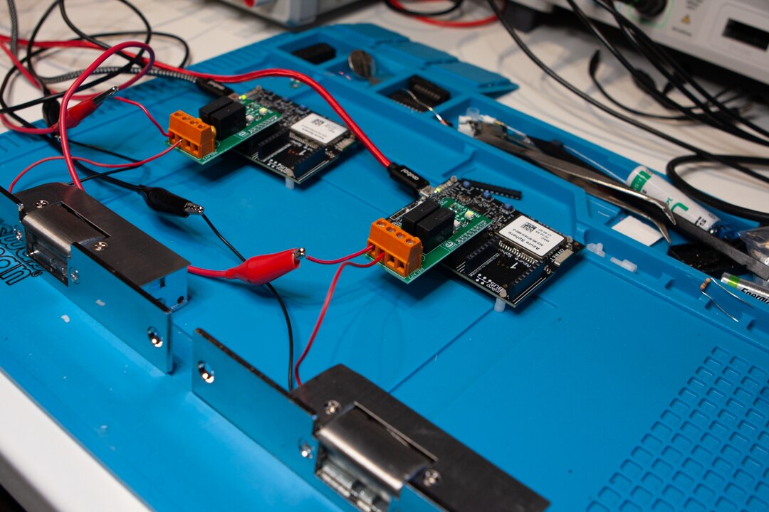

Azure Sphere MT3620 development board 2x
Electronic locks 2x
Relay clickboard 2x
Wires and test leads

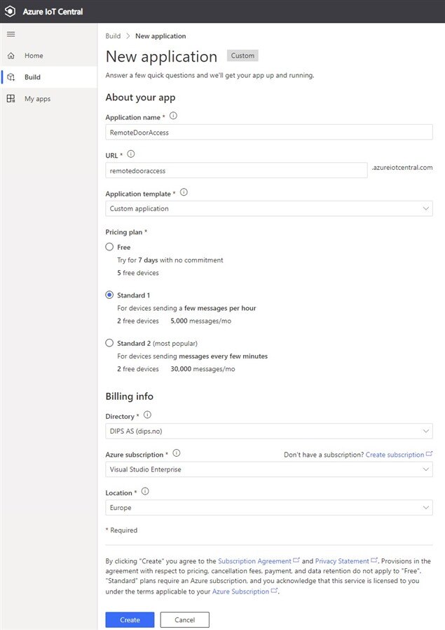

This project was made over the course of two evenings including documentation, following these two guides:
https://github.com/Azure/azure-sphere-samples/blob/master/Samples/AzureIoT/README.md
https://github.com/Azure/azure-sphere-samples/blob/master/Samples/AzureIoT/IoTCentral.md

The part involving authenticating the devices for the Azure IoT Central application by generating and verifying a certificate can be a bit tricky. If you follow the instructions to point it should be possible to accomplish.
https://docs.microsoft.com/en-us/azure-sphere/app-development/setup-iot-central#step-2-download-the-tenant-authentication-ca-certificate

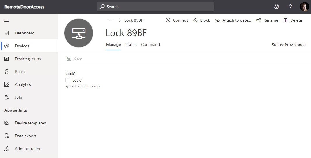

After setting up the sample IoT Central application and device code and authenticating the devices a test run I verified that everything was in working order.

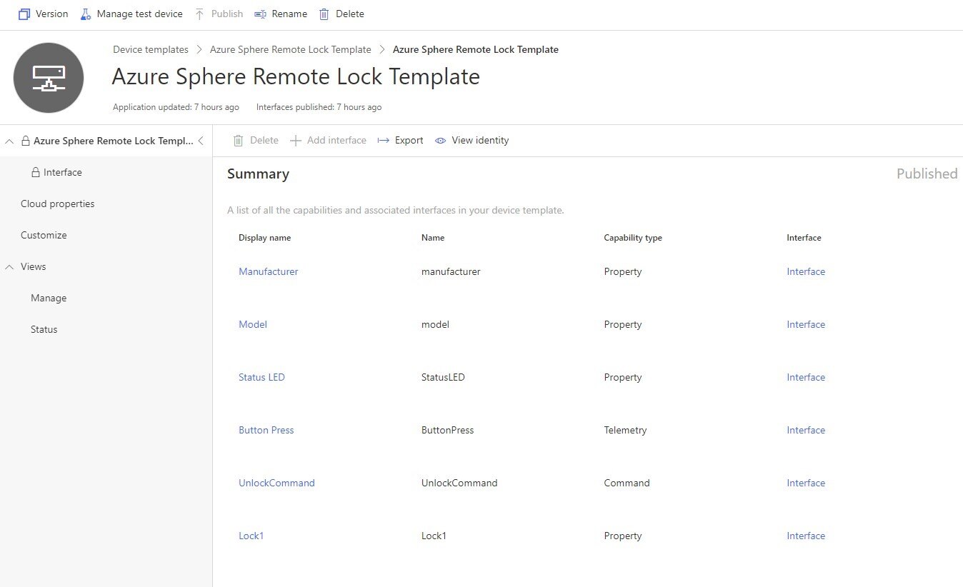

Create new template

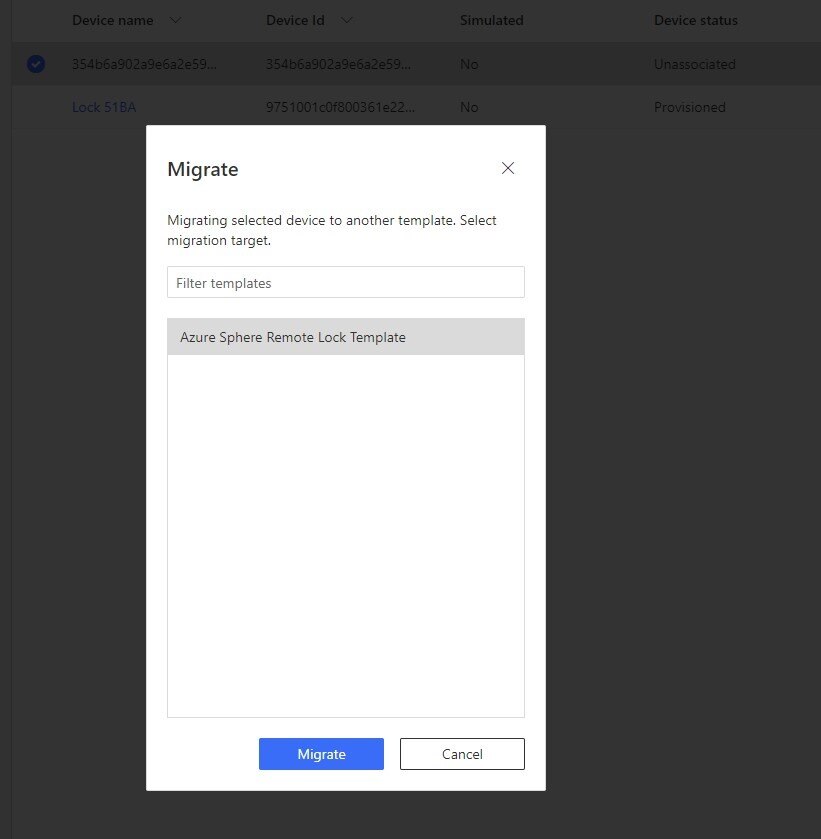

I made a new template for my devices, as making a new version does not seem to allow removing previous interfaces (Temperature). I added Lock1 to this. Find the template in the repository.
Clean up unused code
I removed anything related to Temperature, both from device code and IoT Central template. I kept the rest as I think they might get recycled. After customizing the template I made sure to migrate the two devices to use the new one.

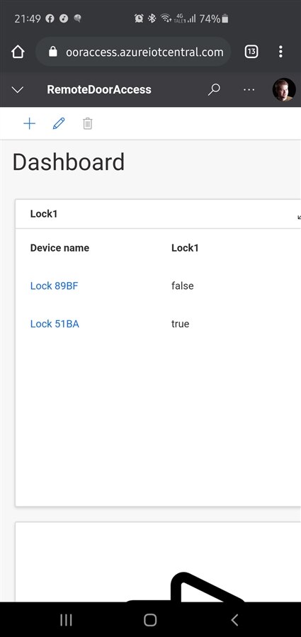

I used the StatusLED as a template to synchronize the state of the relay, calling it Lock1. In IoT Central I added a property with the same name and same features as StatusLED. I added an event with values Lock1ClosedEvent and Lock1OpenEvent. I haven't used these in the console yet as the boolean values are sufficient.

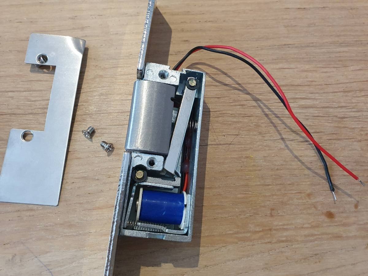

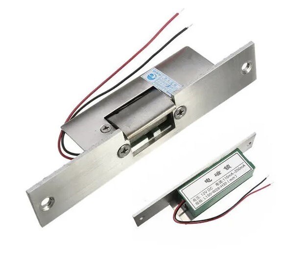

I found a simple solenoid driven electronic lock. It seems to do what it's supposed to do, but I can not vouch for it in terms of quality or lifespan. I wanted a low commitment to prove if the concept would work, with the option to upgrade if needed. The particular model I am using can be found here https://www.banggood.com/Door-Electric-Strike-Lock-Fail-Safe-NO-Narrow-type-Electronic-Control-12V-DC-p-1040055.html

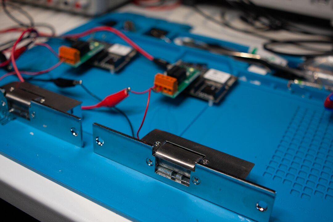

Operation is simple: The lock is mounted in the door frame, not the door itself. When powered a solenoid keeps a wedge from being able to move. This catches the door (lock) bolt. Unless the bolt is retracted, i.e. via turning the key or inside knob, the door is locked. When disengaged the wedge is free to move out of the way of the bolt and the door can open without the use of the key or turning the inside knob.
Lock specs:
Voltage: 12V ± 10%
Working Current: 110mA-250mA

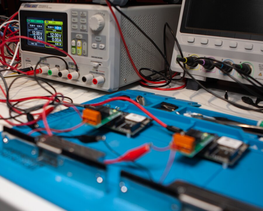

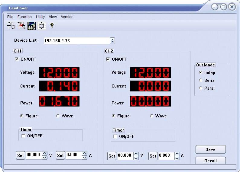

The lab power supply serves as a standin until the available power source by the doors are known. The negative wire of the power supply is fed directly to the lock's negative terminal. The positive wire from the power supply is fed to one of the relay's terminals. A second wire is attached between the other terminal of the relay to the lock's positive terminal. When the relay is engaged the circuit is closed and the lock is engaged, i.e. shut. The wiring is very temporary in this phase.
Demonstration
The two locks can independently be toggled, paving the way for the next phase of the project.
The image above is a screen grab of the power supply where channel 1 is active and channel 2 idle.
