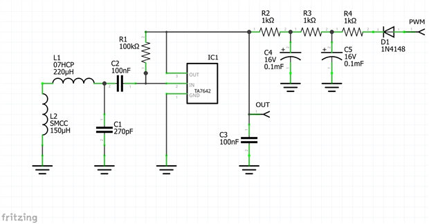

Of course the most interesting part of this project is the lightning detector. While nowadays it is possible to use for example AS3935 sensor for this purpose, for the sake of learning about lightning detecting principles of operation I decided to  look at this problem in more depth and do some experiments.
There are various possible approaches to detecting lightning but the most reliable seems to be detecting electromagnetic interferences in AM radio bands. This project was inspired by Blitzwarner device by Burkhard Kainka who designed detector based on AM radio TA7642 integrated circuit. TA7642 is a three-pin low voltage AM radio receiver IC in TO-92 package. It is very cheap and experiment friendly. We will use a modified version of B. Kainka’s detector also in this project.
Basically the main feature of this circuit is that in presence of AM radio band electromagnetic interference the voltage on C3 temporarily decreases. We can detect those voltage dips using Azure Sphere ADC and process this information further.

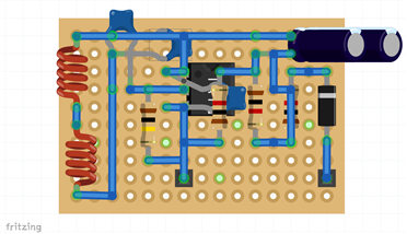

Lightning detector
As you can see from the circuit schematics, this is a simple AM receiver tuned to approx. 500 kHz. TA7642 ICs are very sensitive to operating voltage (see file TA7642_receiver_notes.pdf included in project repository) and it is necessary to control this voltage in some way. In this case we will be generating precise operating voltage using software PWM.
Detector perfboard layout and finished module
Detector schematics and perfboard layout are available as a Fritzing file in project repository.
Parts list:
  • IC1: TA7642
  • D1: 1N4148
  • L1: 220 uH type 07HCP
  • L2: 150 uH type SMCC
  • R1: 100 kOhm
  • R2, R3, R4: 1 kOhm
  • C1: 270 pF
  • C2, C3: 100 nF
  • C4, C5: 100 uF / 16V

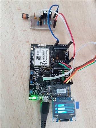

Detector is connected to following pins on Azure Sphere Starter Kit:
Detector moduleStarter Kit
PWMClick Socket 1 PWM
OUTClick Socket 1 AN
GNDClick Socket 1 GND
(If connected to Click Socket 2 modify TA7642_SOCKET_NUMBER in RTCore app main.c)

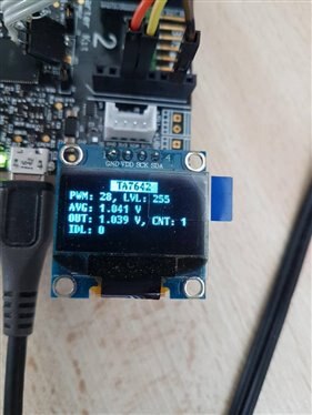

RTCore application operation

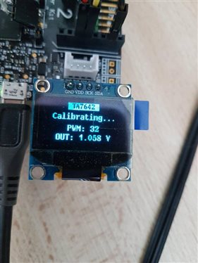

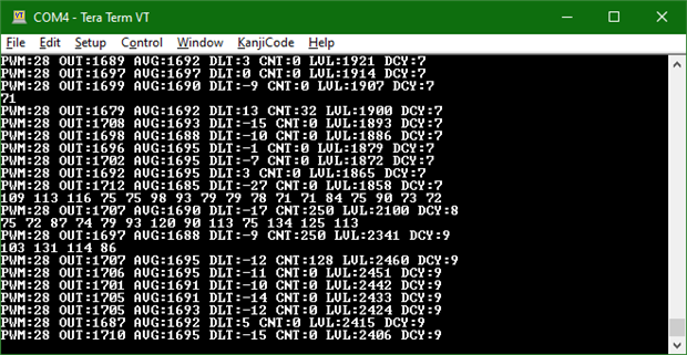

After rtcore_lightning_monitor application is loaded and also after every restart it starts to calibrate output voltage. PWM signal with increasing duty cycle is generated and at the same time TA7642 operating voltage is monitored. As soon as TA7642 voltage reaches 1.1 V the calibration process is stopped, PWM duty cycle value is recomputed (in effect slightly lowered) and subsequently used in detector operation. The video below shows voltage waveforms on PWM and OUT pins during calibration.
During calibration process Starter Kit yellow APP LED is blinking periodically. If TA7642 output voltage never reaches 1.1V, the calibration fails and the APP LED stays on to indicate calibration problem. The calibration is then retried with the APP LED staying on.
After calibration succeeds, APP LED is switched off and RTCore app enters main monitoring loop. When the impulse is detected, APP LED blinks momentarily to indicate impulse detection.
If one hour passes without any detection whatsoever, the detector is recalibrated.
For more details see commented RTCore app source in main.c file.

RTCore UART debug messages example:
Debug screens - TA7642 running normally and calibrating:

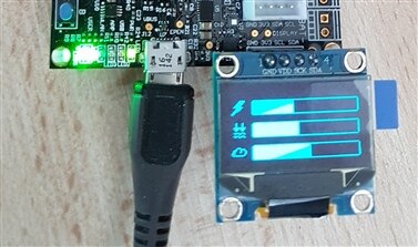

Lightning warning indication
Current warning level is indicated on OLED display as a bar-graph or numeric value. It is also indicated on RBG LED as green, yellow and finally red alert. It is possible to set your own warning level values for those alerts.
Warning level - green alert:

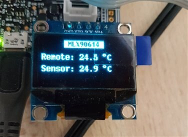

Cloud detection is based on measuring sky temperature using non-contact infrared thermometer module with MLX90614 sensor. For this purpose I ported MLX90614 I2C driver to Azure Sphere, you can find my MLX90614 support library on GitHub here: https://github.com/jgroman/azsphere_lib_mlx90614. The main application periodically polls thermometer sensor for its own (ambient) temperature and also remote measured temperature. Based on the difference between those two temperatures we can infer cloud presence. Zero or very small temperature difference means clear sky, larger differences indicate clouds.
For best cloudiness bargraph resolution you may tweak CLOUD_DELTA_T_MAX value.
MLX90614 debug screen:

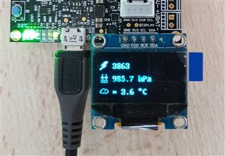

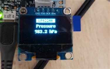

Measuring atmosperic pressure
For this purpose we will use Starter Kit onboard sensor LPS22HH. I prepared a simple Azure Sphere wrapper library for system independent LPS22HH drivers from STM, you can find this support library here: https://github.com/jgroman/azsphere_lib_lps22hh . Again we just periodically poll the sensor for current data and display the result as a bargraph or numeric value. Usually sudden drop of atmospheric pressure may indicate incoming storm.
LPS22HH info screen:
