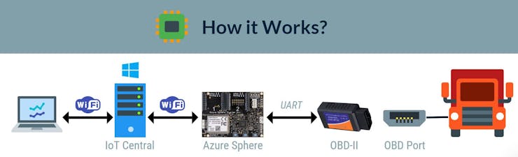

Connection Diagram of the modules
The circuit diagram or schematic is pretty simple. The OBD-II module is connected to the OBD ( On Board Diagnosis ) port of the vehicle and it talks to the Azure Sphere via UART protocol. The Azure Sphere then converts the data coming from the OBD-II module to human-readable form and send it to the IoT Central of Microsoft Azure cloud service.
The Azure Sphere uses the PIDs ( Parameter IDs ) to talk to the OBD-II module. When the OBD module reply, it needs to be converted into the human-readable form using specific formulas. Once converted the data is arranged in the { key: pair } format and send to the IoT Central. The template used for creating IoT central should know which { key: pair } to look for and when it finds one it immediately registers it for further processing. Once the data is registered in the IoT central, we can view it in realtime using our custom dashboard. The data is then ingested into the ML/AI toolbox to actually make sense of it and deliver useful prediction ( Currently this part is not yet implemented as my free subscription to Microsoft Azure expired ).
This design is not just limited to one vehicle. It can be easily implemented at scale, for a fleet of vehicles. Not only vehicles, but this idea/design can also be applied to other machines where security and predictive maintenance is a priority. The azure sphere integrated with IoT central makes this solution scalable. The same build provided by a developer can be used to connect multiple devices to the IoT Central using DPS (Device Provisioning Service), a service provided by the Microsoft Azure cloud platform.

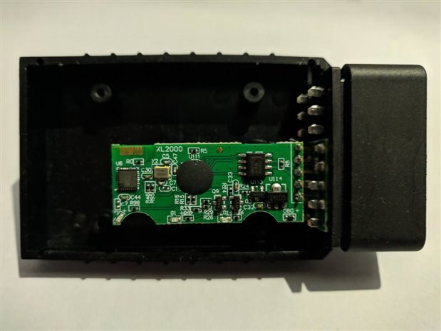

6. Setup the OBD-II module
Note: The OBD-II module I have used here communicates using Bluetooth, which is a weak spot in this secure project. I bought this model as it was cheap and I could afford it. I thought of modifying it by bypassing the Bluetooth chip and directly connecting the UART pins with the UART port of Azure Sphere. Unfortunately, this model uses a Chip-On-Board IC which makes it extremely difficult to find the correct pins given the time constraint. So I went ahead with the Bluetooth approach. If possible please use the physical medium to connect the OBD-II module with the Azure Sphere.
Let's proceed with setting up this module. Setting up this module is very easy. You just need to find the OBD port of your car and plug this module into it. That's it.

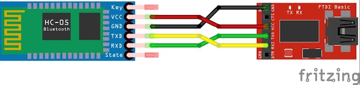

  • Connect the Bluetooth module with the PC using an FTDI module. Please refer below image for reference. Apply +5v to the KEY pin of HC-05 to put it in the AT command mode.
    Schematic of HC-05 with FTDI module
  • Obtain the Bluetooth address of the OBD-II module. It will be useful while configuring the HC-05 module. For our reference, let us assume the address of the OBD-II module is 12:34:56:78:9a:bc
  • Once the setup is complete, use any serial terminal program for example "CoolTerm" to configure the module. Set the baud rate of the serial communication software as 38400. Send below listed AT commands one by one to configure the HC-05 to act as a master.

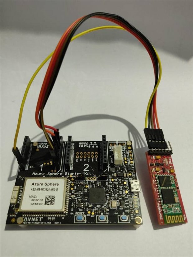

8. Connect the Bluetooth/OBD-II module with the Azure Sphere
  • If you are using a physical medium to connect the OBD-II module with Azure Sphere then directly connect the Rx, Tx, GND pins of the OBD-II module with the Tx, Rx, and GND pins of Azure Sphere respectively.
  • If you are using Bluetooth as a communication medium between the OBD-II module and Azure Sphere then please connect the HC-05 module with the Azure Sphere.
Note 1: Do not forget to provide GND to the KEY pin of the HC-05. This will set HC-05 in the data communication mode.
Note 2: Please use PORT 1 of the Azure Sphere for this connection. If you are planning to use PORT 2 then you also have to make changes in the code.

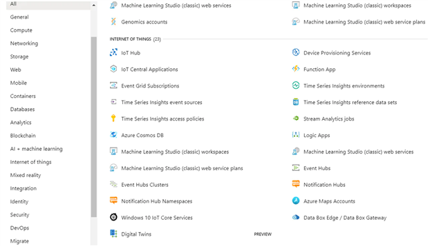

10. The Cloud ( Basically, someone else's computer )
Azure Sphere is a wonderful cloud platform but using it standalone without the Microsoft Azure is like driving a Tesla without its autopilot feature, it won't be fun. Microsoft Azure provides a whole new dimension of visualization, control, and features which might not be possible by using Azure Sphere only.
The IoT central feature of Microsoft Azure is one of the best services I have used. It is a Software-as-a-Service (SaaS) offering from Microsoft. Microsoft has made it extremely easy to connect your devices to its platform that too without any coding required. It also provides Cloud to Device(C2D) features for controlling devices via the cloud. It can be used to display telemetry data, create alerts, execute commands, and to create your own dashboard too.
In this project, I have used the template provided by Avenet Technical Training Course to design my IoT central Dashboard. It displays the telemetry data like coolant temperature, engine RPM and Throttle position on the dashboard. This template can also be used to control the device via the "settings" tab.
You can download the template by referring to the documents provided in this Azure Sphere Technical Training course. I would suggest completing this training as it is going to be extremely helpful and also it is free of cost. If you are aware of IoT Central and just want the template then please follow this link.
The fun part doesn't stop here. You can use all the data uploaded to the IoT Central to predict the potential breakdown that can happen in your vehicle and carefully plan the servicing even before it happens. This way not only you will save a lot of money but also reduce the vehicle downtime and plan better.
Microsoft Azure provides a ton of services, from IoT hub to machine learning and AI to Analytics and many more. Even the sky is not the limit for what you can do by utilizing the services provided.

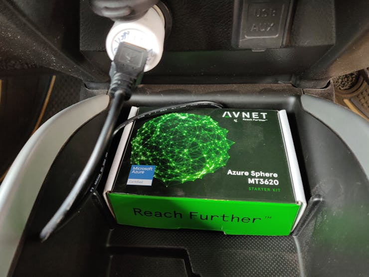

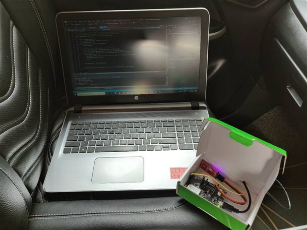

11. Final Assembly
The above image represents the test environment. In the test environment, the laptop provides the power and debug environment to the device. In the final setup, the device will receive its power from the car. While testing, exercise safety at all costs.

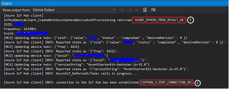

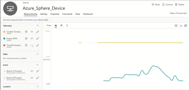

Clone the code from here if not already done and flash it onto the board. Once the code is flashed, it will start displaying the output in the "device output" tab of the visual studio.
Device Output when device is connected successfully to the IoT Central
  • If the device is connected successfully to the IoT central then the output should look like the above image. The output shows that the device is successfully provisioned by the Device Provisioning Service( point 1 ) and then it is connected to the IoT Central successfully( point 2 ).

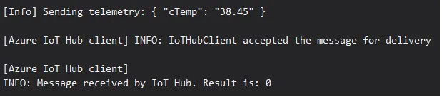

Device sending telemetry data to the IoT Central
  • The above image shows the output when the device successfully uploads the telemetry data to the IoT Central. It can be seen that data is arranged in the { key: pair }. It also shows the confirmation received by the IoT Central.
If the output of your device is similar to the above images then you can say than the connection is established successfully and Azure Sphere is properly reading data from the OBD-II module and uploading it to the IoT Central.

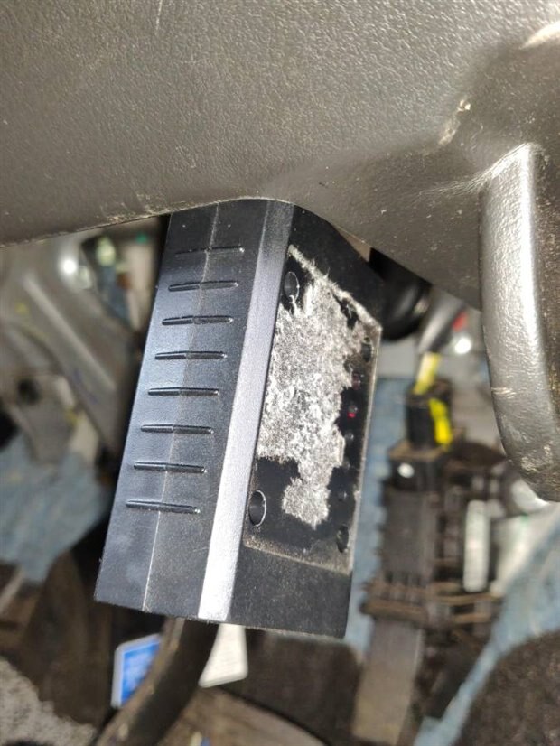

When testing is complete, place the device in a case that will protect it and make it look clean.
Project looks clean :-) but not my car :-(
