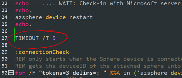

    Hi!
    First of all, you need to have in mind that when you run the "sk_chek.bat" it reboots the Sphere Kit. I've had a similar problem as even I've had everything properly configured when I tried to run the script it was trying to take the wifi configuration just at the end of the restart and the wifi configuration was not initialized yet. (As it needs more time)
    Try one thing, I suppose that you've had configured the wifi via azsphere device wifi add --ssid <yourSSID> --key <yourNetworkKey>, right? So, go to your "sk_check.bat", edit it and just below the lines which make the sphere to restart, insert this line mentioned before (obviously with your ssid and password of the wifi), and you will see that when you try to read the information again, maybe the first time it gives you an error, but if you let the script running it tries to do it again automatically and you will see that on the second time the console will turn the font to green and the wifi will be properly configured and everything will work! image
    Hope it helped!

    shabaz over 7 years ago
    Hi Andres,
    I had the same issue as you.
    The solution is mentioned on another thread. In a nutshell, a delay in the script will allow it to populate the device IP field.
    To do that, open the sk_check.bat file in a text editor, and after line 25, insert a line with this text:
    TIMEOUT /T 5
    Now when you use the registration program, it will pause for a while, and the end result is that the field will be correctly populated.

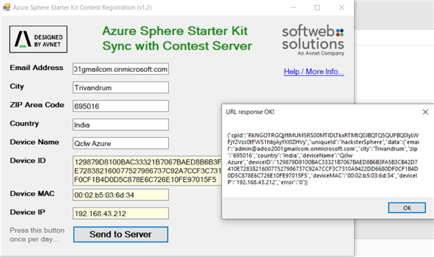

    Thanks for the answer. I had the same problem, wi-fi appeared configured in command prompt, but the sdk application showed Device IP: wi-fi not configured.
    I added a TIMEOUT /T5 in the bat file. That didn't work, Device IP field became empty.
    I then added azsphere device wifi add --ssid --key line you mentioned.
    Now Device IP shows my IP  image
