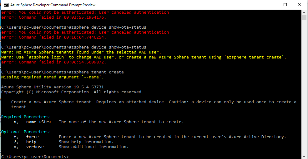

Hello Everyone,
I am trying to setup this Azure Sphere kit but I bump only into errors and technical issues.  If I knew that it is so difficult I would have not signed up for this challenge.  First,none of my Microsoft accounts work as I got only error messages when trying them one after another.  Then I have created a new one and with tis one I still get only errors like the ones in the screenshot below:
This is a horrible experience so far as I spent so much time and with no result.  Dis anyone experienced similar issues and how did you solve them?  I appreciate any response or advice.

    I managed to set mine up, but I do have to agree that the documentation can be slightly difficult to follow and the order in which it is presented can be confusing. There are also minor errors in the documentation as well.
    Consumer Microsoft accounts don't work as they aren't backed by an active directory. Workplace/University accounts may work, but if they are not provisioned for Azure, then you could end up stuck like this person: https://www.element14.com/community/message/278030/l/re-failed-to-create-an-azure-sphere-tenant#278030
    Ideally, you should create a new account that is in the form of <name>@<domain>.onmicrosoft.com via this page (https://account.azure.com/organization ) linked here: https://docs.microsoft.com/en-us/azure-sphere/install/azure-directory-account. Towards the end of the process, it might ask you to sign into your existing account but it didn't work for me - but it did generate a new account which I could then use with the Azure Sphere Developer SDK.
    In the Azure Sphere Developer Command Prompt, you should then be able to use the 'azsphere login' command, using the username of <name>@<domain>.onmicrosoft.com and the password you selected. If successful, then everything else should work including creating a tenant and claiming a device. Note that the show-ota-status doesn't work until the device has been claimed (as far as I know) and this is a "bug" with the documentation (i.e. OS updates cannot happen until claimed - but automatic updates do work, just give it some time).

    You are very close!  Here is an example command line entry for creating a tenant:
    azsphere tenant create --name MyTenant
    The --name has to be typed out explicitly before the name you make up is typed.  MyTenant is just something I made up.  Change that to something you think is cool.

    Thank you Sean.  The command azsphere tenant create --name MyTenant with my name in there worked.   Thank you also for the link to the tutorials.
