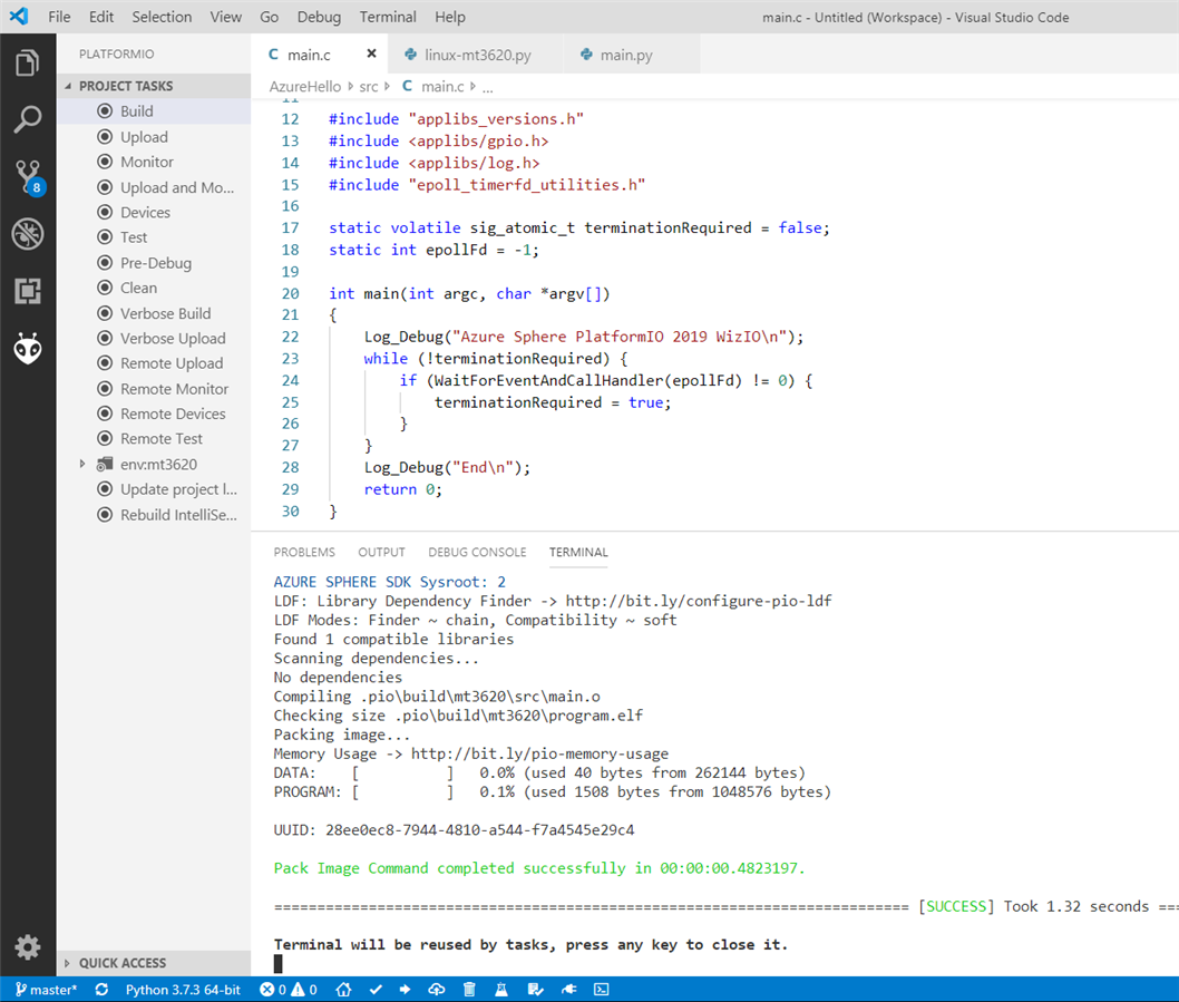

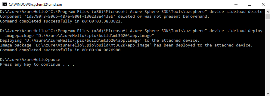

second question
How to install SDK without Visual Studio, I have port for PlatformIO ... problem is only azsphere device sideload deploy
C:\work\.......platformio/packages/tool-azure/azsphere device sideload deploy --imagepackage manual.imagepackage
error: Could not connect to the Azure Sphere Device Communication Service. If this issue persists, try uninstalling and reinstalling the Azure Sphere SDK.
error: Command failed in 00:00:02.3000892.

    by the way The Project will be here:
    https://github.com/Wiz-IO/platform-azure

    AAHHHH image ...
    How to create AAD account
    You need email at hotmail.com or ... account at microsoft
    Example: wizio@hotmail.com
    goto Azure Portal -> Azure Active Directory -> Users -> New user
    enter ....
    User name: azure@wiziohotmail.onMicrosoft.com ( azure@ as your preferences, wiziohotmail as your email )
    [CREATE USER]
    Select this user: Directory role -> ADD -> Global administrator
    That`s all about AADSTS50020 user ....
    Test:
    azsphere login
    enjoy image
