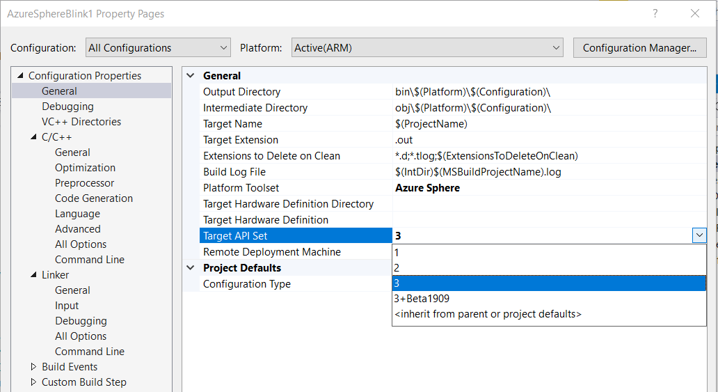

    Georgi
    If your Azure Sphere OS has updated to 19.09, then you also need to install the new 19.09 SDK and rebuild the application.
    https://docs.microsoft.com/en-us/azure-sphere/resources/release-notes-1909
    In Visual Studio you will need to adjust the target API Set that's used in the build (previous 2+Beta1905 APIs are no longer applicable)

    More info on this topic is available here:
    https://docs.microsoft.com/en-us/azure-sphere/app-development/use-beta#target-api-sets-arv-and-sysroots
    PS: Beta APIs can change. Builds with an older SDK that only made use of production APIs are not affected by OS updates
