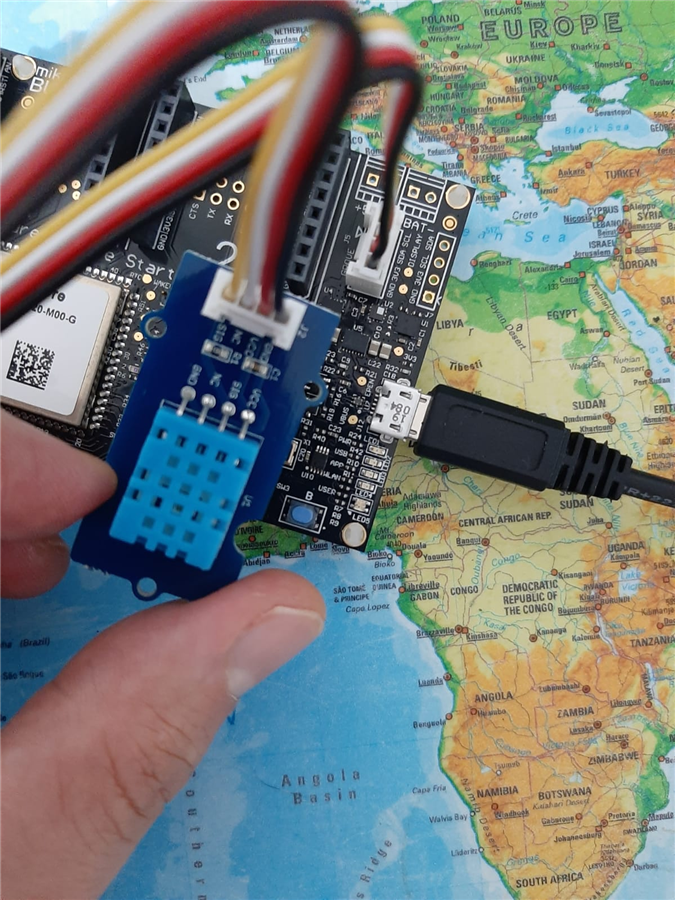

Hi all,
do you know if it is possible connect a Grove Temperature and Humidity sensor (DHT11) to AVNET Starter Kit MT3620 and read values ?
Sensor is this one : Grove - Temperature&Humidity Sensor - Seeed Wiki
I can only find tutorial about Grove SHT31 Temperature and Humidity sensor and not DHT11 (that is pretty popular).
I am wondering if the already existing Arduino library for Grove DHT11 sensor can be suitable on MT3620 ... here the link https://github.com/Seeed-Studio/Grove_Temperature_And_Humidity_Sensor
Thanks

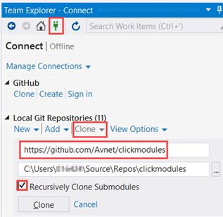

    Click board Demo Repo
    Recommended starting point for adding an I2C sensor to your project, is the driver code for Click boards already ported to Azure Sphere
    For temperature and humidity measurement, code for the Temp&Hum Click board (based on HTS221 device from ST Micro) is provided
    • Temperature accuracy is ±0.5°C for the 15 to 40°C range (±1°C across the wider the 0 to 60°C range)
    • Relative Humidity accuracy is ±3.5% for the 20 to 80% range (±6% for the full 0 to 100% range)
    • This sensor provides interfaces for both I2C and SPI access
    To utilize this click-board library, include the https://github.com/Avnet/clickmodules repo in your project.
    More detail on this topic is available in the following blog article Using MikroE Click Boards with Microsoft Sphere

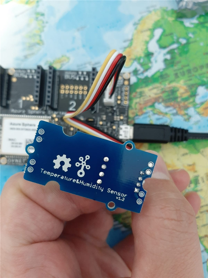

    Is there an available driver for the sensor in picture (Grove, Temperature and Humidity v1.2) ?
    MikroE Click Boards are quite difficult to find compared to grove sensors, some suggestions about how to use this sensor (Grove sensors are officially supported by the AVNET MT3620) are really appreciated.
    Waiting for your answer
    Alessandro

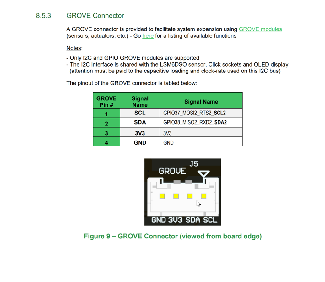

    It should be possible to do this without the need for any additional hardware.
    It looks like the Grove connector is configured for i2C and shared with the LSM6DSO sensor (just spotted your comment that you got that already)
    So you might be better connecting the DHT11 to one of spare I/O pins via the headers meant for the click sockets such as "PWM" on Click1 which is GPIO0_PWM0
    https://www.avnet.com/opasdata/d120001/medias/docus/196/Azure%20Sphere%20Starter%20Kit%20User%20Guide%20(v1.3).pdf
    I find these kind of cables are good for that.
    Many of the arduino libraries for the DHT11/DHT22 seem to support multiple version of the sensor / boards which makes them harder to port to a different platform
    Here's a basic one which might be easier to port.
    https://playground.arduino.cc/Main/DHT11Lib/
    Looking at the DHT11 data sheet, the one wire protocol used by the DHT11 is open drain with a pull up resistor. The seeed grove module appears to have that 5K resistor already in place (with an additional capacitor between the power rails, which we can ignore).
    So when opening the pins you can set the output mode as follows:
    GPIO_OpenAsOutput(mypin,GPIO_OutputMode_OpenDrain, GPIO_Value_High)
    That means you can avoid the need to keep toggling the pin between input and output.
    You'll need to swap the various API calls:
    digitalWrite becomes GPIO_SetValue
    digitaRead becomes GPIO_GetValue
    delayMicroseconds becomes nanosleep (found in time.h) and scale the value by 1000
    Use a scope to check the timing, the defaults might need tweeking.
