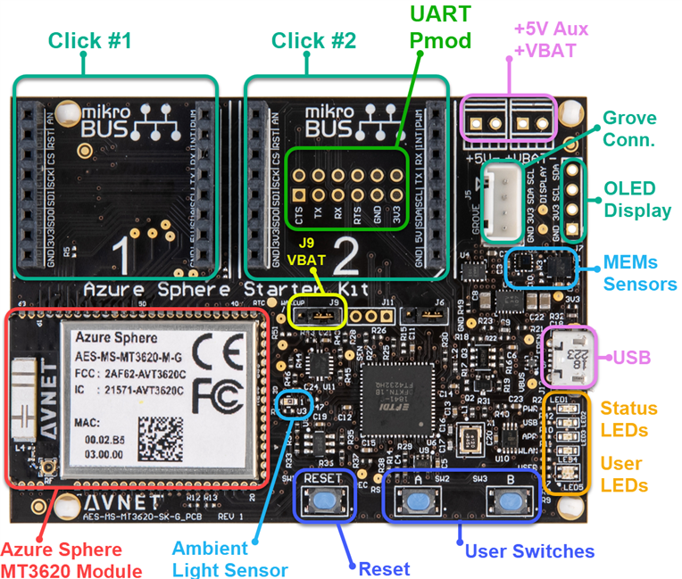

    I'd suggest close Visual Studio for now, and do a quick check of the status of your starter kit, as follows:
    1) Check that the VBAT jumper is still in place on J9 pins 1 and 2 !!!
    J9 is located in center of the board, see the yellow box in the image below...image

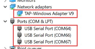

    2) Do the relevant ports show-up in Windows Device Manager when you connect the board to your development PC?
    (ie. three COM ports plus TAP-V9 virtual ethernet adapter) - a simplified view shown here...

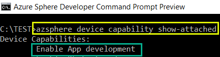

    3) What is the board's status from the azsphere command-line interface?
    Enter the following commands:
    azsphere device show-attached
    azsphere device capability show-attached
    The "Enable App Development" capability should list in response to this command...

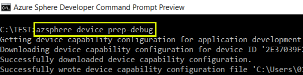

    If this capability is not listed (typically as result of the Sphere OS having updated), re-enter the prep-debug command:
    azsphere device prep-debug

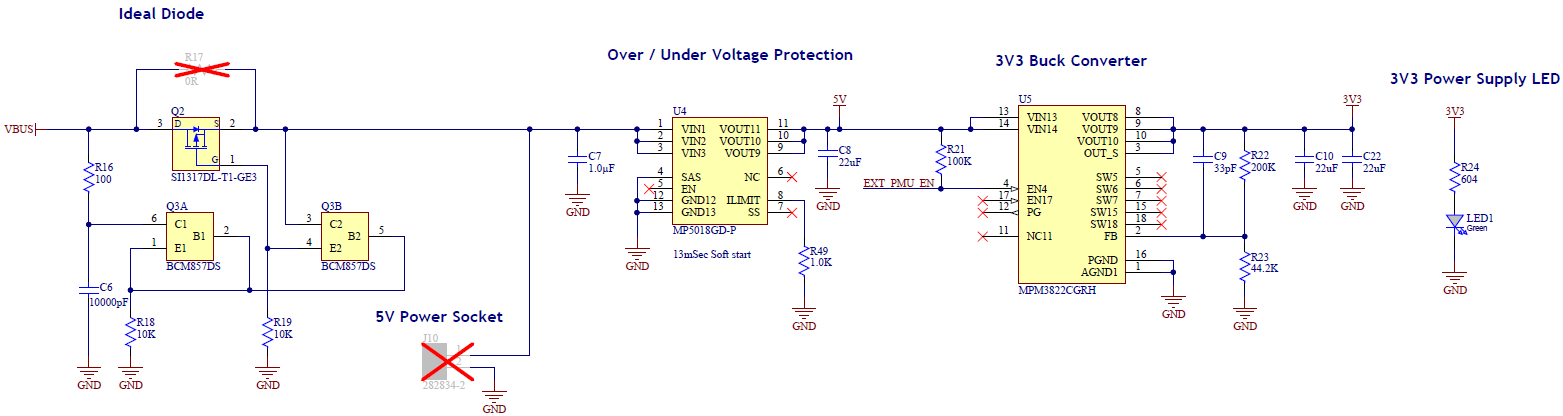

    To eliminate the computer for a moment from your debugging, try plugging-in a regular +5V phone charger (ie. one with a microUSB connector)
    If the green Power LED does not illuminate, I'd suspect a possible hardware fault with the DC/DC regulator on your board
    More likely though, is your USB cable. The power management circuitry on the Starter Kit includes under-voltage detection
    A marginal USB power connection can cause an excessive voltage drop that will result in no 3V3 output, and that LED not being illuminated
    PS: The full schematic is available for you to download at:
