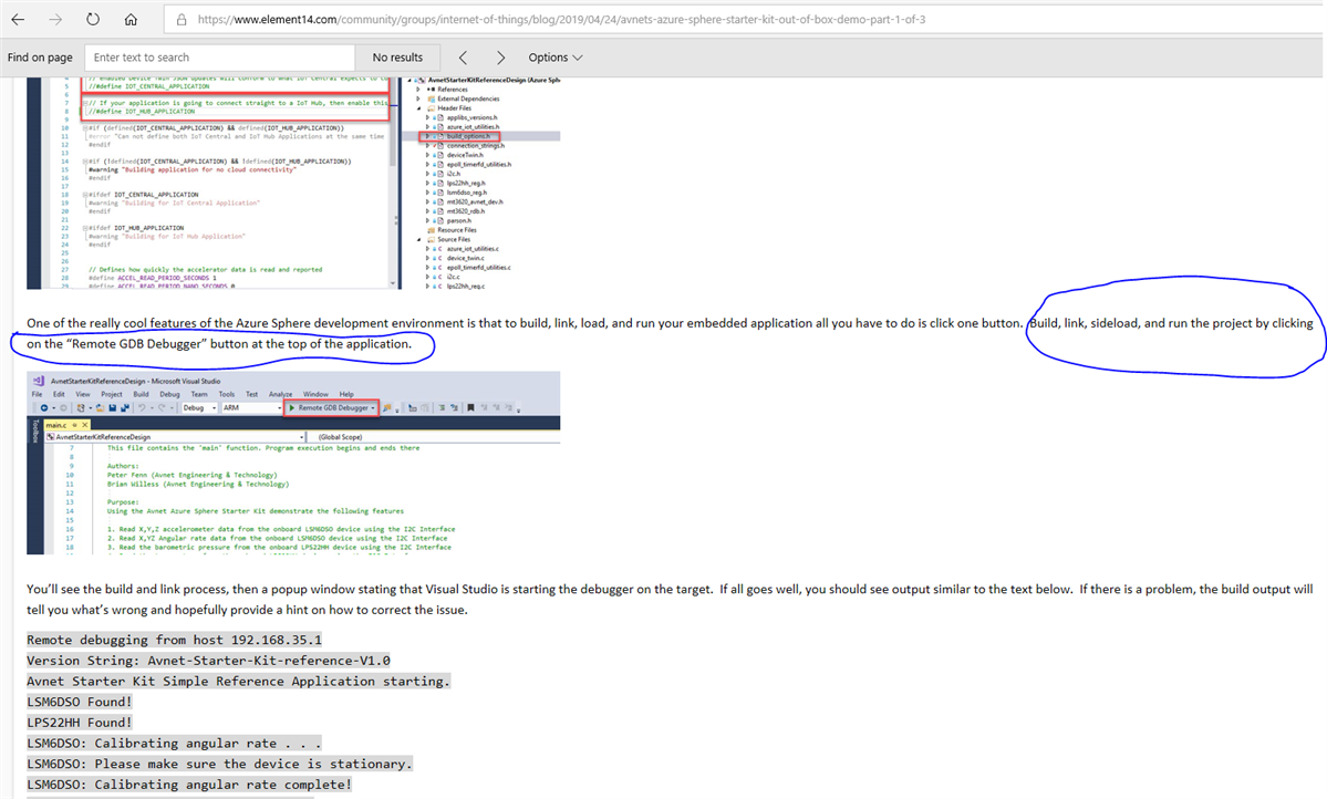

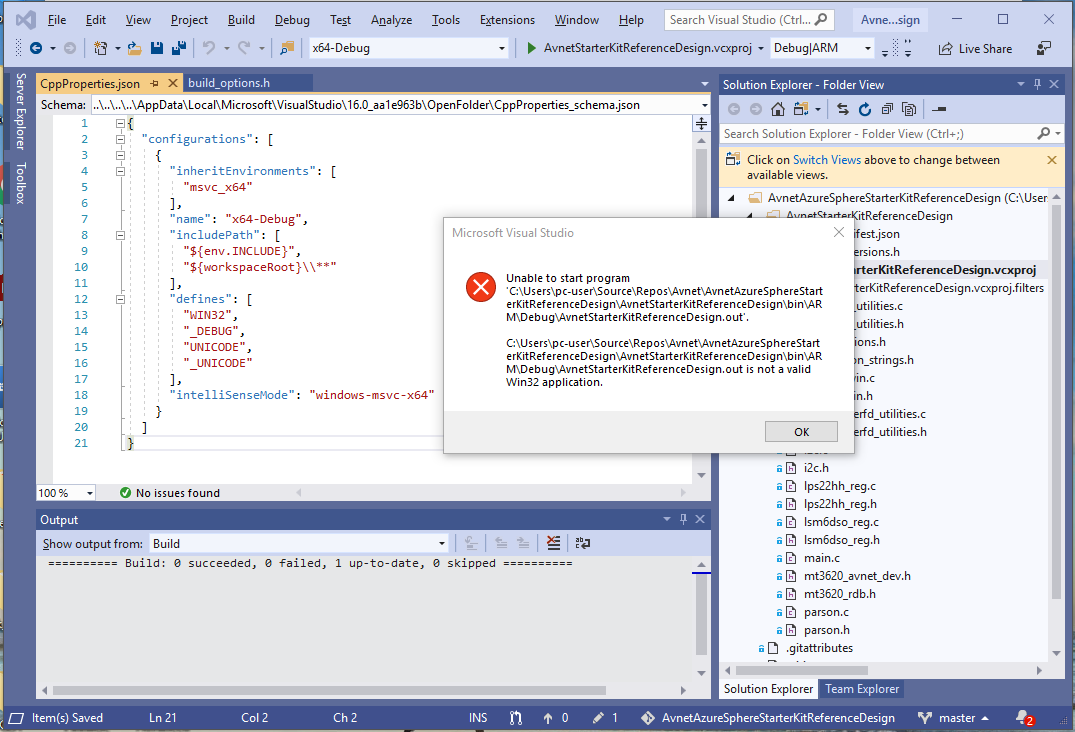

Hello Everyone,
So far I was able to get the kit and the software installed and I was able to create the necessary accounts.  Now I am facing an error that I don't know how to address.  I am trying to run the reference design following the steps in this blog:
Avnet's Azure Sphere Starter-Kit (Out of Box Demo) Part 1 of 3
but the windows and menus are a bit different than the screenshots in the blog and at the step highlighted in the screenshot below I get an error (shown in the second screenshot below).  Did anyone get this error and how did you handle it?  I would appreciate any help on this issue.

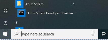

    peterfenn over 7 years ago in reply to ciorga +1 suggested
    From the Start button, open the azsphere command prompt ...then enter this command: azsphere device prep-debug This command sets up your device for local debugging (it typically needs to be done once,…

    0 Fred27 over 7 years ago
    It looks like Visual Studio is trying to run the project on your PC rather than on the Azure Sphere device. Have you installed the Azure Sphere SDK?

  • Fred27
    0 Fred27 over 7 years ago in reply to ciorga
    That looks like you have. And it also looks like you've installed the necessary C++ components for Visual Studio too.
    It looks like you may have selected "open a local folder" rather that "open a project or solution" when starting Visual Studio. I can get the same bahaviour if I do that and then select x64 configuration. Can you try "open a project or solution" (or alternatively double-click on the AvnetStartKitReferenceDesign.sln file).

  • Fred27
    0 Fred27 over 7 years ago in reply to peterfenn
    I can reproduce Cosmin's issues with the SDK installed and opening the folder rather than the solution in Visual Studio.

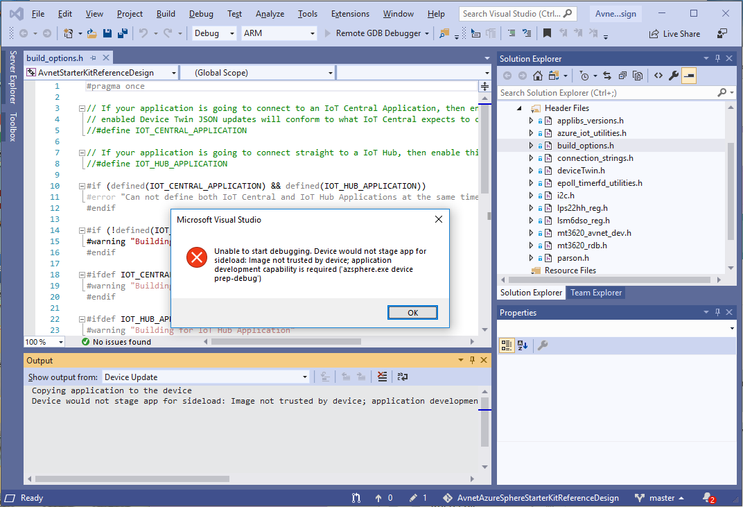

  • ciorga
    0 ciorga over 7 years ago in reply to Fred27
    Thank you for helping me David and Peter.  I have started Visual Studio using the "open a project or solution option" (I haven't done this before) and now I see the windows and menus as in the blog.  However, I still get an error when trying to run the build and debug:
    It mentions that the image is not trusted by the device.  Do you know what can be the cause of this issue?

  • peterfenn
    0 peterfenn over 7 years ago in reply to ciorga
    This command sets up your device for local debugging (it typically needs to be done once, following the automatic update of the device's Azure Sphere OS)
    -Peter
    • Reject Answer

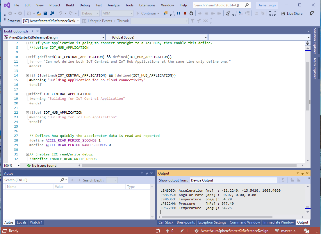

  • ciorga
    0 ciorga over 7 years ago in reply to peterfenn
    Hi Peter,
    Thank you for your help.  It works now:
    Best Regards,
    Cosmin
