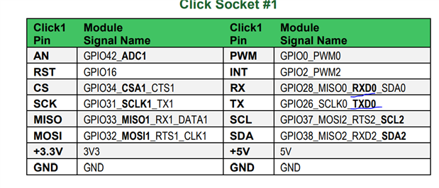

Has anyone had any success getting UART working on the Azure Sphere?
I've taken a look at Microsofts documentation and the UART example that I could find. I can't seem to get a UART_OPEN that doesn't return an error (-1).
I think I'm getting Tripped up on UART ID. My guess is that this UART_ID is the ID defined in the application manifest eg "Uart": ["ISU0] would be 0.
I've done the usual rx->tx and tx_>rx, ensured my serial device is 3.3v and is outputting data so I'm a bit confused by this.
I've ensured that i've defined     "Uart": ["ISU0"] in my app_manifest.json.
Has anyone had any success and have any tips?

    Hi, Stephen, Use MT3620_UART_ISU0. MT3620_UART_ISU0 is defined as 4 . In the AVNET examples it is defined as MT3620_RDB_HEADER2_ISU0_UART. uartFd = UART_Open(MT3620_UART_ISU0 , &uartConfig); // MT3620_UART_ISU0…

    Thanks Clem and Enrique, both of your solutions work. Those constants Enrique mentioned are defined here for anyone else looking.

    Hi, Stephen,
    MT3620_UART_ISU0 is defined as 4.
    uartFd = UART_Open(MT3620_UART_ISU0 , &uartConfig); // MT3620_UART_ISU0  is 4
    In the manifest use "ISU0"
    "Uart": ["ISU0"]
    And don't forget to connect GND
