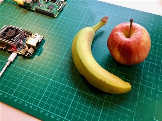

The models are tested on an image that consists of an apple and banana as the main objects. This is the same image used in Monica's Benchmarking Machine Learning project and Alasdair Allan's own benchmarking project. So I also used this image to keep my project as consistent as possible

For the Edge Impulse models, I took 181 pictures of backgrounds, apples and bananas.
Ex:

MobileNet Model Build (320x320) on MaaXBoard:
A pretty good score for the fruit, although it sees a board and the cable it's connected to as a banana
FOMO Model Build (224x224) on MaaXBoard:
With the FOMO model, it doesn't use bounding boxes to surround the objects
With the image size reduced and the model not utilizing full-size bounding boxes, the FOMO model runs significantly faster but is still accurate.
