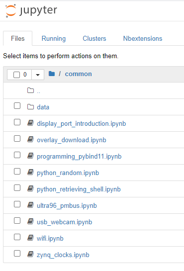

The first thing that I noticed is that there are 3 new notebooks in the Common directory
  1. display_port_introduction.ipynb
  2. programming_pybind11.ipynb
  3. ultra96_pmbus.ipynb
The pmbus notebook caught my eye because I had attended the PMBus webinar that Chris Ammann ctammann  had presented back in July PMBus and Power Supply Telemetry .

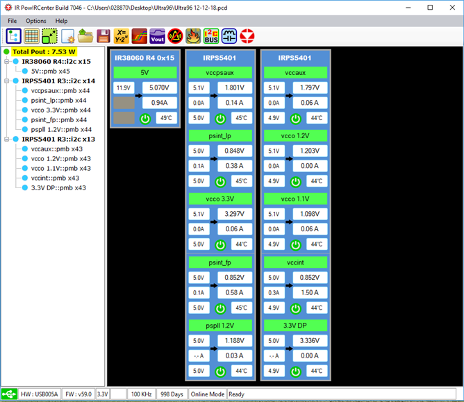

The slide from the webinar shows the 3 PMICs and the 11 voltages that they control on the Ultra96v2 (I am not sure about the configuration of the Ultra96v1).

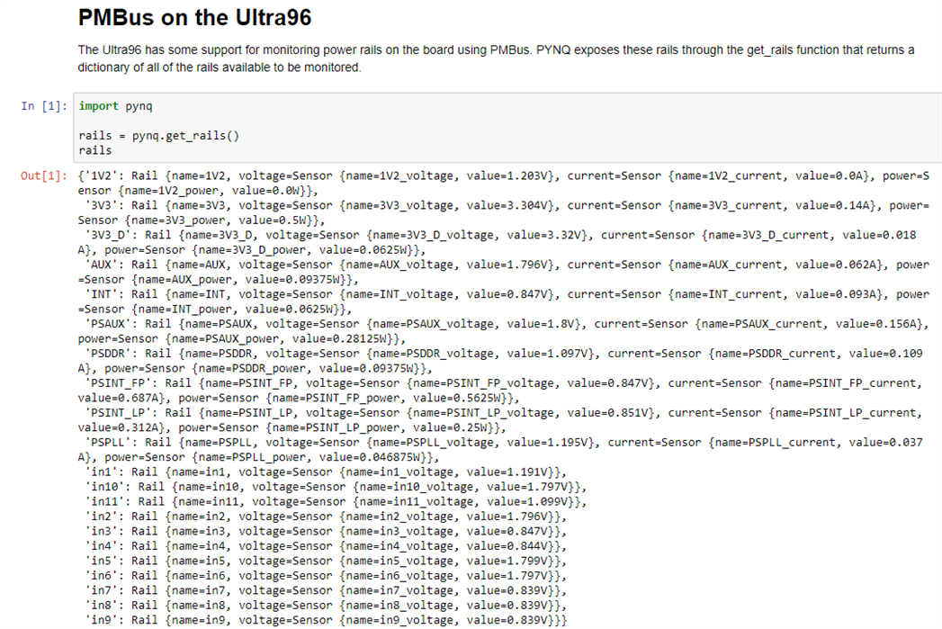

Running the pynq.get_rails() function almost works.  It provides the voltage, current and power information for the 2 IRPS5401 parts.  Unfortunately it lists the 10 voltages in alphabetical order by name rather than by IC position.  I can fix that easily enough but I don't understand why IR38060 (5V) isn't listed.  I also don't understand all the garbled stuff at the end.
I looked at the ultra96.conf file in /etc/sensors.d/ directory and the entry for the IR38060 at the end looks incorrect but I'm not quite sure what it should be.
I think it should be :
chip "*-i2c-6-45"
        label in1 "5V"
        label curr1 "5V"
        label power1 "5V"
I'll try that tomorrow.

    Hey Ralph, Thanks for your interest in this functionality. Let me follow up with my team specifically about the 38060. Without knowing the code, what you say above makes sense if the called out address…
