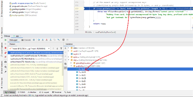

    Jan Cumps over 5 years ago
    I used these, from a road test: Blockchain - Debug the Infineon Demo App with Android Studio and Your Phone
    As hardware, I have mostly used my smartphone.
    I also used a smartcard compliant reader/writer: Blockchain - Talk Directly to the Infineon 2Go Smart Cards API

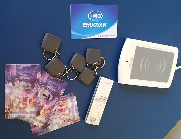

    These are the artifacts I use:
    An Ehuoyan reader that came with an RFID card. These are of the "not-smart" kind. The card has an ID and the reader can read RFIDs.
    Simple, easy, good. The reader acts as a USB keyboard.
    A µFR reader/writer came with 5 key fobs. The device is smart. The key fobs are - like the Ehuoyan card, tags with an ID.
    I use this device a lot, because it supports many standards, from simple ID reading to talking to MiFare and ISO14443 cards. (and Digital Logic has amazing support).
    The 3 Infineon cards in the left bottom corner are ISO14443 cards that run an application. You can open a session and interact with them. They come with a crypto currency example (with full source code !!)
  • colporteur
    colporteur over 5 years ago in reply to Jan Cumps
    The part picture contents you displayed was it an online purchase? Secondly, I am not an MS Window user. What environment have you got this working in?
    Jan Cumps over 5 years ago in reply to colporteur
    The Ehuoyan is a USB keyboard. That works with almost anything.
    The Digital Logic µFR, I have used with Windows, Linux ARM (Pi) and Linux x64
    The Infineon cards were an element14 road test. All the rest is purchased online.
    Ehuoyan from Aliexpress, µFR from Digital Logic.
    I also use an Android phone with nfc - development enabled - with Android Studio as development/debug envionment:
