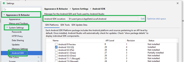

Install Android Studio
I'm using the latest version available from the Android Developers area.
I've used the full install, for my OS (Windows 10 - 64 Bit).
I made a change in the configuration after the install, to choose a good place to store virtual Android emulators:
File -> Settings -> Appearance & Behavior -> System Settings -> Android SDK -> Android SDK Location -> Edit

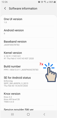

Enable Developer Mode on your Android Phone
You'll never find how to do that by scrolling through the telephone settings. It's hidden.
I followed these instructions: Run apps on a hardware device.
Once you have unlocked developer access, go to Developer Options in the Settings app and enable USB debugging.
If the Stay Awake option is available, it's good to set it during the debug activities.

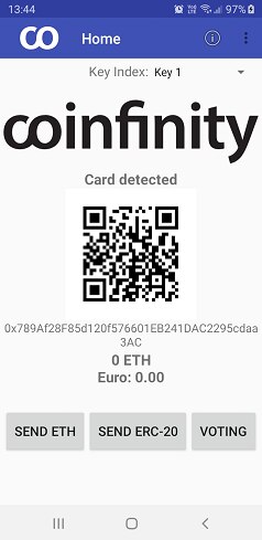

That can be a first test: try to load the app to your phone and run it:
This will load and run the application. Not in Debug, but in Run mode.
But there's a first interesting bonus: you can see the application log in Android Studio:  the first evidence of the traffic caused by tapping a Security 2Go card on an NFC device.

Select the Key Index you want to read in the app (default is Key 1.
Then tap and leave one of the cards from the Security 2Go kit on your phone. The breakpoint is reached.
