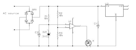

I have a possible future project idea and already have a challenge with it.
I want to power a microcontroller, 5V@2A DC, with a variable AC source. The AC source may vary from 1 to 50kHz, and 5V to 100V AC. Voltage is linear with frequency. The source may also vary on the fly.
What are some good strategies to regulate the power and keep it clean?

    Jorge_Garcia over 15 years ago
    Hi Cabe,
    In your spec you have a varying frequency and varying voltage amplitude. This situation is similar to wind turbines, where the frequency and the magnitude of the generated voltage is variable and unpredictable within certain limits.
    What they do is convert the varying freq, varying amplitude signal and convert it to a varying DC level through rectifiers (Thus removing the varying frequency element of the input power) from there they use an inverter to get 120VAC, perhaps a similar idea is applicable to your project, you haven't given to many details so I'm speculating.
    Since your final output is DC then you don't need the inverter. If the resulting DC voltage will be higher and lower then the desired output voltage (5V) then you'll have to use a buck-boost,SEPIC, Cuk, or Zeta Converter. If you can somehow constrain the variability of the input power source then maybe you can avoid the higher-order topologies.

  • Catwell
    Catwell over 15 years ago in reply to Jorge_Garcia
    Jorge,
    Thank you for the reply. I did not know that is how they handled wind turbines.
    My device needs to maintain a consistent DC voltage on the output. And I want to take as much of the excess voltage, from the AC source, and store it. So when the AC source drops low, I can supplement the deficiency with the stored energy. And I would like to not dissipate energy as heat from my device. A buck-boost topology could definitely handle the output.
    The difficulty here is handling the source. Perhaps I should make a two stage device? One for energy storage, and one for the output.

    Jorge_Garcia over 15 years ago in reply to Catwell
    Hi Cabe,
    That definitely sounds like the way to go. You could rectify the source and then use a buck-boost converter for the output to your main device. You could then use a secondary converter to charge batteries of whatever chemistry you plan to use. You would do well to have the micro monitor the amount of power available and assign priorities.
    For example the uC circuit will have the highest priority, and the battery charger will have the lowest. The battery charger will only run if sufficient power is generated to run both the uC and the charger, otherwise only the microcontroller will be active.

    lpetacchi over 15 years ago in reply to Jorge_Garcia
    Hi,
    I'd like to propose a different approach, based on a preregulator followed by an LDO. I sketched it out in the schematic below. Q1 is a controlled diode (like the SCR bridge you can find in 50Hz transformer based AC/DC supplies), switched on only for rectified voltages below a threshold.

    Catwell over 15 years ago in reply to lpetacchi
    Ipetacchi,
    Interesting idea, amplify if it drops below a threshold. I think I would like to try this setup with some sort of charging circuit for an onboard battery.

  • Catwell
    Catwell over 14 years ago in reply to Catwell
    I am definitely thinking of moving in this direction:
    AC source -> conditioner circuit -> charging circuit -> battery -> microcontroller or other components
    Thoughts?
