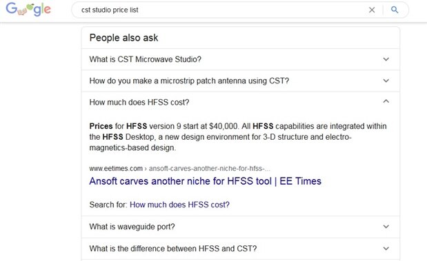

I believe each PCB layout and hardware engineer have his/her own approach to tackle EMC issues. I think using good practice and spending more time in the design phase will save a lot of time later on, especially with designs invloving high frequency clocks and switching power supplies. I am currently looking into investing in an EMC siulation tool to simulate PCB behaviour, one option that seems popular is CST Studio, would appreciate any thoughts and recommendations about this topic.

    michaelkellett over 6 years ago in reply to waleedelmughrabi +2 suggested
    My guess is multiply that by 10 or 20 ! Googling (although there is very little hard pricing info on the web) seems to confirm my estimate - MK

    Hi Michael, yes it seems likely that it'll be pricey. Usually we design low power embedded systems with various connectivity options, but every now and then an FPGA project and/or high current industrial controllers pops up.
    Not sure what budget it needs. I'm guessing for something like CST Studio it'll be no less than 3 or 4k.
  • michaelkellett
    0 michaelkellett over 6 years ago in reply to waleedelmughrabi
    MK

    0 waleedelmughrabi over 6 years ago in reply to michaelkellett
    Wow, I expected Ansys packages to have a hefty price, but didn't think it'll be in that range!!!!
