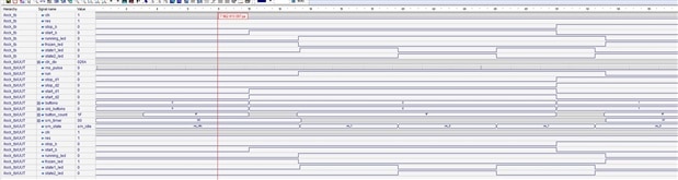

  • michaelkellett
    0 michaelkellett over 11 years ago in reply to johnbeetem
    Here's the simulation I did and the testbench that drove it. Simulation in Aldec ActiveHDL, The 1mS time was reduced to 100uS to reduce the simulation cycles.
    There is an attachment as well as the embedded picture !
    MK
