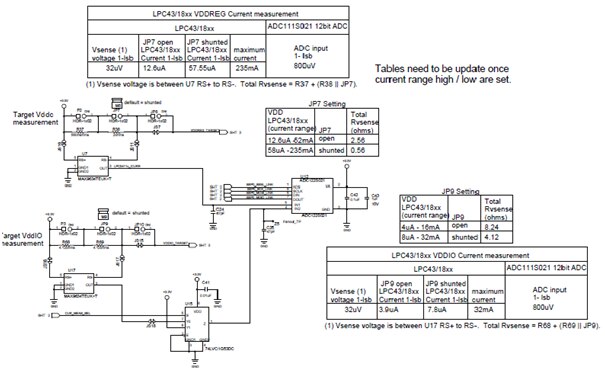

Built-in current measurement
The LPCXpresso4367 includes an on-board current measurement system consisting of a pair of amplifiers and a fast, 2 channels ADC, which is controlled by the on-board Link2 debug probe. Each amplifier measures the voltage drop across of two series resistors, one pair of resistors being in line with the Target MCU supply and one in line with the I/O supply. By default, one of the series resistors in each of these circuits is shorted by (JP7 for Target supply, JP9 for I/O supply) in order to allow the ADC to measure up to 235mA (Target supply) / 32mA (I/O supply) without the ADC input saturating. JP7 can be removed to make more accurate measurements when the Target MCU is consuming 52mA or less, and/or JP9 can be removed if the I/O supply current is 32mA or less. Note that the current measurement system will not be damaged if the amplifier outputs saturate.
Current measurement system range selection
Jumper
Position
Supply
Current range
JP7
Shunted (default)
Target
58uA-235mA
JP7
Open
Target
  1. 12.6uA-52mA
JP9
Shunted (default)
I/O
8uA-32mA
JP9
Open
I/O
4uA-16mA
The ADC can sample the amplifier out at up to 200k samples/second, configurable under control of the Link2 probe.
The current measurement system is supported by version 8.0 and later versions of the LPCXpresso IDE, which includes controls to select sample rate and enter the sense resistor values selected by JP7 and JP9.
JP7, JP9
The on-board current measurement circuitry includes a choice of two sense resistors for both the Target and I/O supplies in order to enable more accurate current measurement when the Target MCU is running in low power modes. JP7 and JP9 are used to select short a second sense resistor in the path of the current supplies of the Target and I/O supplies respectively.
A current meter may be installed across JP10 terminals to measure the Target MCU I/O current consumption. Pin 1 (square pad) is positive and pin 2 is negative. By default JP7 is shunted by a 0Ω resistor installed at JS15. Remove the resistor at JS15 to measure current at JP7.
A current meter may be installed across JP7 to measure the Target MCU I/O VDD input current. The 0Ω resistor at JS14 must be removed and the current meter connected at the positive input at JP7 pin 1 (square pad) and negative input at JP7 pin 2.

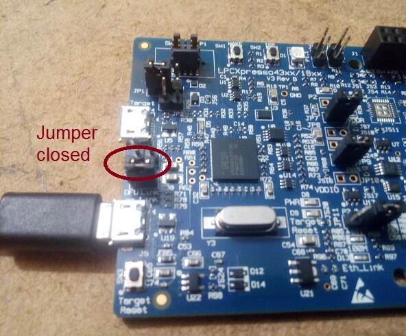

1) On the LPCXpresso board or Link2 make sure that the jumper beside the Link USB socket is closed. This jumper puts the Link into DFU mode and allows new firmware to be downloaded.
2) Connect the Link USB socket on the board to your computer.

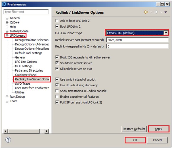

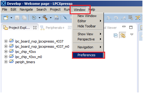

Open the LPCXpresso preferences page from the main menu bar
  Window -> Preferences
Locate the Redlink Options page by expanding the LPCXpresso item.

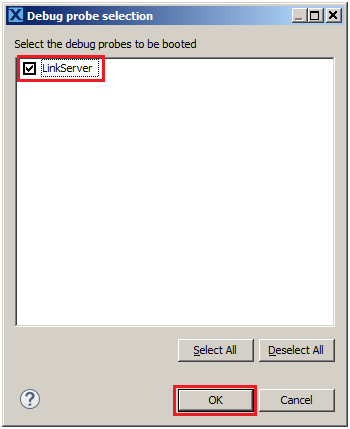

• Select “CMSIS-DAP (Default)” from the Redlink boot type options.

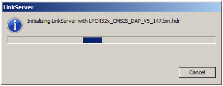

Download the firmware to the probe by pressing the Boot Debug Probe button

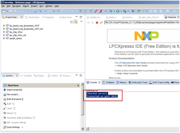

If there is a probe in DFU mode the following dialog box will appear.
It will initialise LinkServer with CMSIS DAP ~bin.hdr file as shown below:
Double check that the board is connected using the USB socket labeled Link (not Target) and that the jumper JP5 is closed, then power cycle the board and retry.
Note: the firmware must be re-downloaded every time the probe is power cycled.
This will be done automatically if you are using debugging with the LPCXpresso IDE Once the firmware is downloaded you can download your code to the target if it is not already in flash.

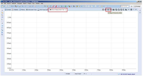

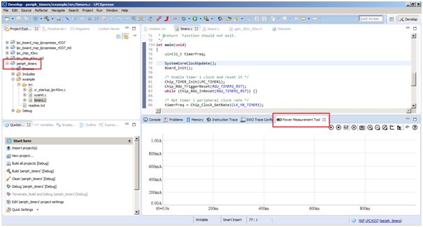

Click on Power measurement tool as shown below:
Note: i am using the Periph_timer project from my earlier blog Working on with LPCXpresso development board OM13088 with LPC4367 MCU

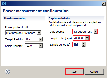

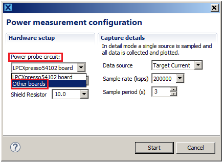

Now we need to configure the power probe, click on the configure icon as shown below:
Now select the option “other boards” for power probe circuit as shown as we are using LPC4367 dev board
Now select the Capture detail as shown below:

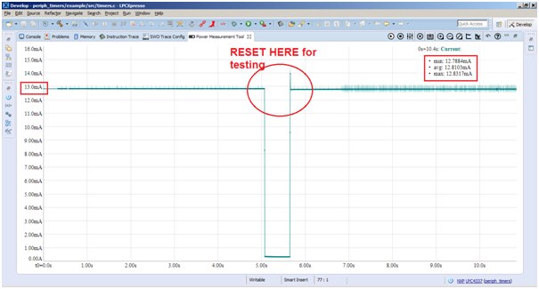

Data Source: Target Current (we are measuring current), 200KSPS and capture for 10 seconds
Then finally start the process by clicking 'start'

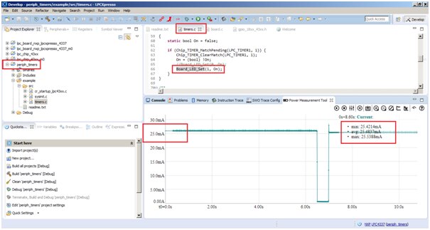

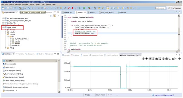

You can see the current consumption graph which shows 13mA
You can see the minimum, Maximum and average current consumption:

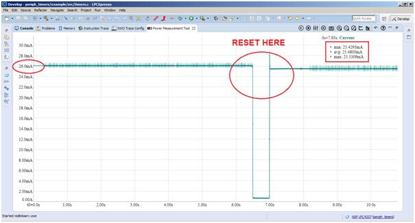

Now we will change the LED colour from blue to Green and the blink rate from 10 seconds to 1 seconds
Changing to Green LED and timer interval
Now let’s change this to blink at 1 Hz  i.e at interval of 1 sec
Change TICKRATE_HZ to 1 in timers.c
#define TICKRATE_HZ 1
And we will change instead of blue LED to green LED by changing
Board_LED_Set(0, On);  to Board_LED_Set(1, On); which is connected to Port-0, pin- 7 (defined in board.c)
Build the project again and execute the project
Reload the changed project to observe the change in current consumption:
Hence with the power measurement tool it has made easy to measure the current/voltage consumption of the project.
